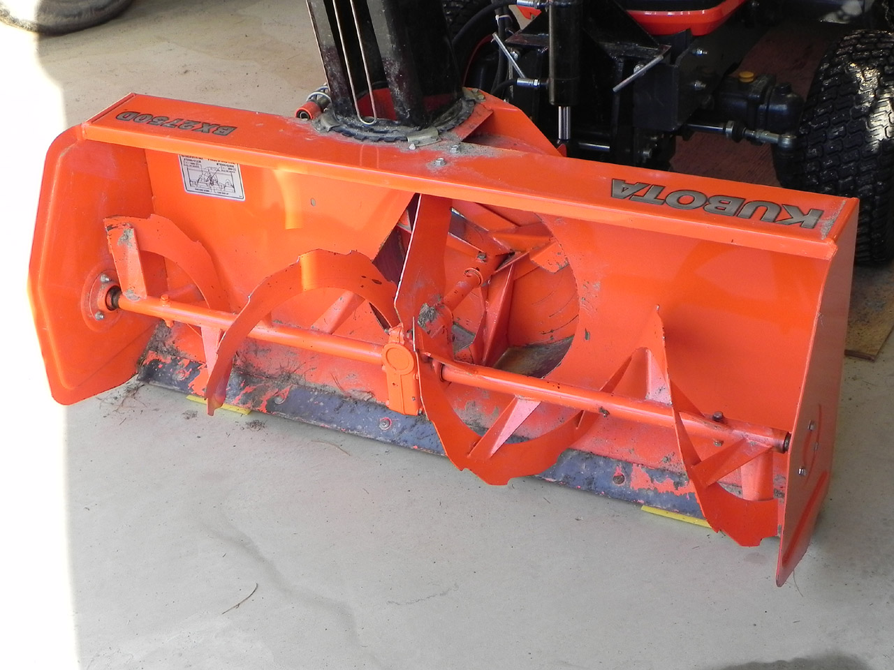

I have for a couple of years had a front snowblower for my bx2360. In the past my driveway was paved and even with the little spacers set to their highest setting it would scrape the pavement bare when I used it. Now I have a gravel driveway, and it slopes up quite a bit about 15 feet from the road (the most important area to blow because traction is tough on the slope). Of course when the blower is used I can't have it in float because it shoots a ridiculous amount of stones if I do and I have to constantly adjust the height to keep it a bit off the ground. This is a pain, especially on the sloping area and it makes the blower not work as well. I am sure if I just had a base of ice it would be OK but is there any way I can modify the blower so that it will glide on those spacers and keep the front edge raised up enough that it won't just dig in all the time?

Sounds like angle is more of an issue than skid shoe height?? Can you post a picture of the blower resting on the skid shoes so we can see the angle of it?

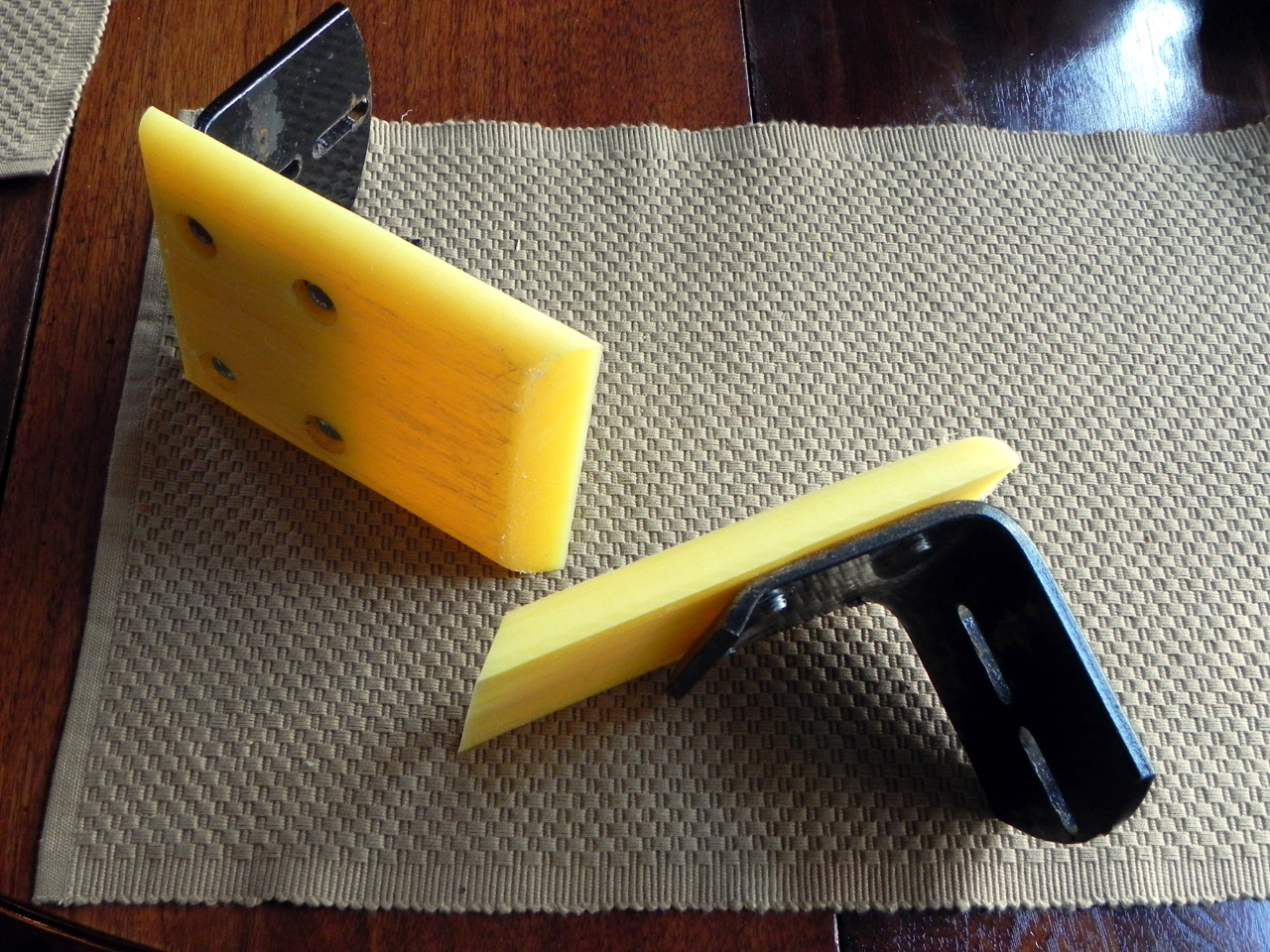

I had this same problem and sheared 6 bolts the first winter. The OEM skids are just inadequate, too small, so I wanted to make them bigger. I had some ultra high molecular weight polyethelene (UHMW) which works like wood (you can cut it, shape it, even drill and tap it) and I fit it to the skid bottoms with (4) 1/4-20 bolts each. I made the skids long enough to actually go under the cutting edge. These are 5/8" thick I believe, but I think 1/2" would work too. I started with them 1" thick and then made them thinner. Anyway, they work great and I might shear 1 bolt a year now and pick up very few rocks from my 3 gravel driveways blowing in the float position.
Skids mounted.
