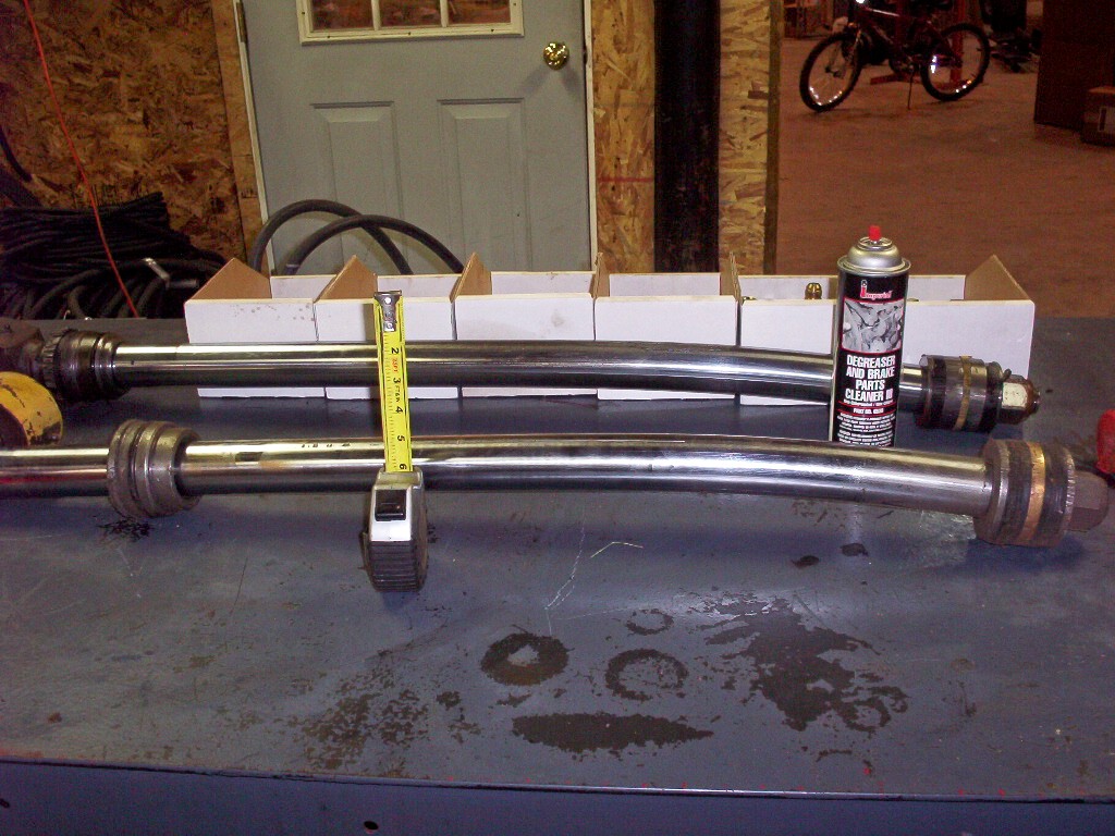

Rod bending on a back-hoe cylinder is much more common than you may think. I've got 2 cylinders right now off of back-hoes with bent rods. The brod is the weak point on a back-hoe, believe it or not. Here are 2 rods, one is 2" the other 2.5", both pretzels now.
