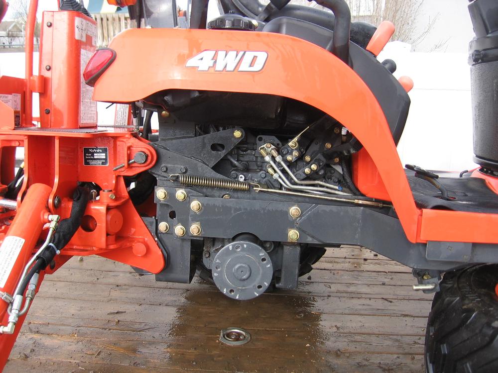

Yesterday, I was BBing a horse pasture that had plenty of rocks in it. It was a pretty rough job, with lots of jolts as the teeth would hit a rock and pull it out of the ground. After I got done, while loading the tractor on the trailer, I noticed that the brake pedal felt odd.
Normally, the pedal increases in resistance the farther you push it in, now it just goes right to the bottom of the stroke and bottoms out. The parking brake still holds it in place, but it sets all the way to the last notch on the parking brake set. I inspected the linkage, and everything seems to be in place right back to where it goes into the rear end. No oil anywhere. Anybody had anything remotely like this happen?
My warranty ends in May...
/ BX24 Braking woes
#2

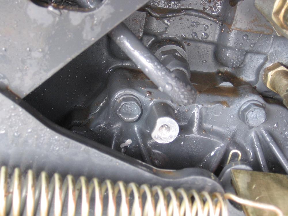

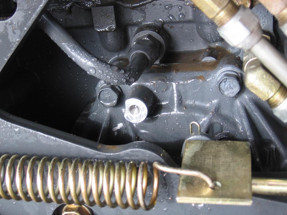

After a quick pressure washing, things are a bit cleaner, the only thing I can see is in the second and third photos, the silver area with the threads in it. Before washing, the internal threads were pretty clean, as if there was something screwed into it until recently. Any of you BX owners have access to look at their tracotr to see? Thanks.

The PDF parts list doesn't show anything to do with the brake in that area that isn't accounted for on my tractor...

Here are some pictures of my not-so-clean tractor. Hopefully these are helpful. (edit: I added one more at the end that I think shows that you aren't missing anything there)

I inspected the linkage, and everything seems to be in place right back to where it goes into the rear end. ...
Are you sure the adjustment sleeve did not loosen up and move???
/ BX24 Braking woes
Everything looks like it's been the way it is for awhile. I took it to my local stealer to have them take a look. I will post up what they find when I find out. It happened real suddenly, one minute I had fine pedal pressure, and the next the pedal went to the bottom.

Service manager called today with the lowdown. The brake pads/disks whatever they are were toast. He said that they had gotten so hot that they turns blue. This had to be from being maladjusted, as I hardly ever use the brakes. It was probably dragging like a partially set parking brake the entire time. I have to pay for the new brakes, about 75 bucks. The labor will be warranted.
Now get this, he said that my front hubs were leaking. Kubota sent out a memo to their service departments to pull any front ends with leaking hubs and install a brand new one-the entire front axle!!
I guess they want the entire assembly returned to them so they can troubleshoot it while it's still intact. So I get a brand new front end, brakes, and new tach/hour meter for $75. Not bad.
