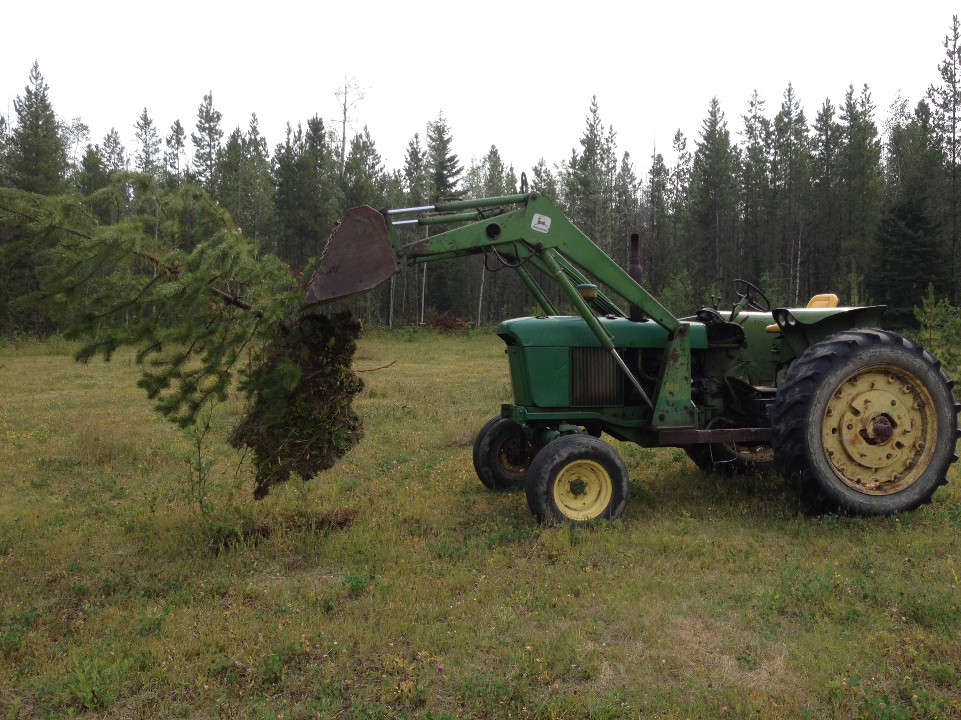

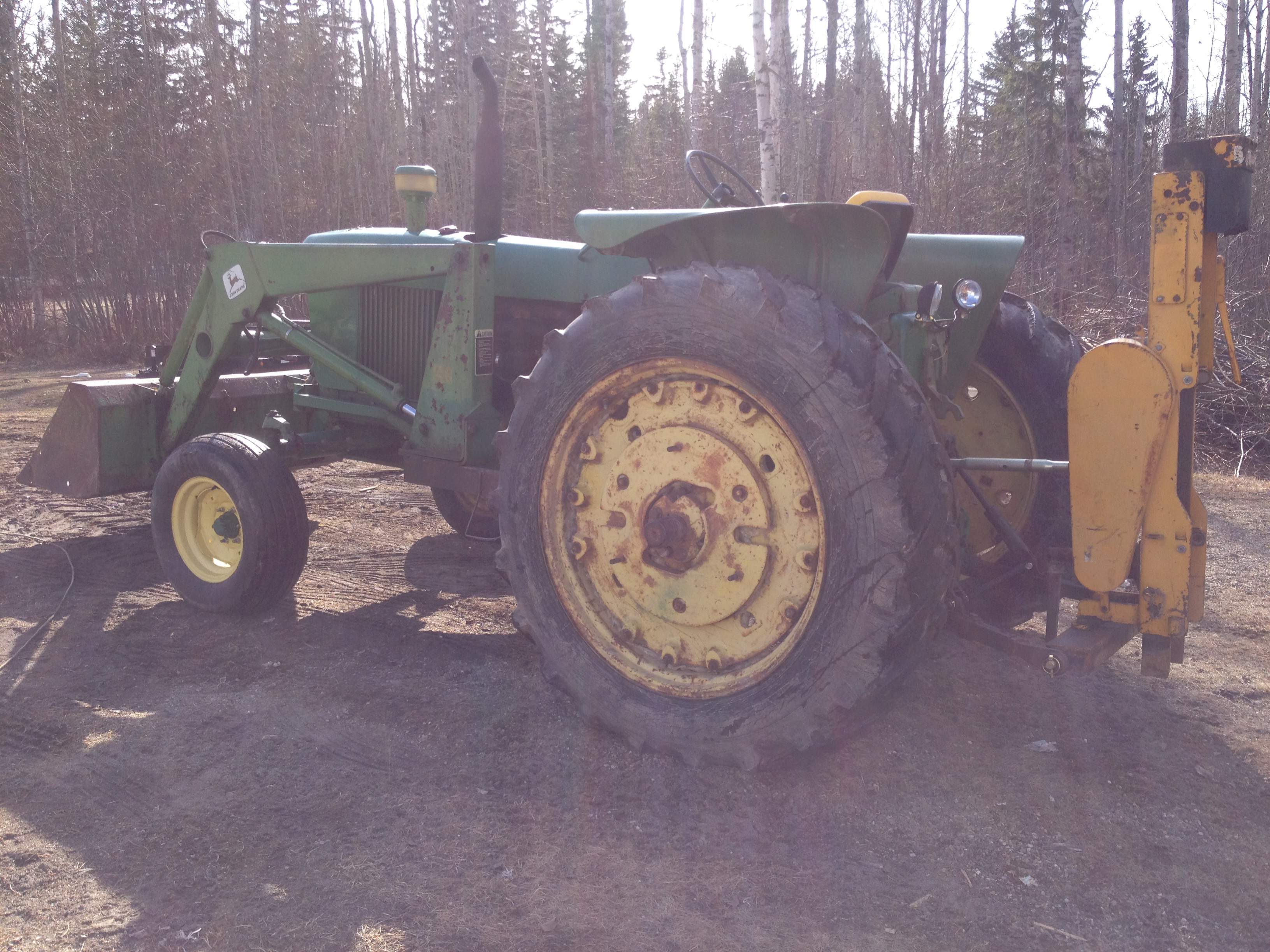

Looks like I may be getting a BX25. I have quite the to do list for it already. Wondering how capable it will be of a few things on the list.
I'm looking to get a 4 foot rotary mower for it mainly for clearing trails and fence lines of willows. How well will they work together?
Also I would like to run my Danuser MD-6 post pounder with it and would like to upgrade to a hydraulic top link. Would it handle the pounder well and is it set up for hydraulic top link?
Last I am wondering if the tires are able to be ballasted and if they are big enough to even worry about ballasting? I want to use it for pulling out small pine trees from a few clearings. IMG_4419.jpgIMG_3739.jpgThanks

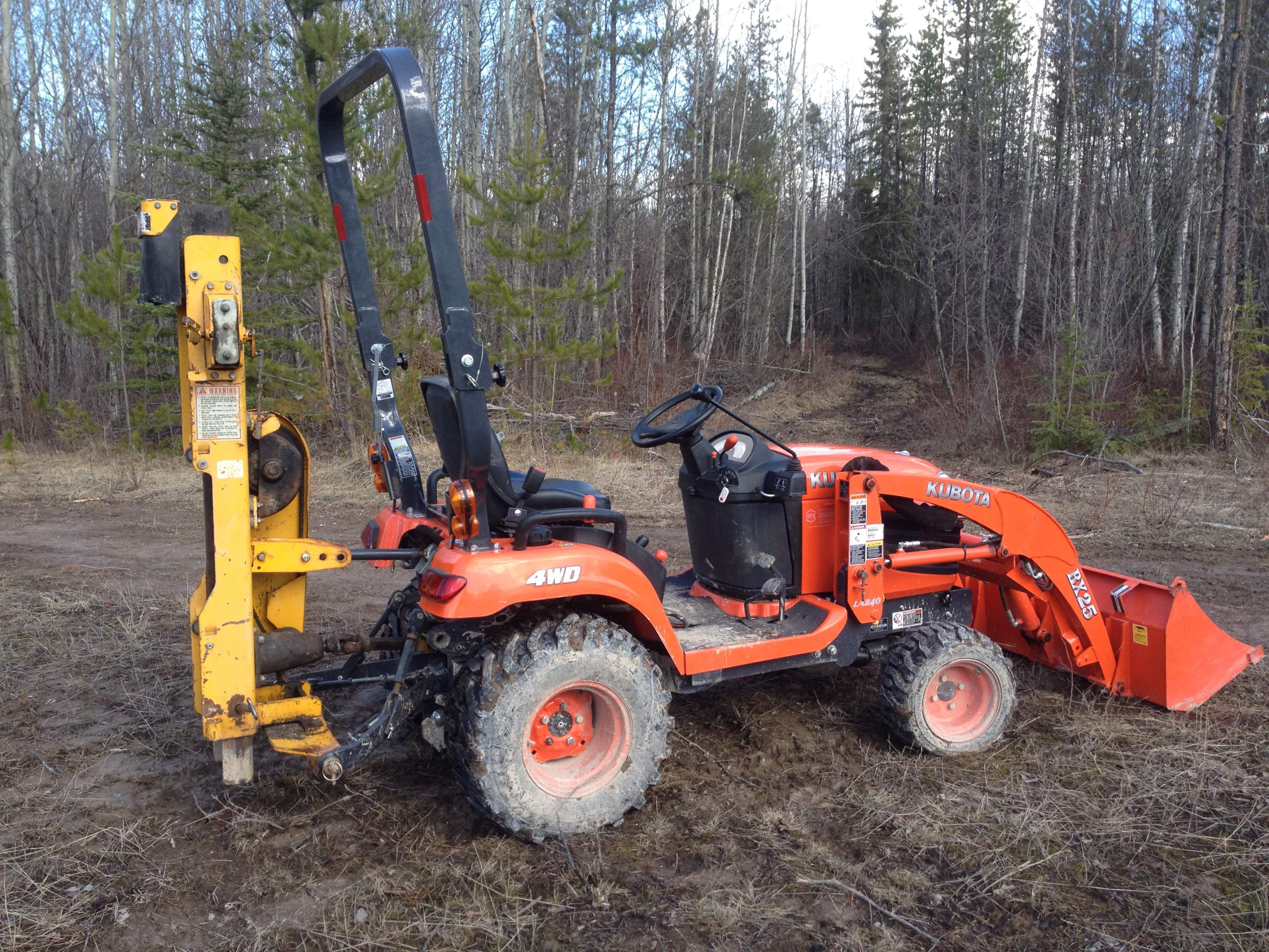

Well guys, I did it! I had the tractor on a extended test drive, pounded about 100 posts, dug some trench for my new chicken fence, did a lot of harrowing, and of course all the odds and ends around the farm. This tractor is awesome! Little upset I never had the time to try the tiller and snowblower. Unfortunately it wasn't quite the right fit for the price tag on it.aMG_5713.jpg

I think this is the first picture I've seen of a BX with post pounder... 100 posts in so it must have worked ok

How about more information on your post pounder, your soil and moisture when installing posts, and specifics on the posts you installed?

Well guys, I did it! I had the tractor on a extended test drive, pounded about 100 posts, dug some trench for my new chicken fence, did a lot of harrowing, and of course all the odds and ends around the farm. This tractor is awesome! Little upset I never had the time to try the tiller and snowblower. Unfortunately it wasn't quite the right fit for the price tag on it.View attachment 430167
Good for you ! Glad it works and you didn't get side tracked by a few naysayers about the cooling fan......it is a simple fix if you use yours in the bush , just hang a cut piece of plywood from the frame with some plumbing strap and you will be able to protect that plastic fan ........... the BX is a mini brute ! I made ATV trails thru my bush with my BX2660 (no backhoe just the FEL) and worked great.

I would love to see the size post this thing can pound. Any shots of your fence. I just remember the guy that put in my fence and he had a monster tractor and it was dancing around some.
Glad it has worked out well. Enjoy your little beast.

Post pounder is a Danuser MD-6. It uses pto to turn a rubber wheel. Use a lever to push wheel against the weight to lift it up. Lever uses brake pads to hold it up and release both pads and wheel to let it drop. Comes down with gravity alone so hitting power doesn't change with size of tractor. Ground is all clay soft to medium spring conditions
