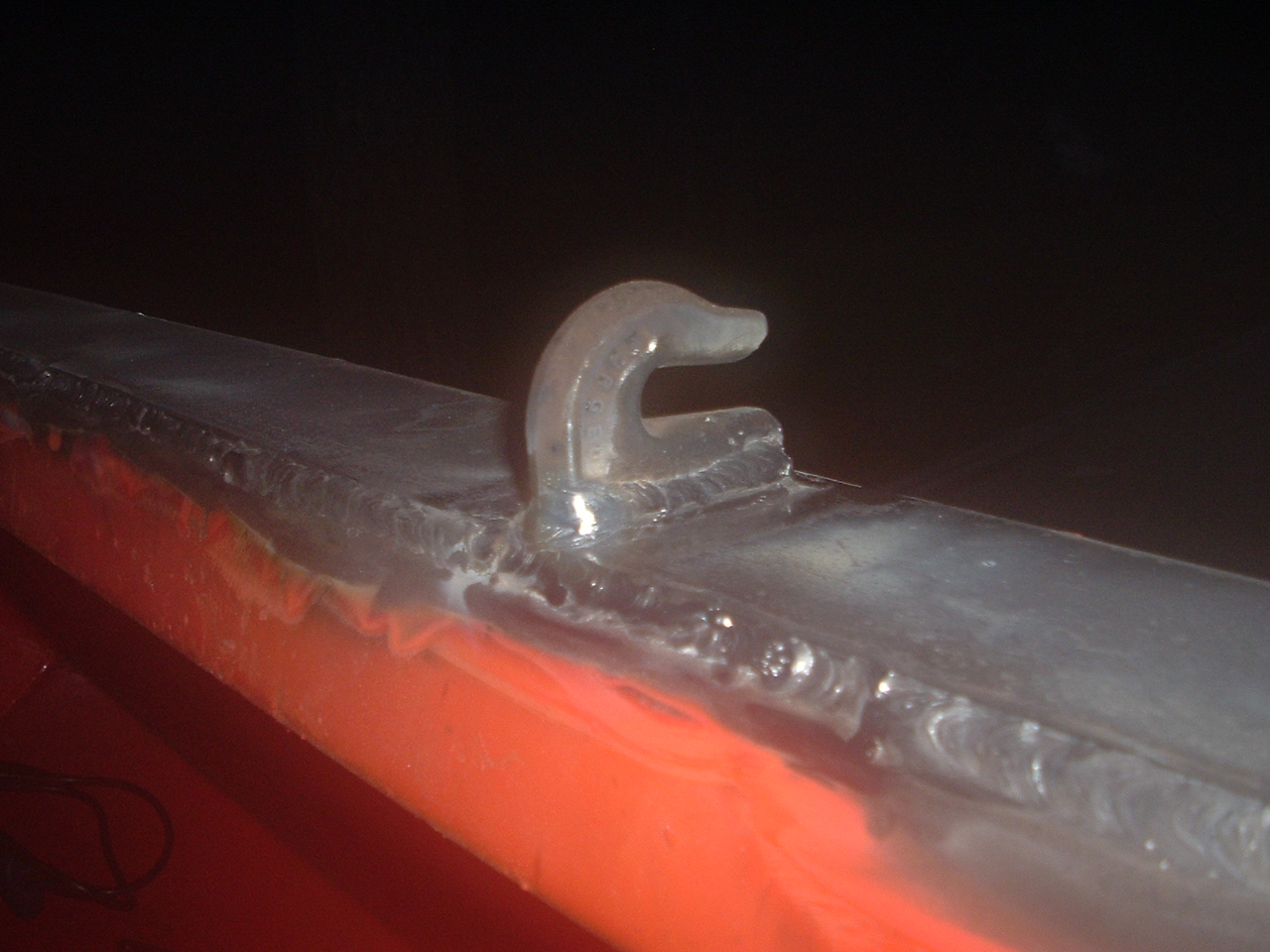

Are you gonna weld some grab hooks onto it before you paint it?
Dude...I am so vasalating back and forth and up and down about hooks / whatnot. I have not made up my mind if I am going w/ chain hooks or D-Rings or Solid Rings....oh man...I gotta go or get off the pot on that decision... any input for me to help sway my mind anyone? Seen any off the hook cool ideas implemented anywhere?
There are some real valid arguements regrading D-Rings over hooks and vice versa...

Here ya go K0ua :laughing:
Let the masses rip me a new one! (But they ain't gonna fail anytime soon. :D )

A bird pooped on your angle iron:laughing::laughing:
Just joking:)
By all means weld 2 hooks on there while your at it. Place them inline with your loader arms. You'll be glad you did.

Yep, 2 5/16 weld on grab hooks, are what you need with the opening pointing towards the tractor.. Like this.
James K0UA

I use grab hooks on mine and usually put a slip hook on the middle just to take up slack chain. And welding 1 on backwards never hurts either, I keep saying I am going to weld them both ways on my buckets but at last guess I had like 15 buckets so someday that's a lot of hooks and a lot of welding.
Welding needs more practice, looks like you are hurrying it along too much, good penetration though. Practice on the flat welds if you can, vary your hand speed moving along until you have a nice smooth weld. And stitch to reduce warping,,, reduce not eliminate.
