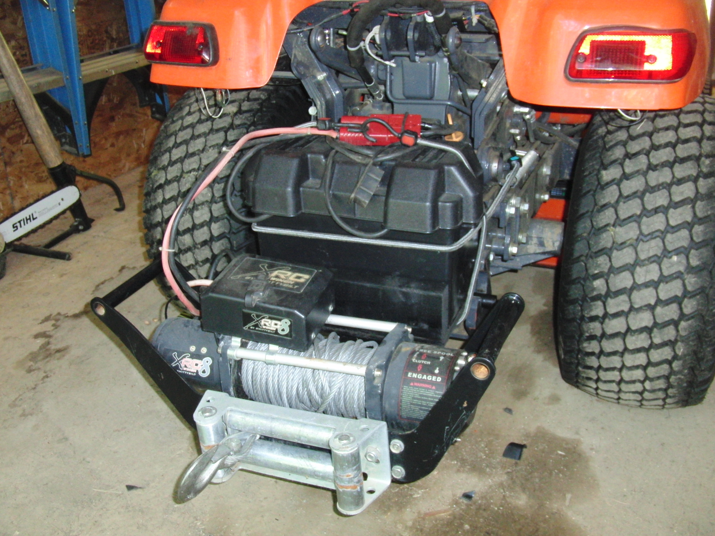

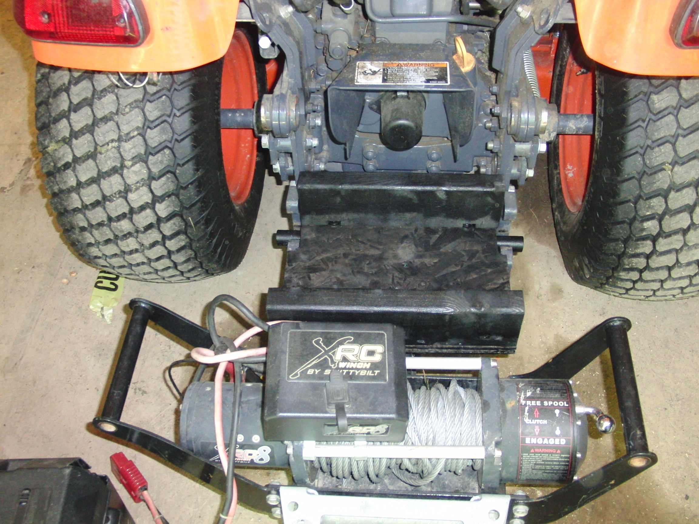

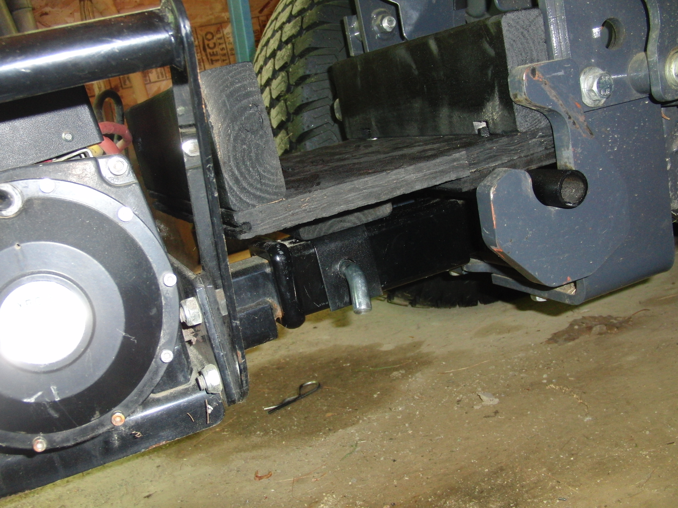

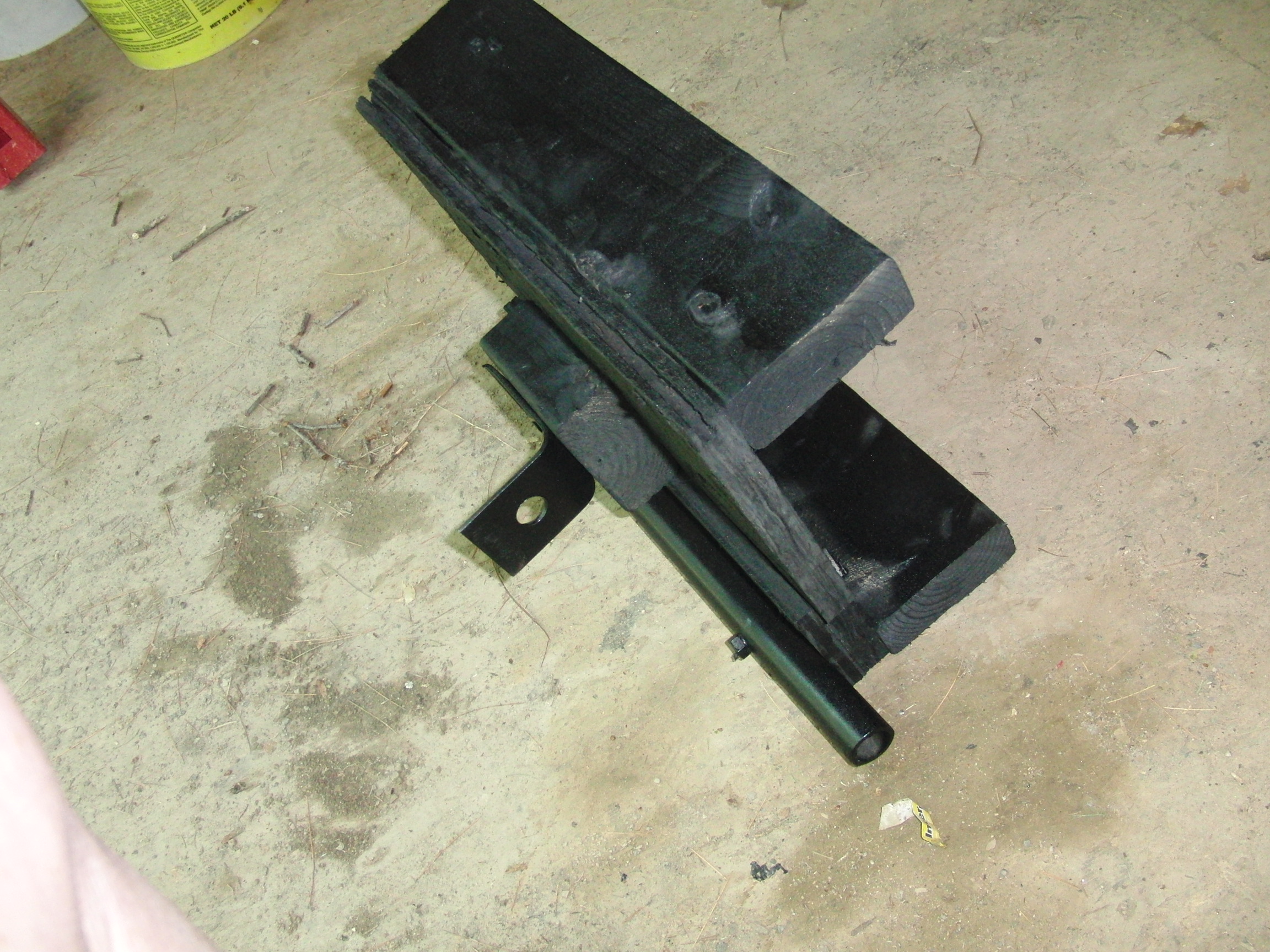

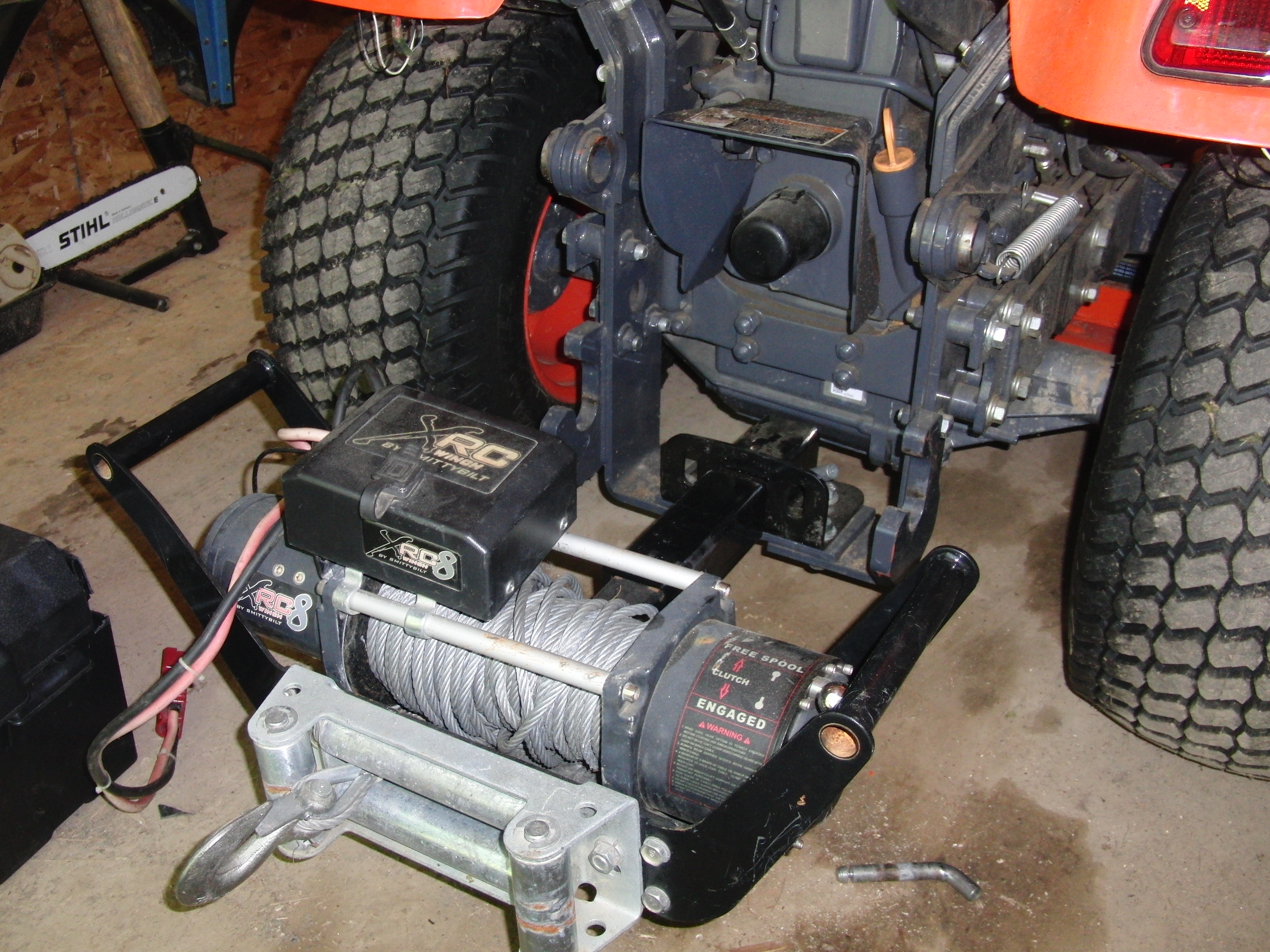

Here's my winch solution. I use it to pull logs/trees out of places I can't get close to.
First I put a Reese mount on the draw bar, and added an 8" extension to it.
Then I made a box to hold my deep cycle battery.
Add the battery and I've got a system independent of the tractors electrical.
:thumbsup:

Well one "advantage" of this mount on the BX is that the BX is light enough that, IF I'm not hitched straight on, it straightens itself out pretty quick! ;) I use my grapple on the front to either dig into the ground as an anchor or if it's too hard, then I chain the grapple to a tree. I also use a 5 ton snach block if I need to change the direction of the pull.:thumbsup:

Yes, the BX is not set up to run a winch off it's system so I just put the battery on a trickle charger when not in use. It's a monster battery (250 AH I think) that we used as a backup on a Amateur Radio Emergency Repeater.:)
I use #2 cables for the winch, and even then if you pull too long they get hot!:eek: That's an 4 ton winch on there.
