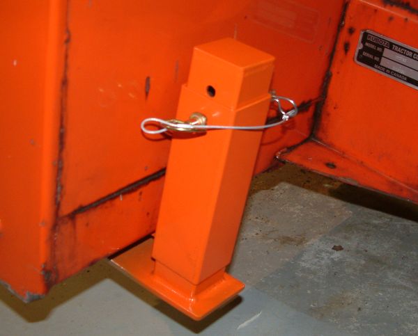

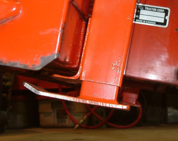

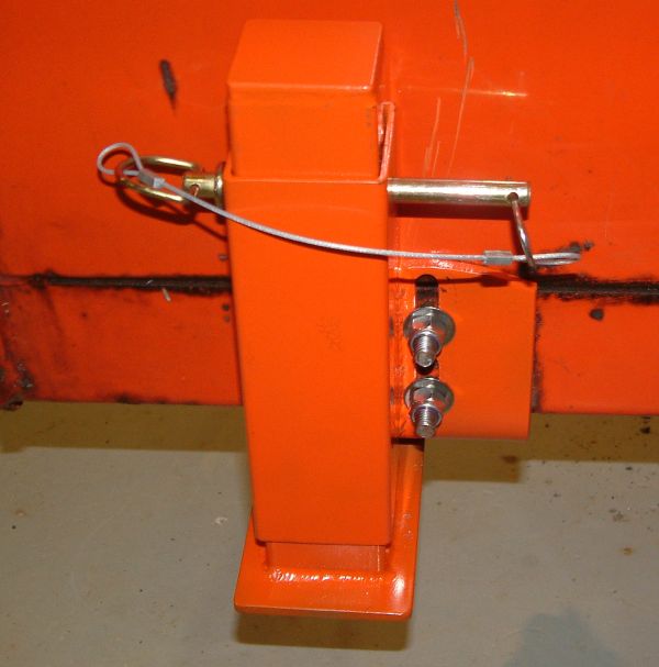

Attached are some pics of the snowblower skid "upgrade" I made. I have various different surfaces I have to remove snow from, so various skid heights are needed. Obviously getting out of the tractor with tools in the snow is not an ideal solution. So I welded up these adjustable skids and welded them to the OEM skids. Uprights are slip-fit (nestable tubing), actual skids are stainless steel TIG brazed to the mild steel legs. I changed the mounting bolts from the wimpy OEM 5/16" to some SS 3/8" carriage bolts. Minor Dremel work was required on the OEM skids and the body of the blower to fit the larger bolts. I also had to cut off the upturned "lip" of the OEM skid so the new setup would slid up far enough and allow the scraper bar to touch down.
A note to those using their 2750 in a salty environment....might want to keep a coating of oil on the inside of the hollow, triangular lower section. There was a very disappointing amount of large rust scale inside, and I found one area where it was rusting through to the auger area. There are some drain holes in the bottom of this section, but perhaps a few more holes drilled through from the outside would allow the misting of oil into this area on a regular basis. Less than ideal design to leave a hollow area where water/salt can find entry.
JohnnyB

. There was a very disappointing amount of large rust scale inside, and I found one area where it was rusting through to the auger area. JohnnyB
Very nice modification! Are you seeing the rust from the holes that the carriage bolts fit into to hold the feet? I've never taken the skids off to look in there after I adjusted them when the blower was new. How old is your 2750? Dyer, retired
