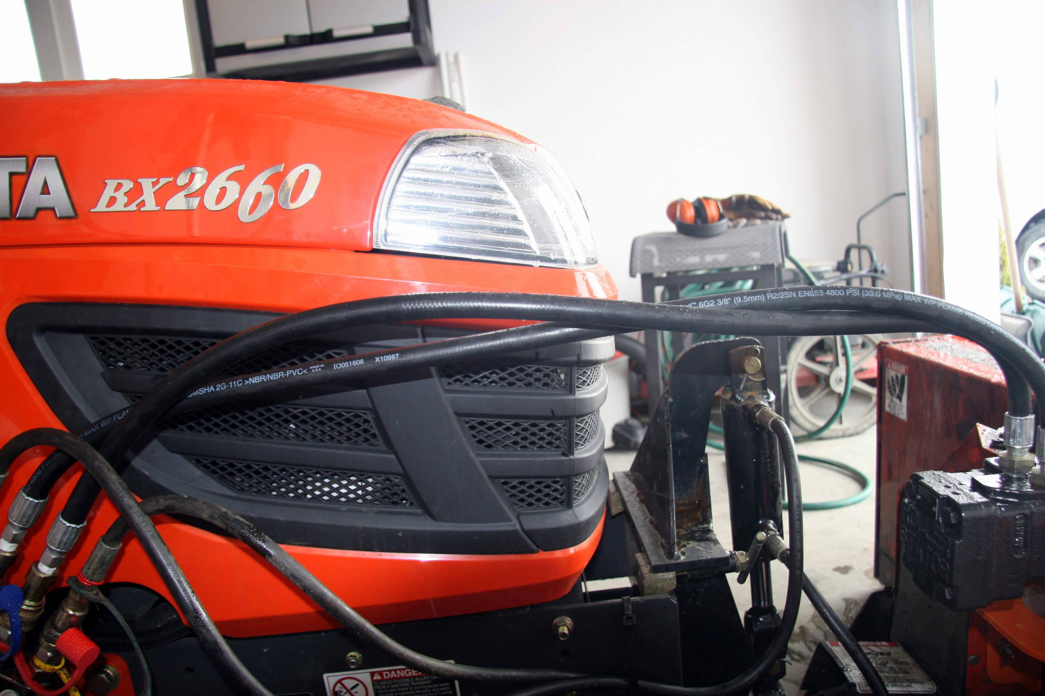

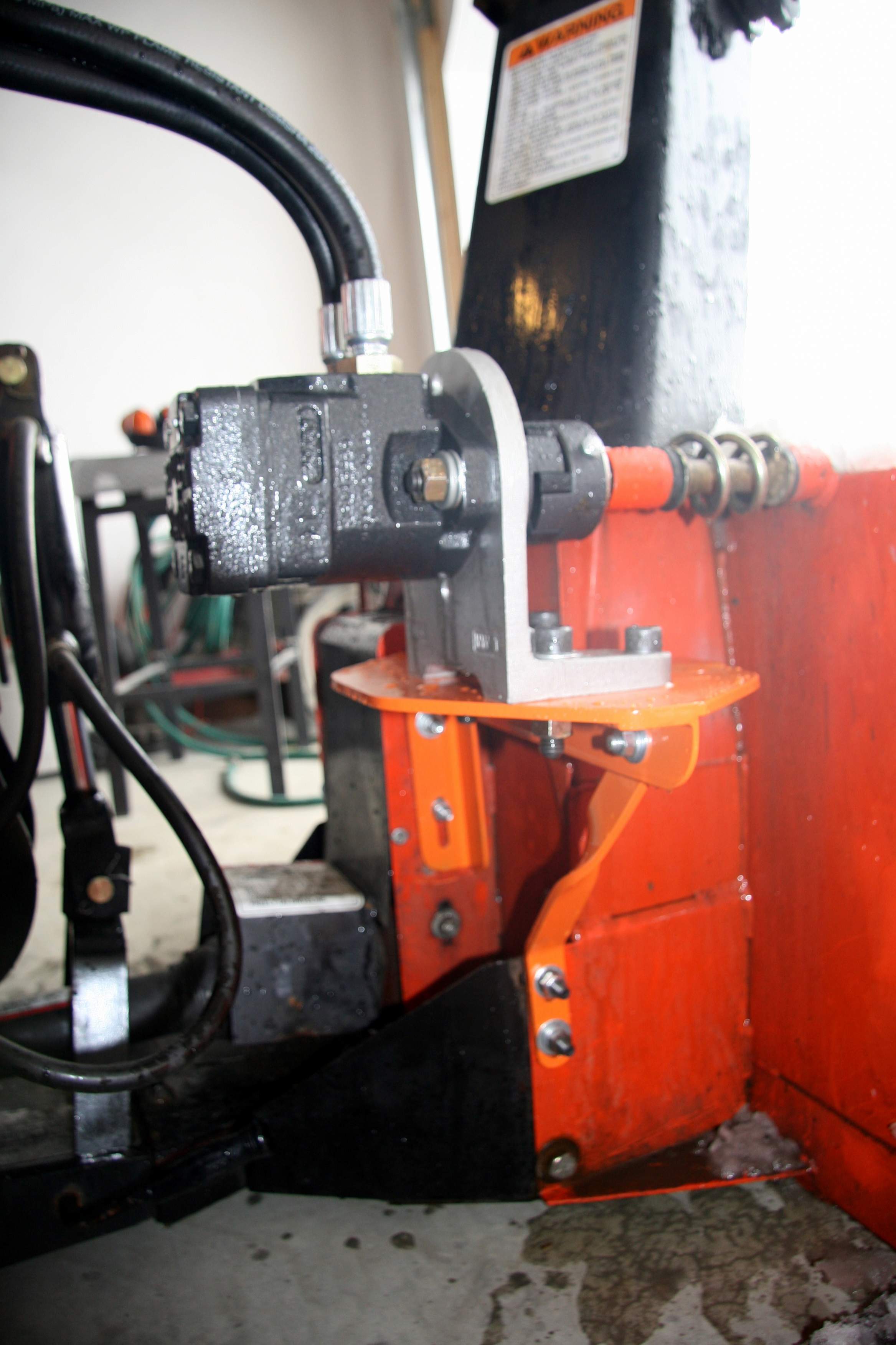

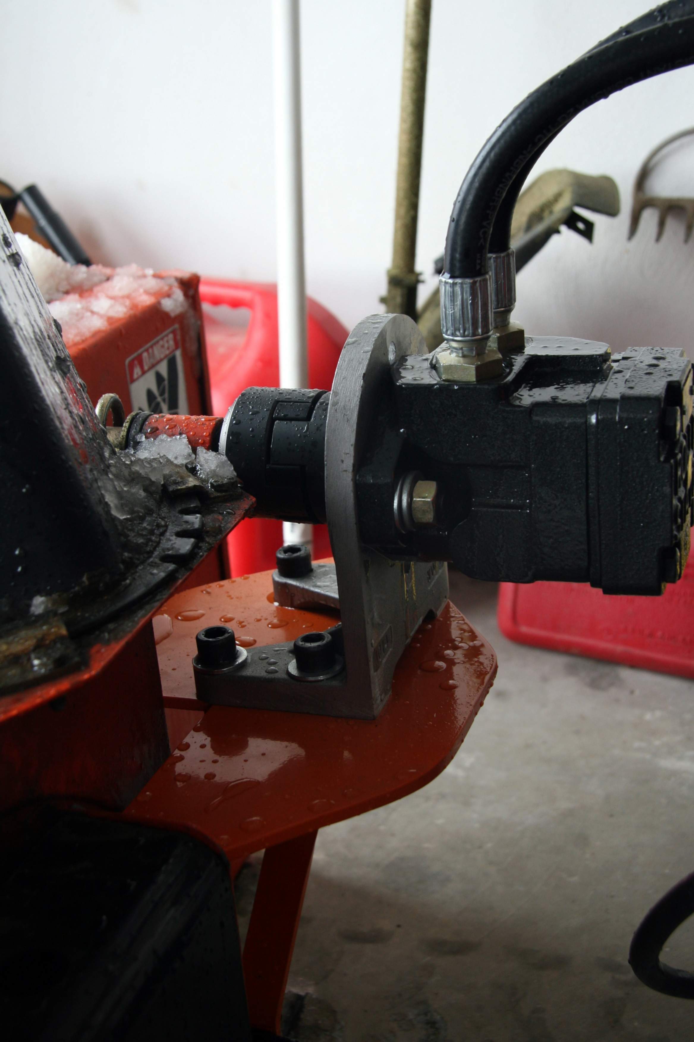

Well, the orange isn't close to Kubota orange but it'll do (a little grease and dirt and it will blend right in.) The setup works like a charm. I had about 4 inches of snow and slush to give it an immediate tryout. Did my neighbor's driveway too.
The hydraulic hoses cost me about $100. I should have asked the guy how much before I said to make them. They are high quality and no adapters required. I played it too tight on the length. They work -- but they just make it with but a little play to spare. No problem lifting the blower because it tilts it back and gives me more slack. I "ballparked" the length while the blower was at my son's shop. Stupid of me, but I lucked out.
I used a soft aluminum screw to connect the worm gear. The hope is that if I go too far rotating the chute that the screw will break before the worm gear does. I'm thinking I may remove the chute and cut more notches so the chute can do a full 360 so I'd get a wake up call if I rotated too far, but no breakage.
Here's some pics -- and thanks for all the help!:)

Huck,
Excellent looking setup and I especially like the motor mount! It's compact, strong, and looks like a factory installation. As I said before, it sure shows when a good machinist gets working on something. The paint is close enough and the powder coat job looks professional.
I probably mentioned that I cut notches in the chute base all the way around, so I can turn the chute through 360 degrees. I will never turn the chute all the way through 360 degrees, but figured if I hadn't cut the slots all the way around, I would eventually hit the stop and tear the worm out...Murphy's law and all. I read other threads where guys have ripped the worm gear apart doing that and the motor never hesitated, so I thought notching the base was the quickest and easiest answer. If I had it to do over again, I'd have the machine shop do the notching....mine works fine, but I wouldn't enter it in any beauty contest.
It looks like your hoses will be fine as they are and if you got nervous about it, adding two 45 degree adapters to feed the hoses straight back would free up an extra couple of inches for you. I didn't remember the hoses being expensive, but the quick connects price was surprising.
It sounds like you aren't experiencing any trouble with the stick movement? When you push to the right, the chute turns right....you can feather it, etc.?
I'm very impressed and think you'll like it much more than the old hand crank setup you had. Congratulations! John

Huck-
Very clean setup .... doesn't that PYO about not getting the hose length perfect!
Given the look of strain on the hoses near the quick couplers, I would consider threading in some right angle adapters coming out of the hydraulic motor. I bet you would end up with 3 or 4 more "effective" inches of length on the hoses and I would be willing to bet several more years of life from them.

Paul,
First of all, I love your avatar. It reminds me of my granddaughter. Beautiful little girl.
Yes, it does PMO that I didn't add 6" to the length of the hoses. I was thinking that I didn't want the hoses drooping down on the tires (like the quick hitch hydraulics can do if you don't tie them up on the frame.) I played it too close.
The guy that did the hoses forgot the dust caps for the quick connects so I'm heading down there today to pick them up. I'll ask him about the right angle adapters.
