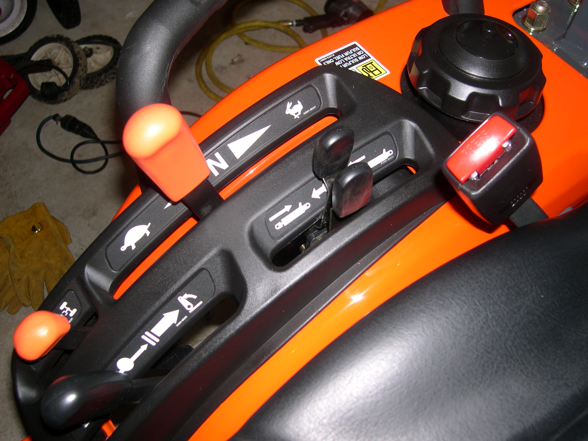

My only other issue is the levers are a very tight fit and rub a little on the plastic lever guides. In a perfect world, I'd disconnect them, do a little bending on the vise and reinstall. I'm gonna try leaving them as is for now and see how much the rubbing annoys me. All in all a nice kit - just not a lot of room for wrenching all the connections.

My levers were tight to and rubbed the sides of the fender console. I made some guides out of delron and pop rivet to the sides of the levers. This kept it from rubbing so bad and wearing out the plastic sides. The slick delron slides a lot smoother than the steal arms. I thought I took some pics. but I wasn't able to find them if I do I will post them. Can't wait to see your pictures of your install CHDinCT.

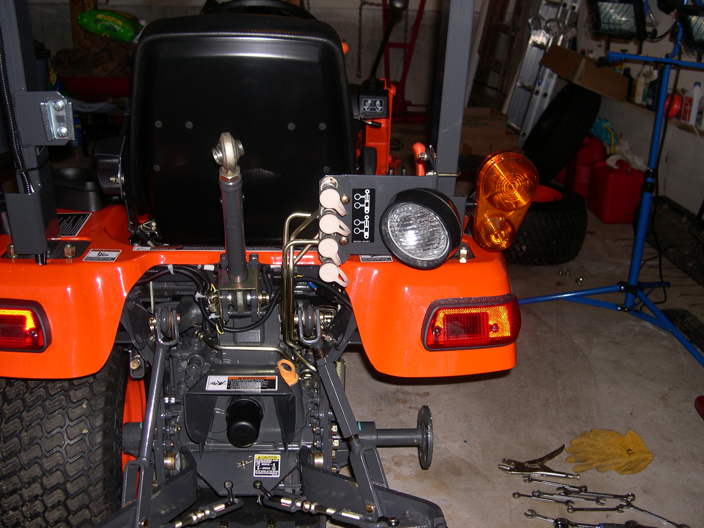

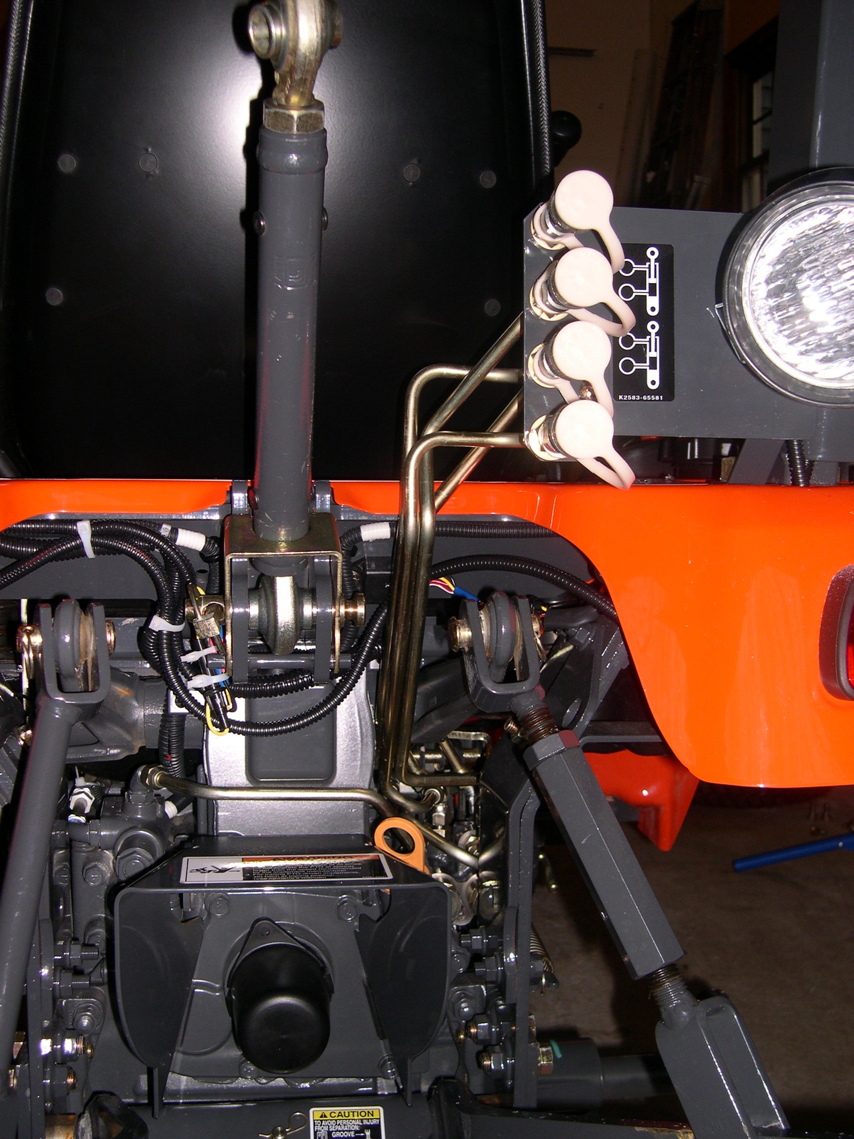

Here are some pic's of the install. I'm working on parts I'll need for a hydraulic top link but I'm also going to get a quote from CCM too, then decide which way to go. My current top link is 14" closed and 21" fully extended. I plan to hook up my rear blade and rake to get a sense of the max tilts with the current TL, but from memory I think I can use a shorter TL at times. I can't rotate the blade or rake 180* without hitting the 3PH linkage unless the TL is fully retracted and even then it's close, so maybe an inch shorter would be helpful - we'll see. Actionaj, what size TL did you end up getting if you don't mind me asking?

CHDinCT, Nice job on the install, this kit is one slick set up. My CCM top link is 14.5" retracted and 20.5 extended works well with all my attachments.
