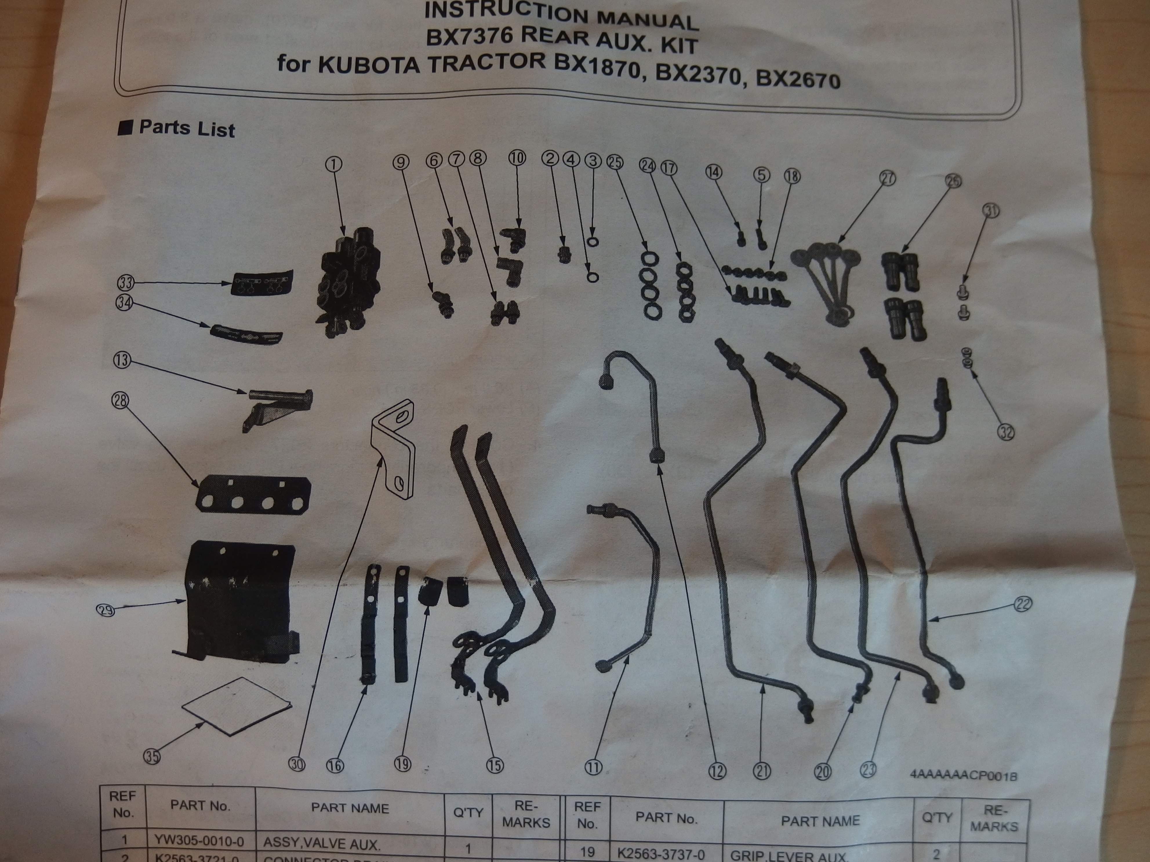

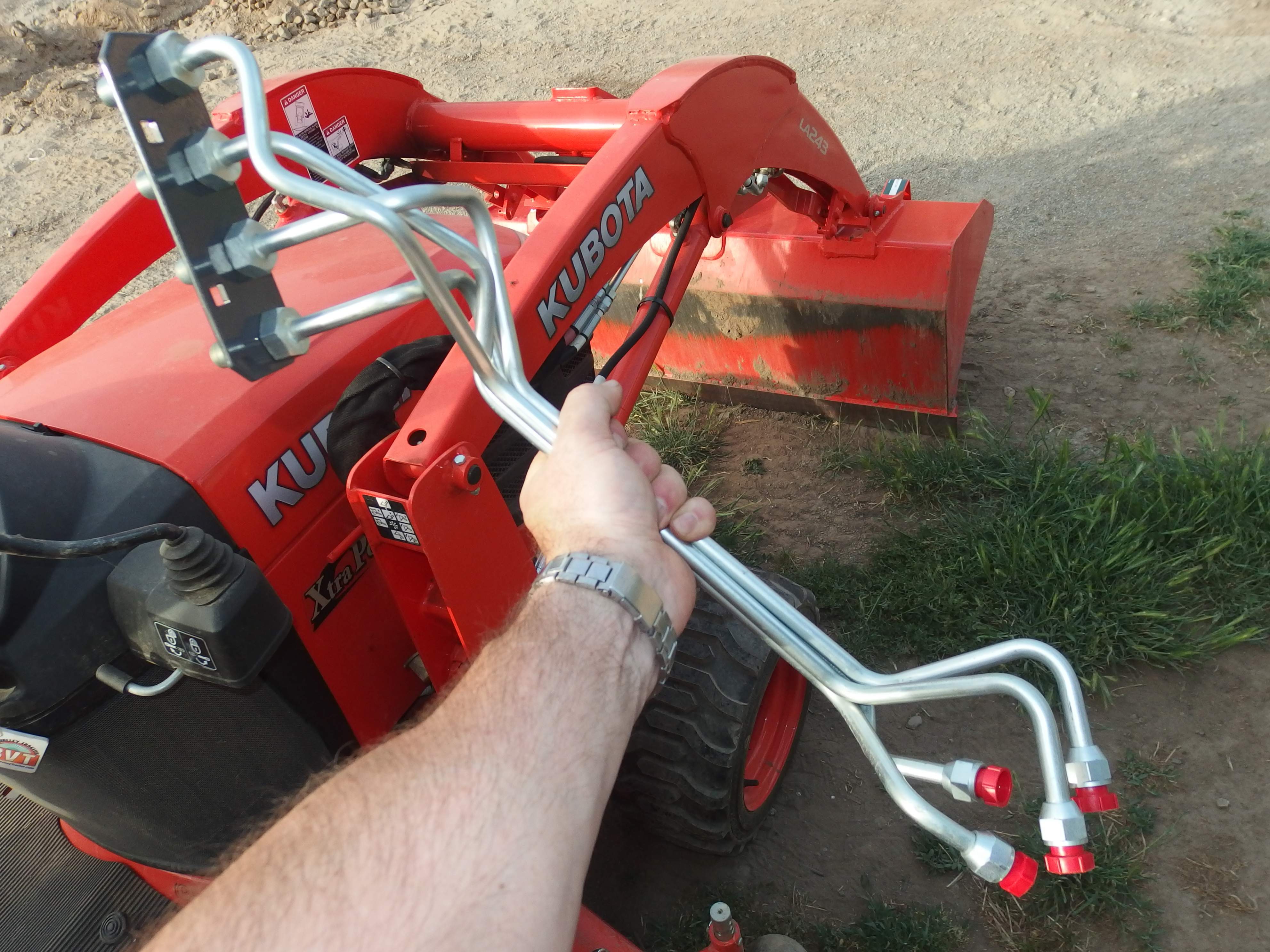

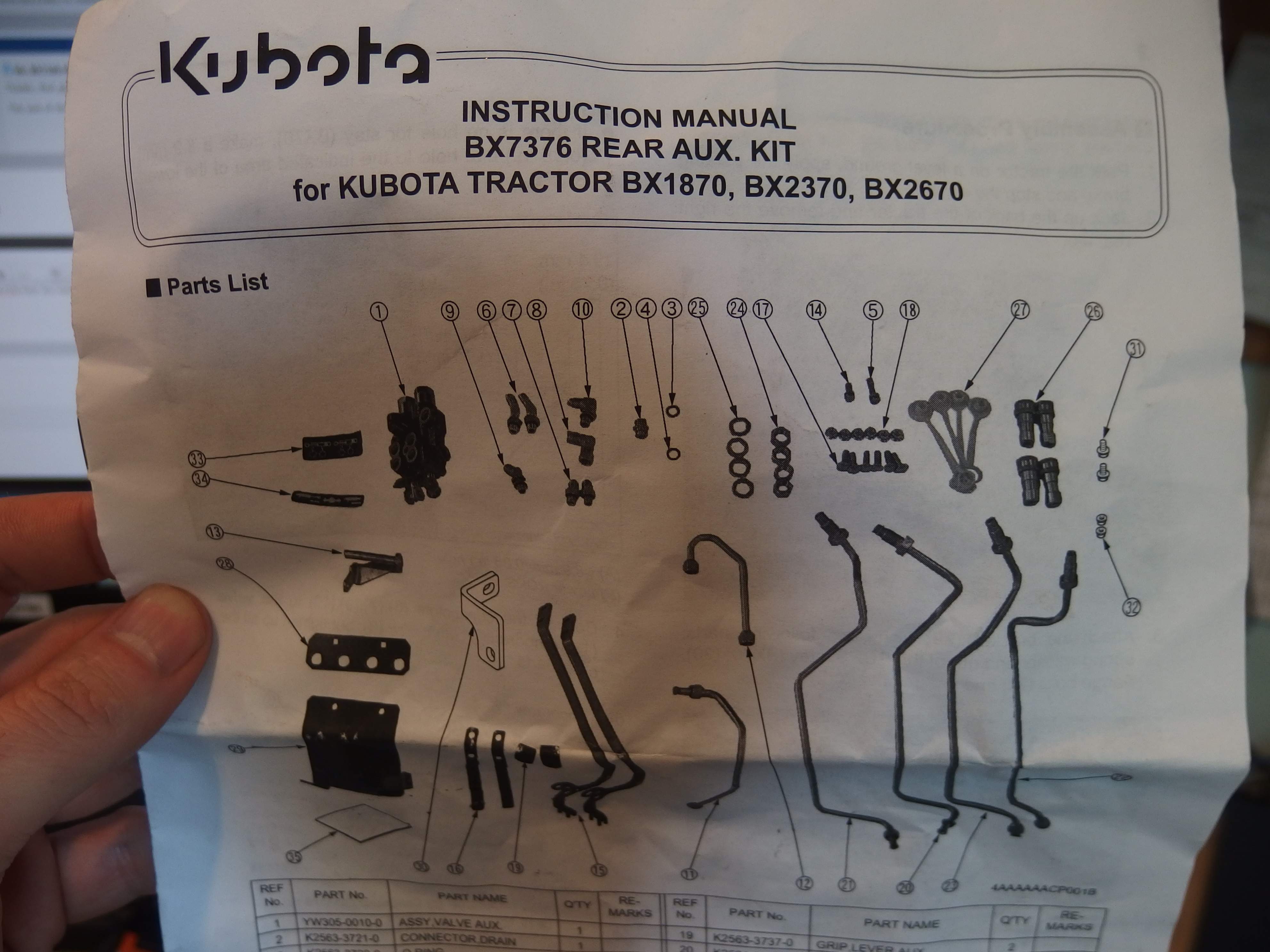

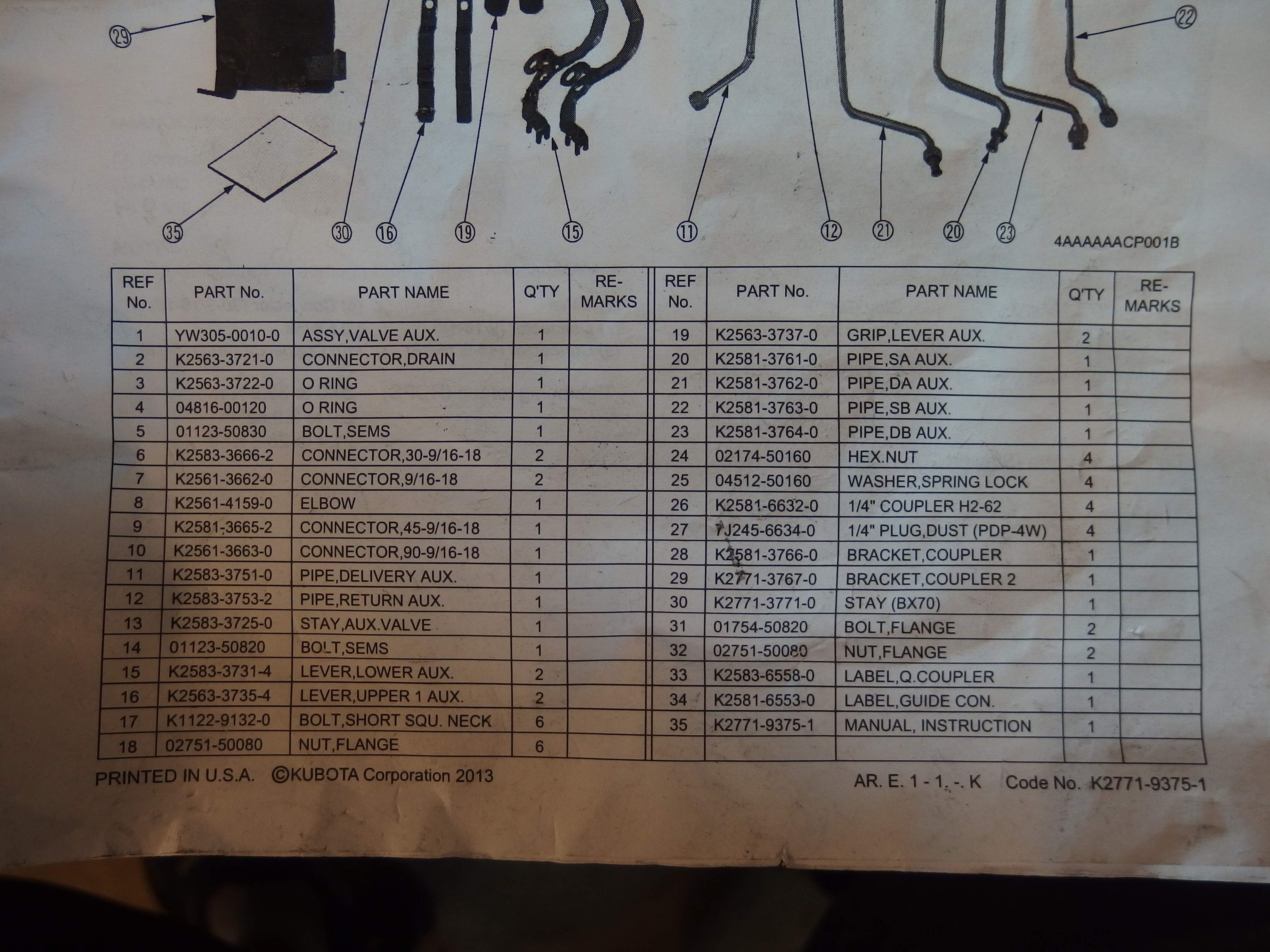

I just bought a BX7376 Rear Aux Hydraulic Kit for my BX from Messick's over the phone, priced at $440. Pictures of the install instruction cover page are attached, and you'll see that it is designed for BX1870, BX2370, and BX2670. Not sure how BXnn70 Tractors differ, and need a different kit, but this one is designed for us. I'll also post a picture of the parts in the box.

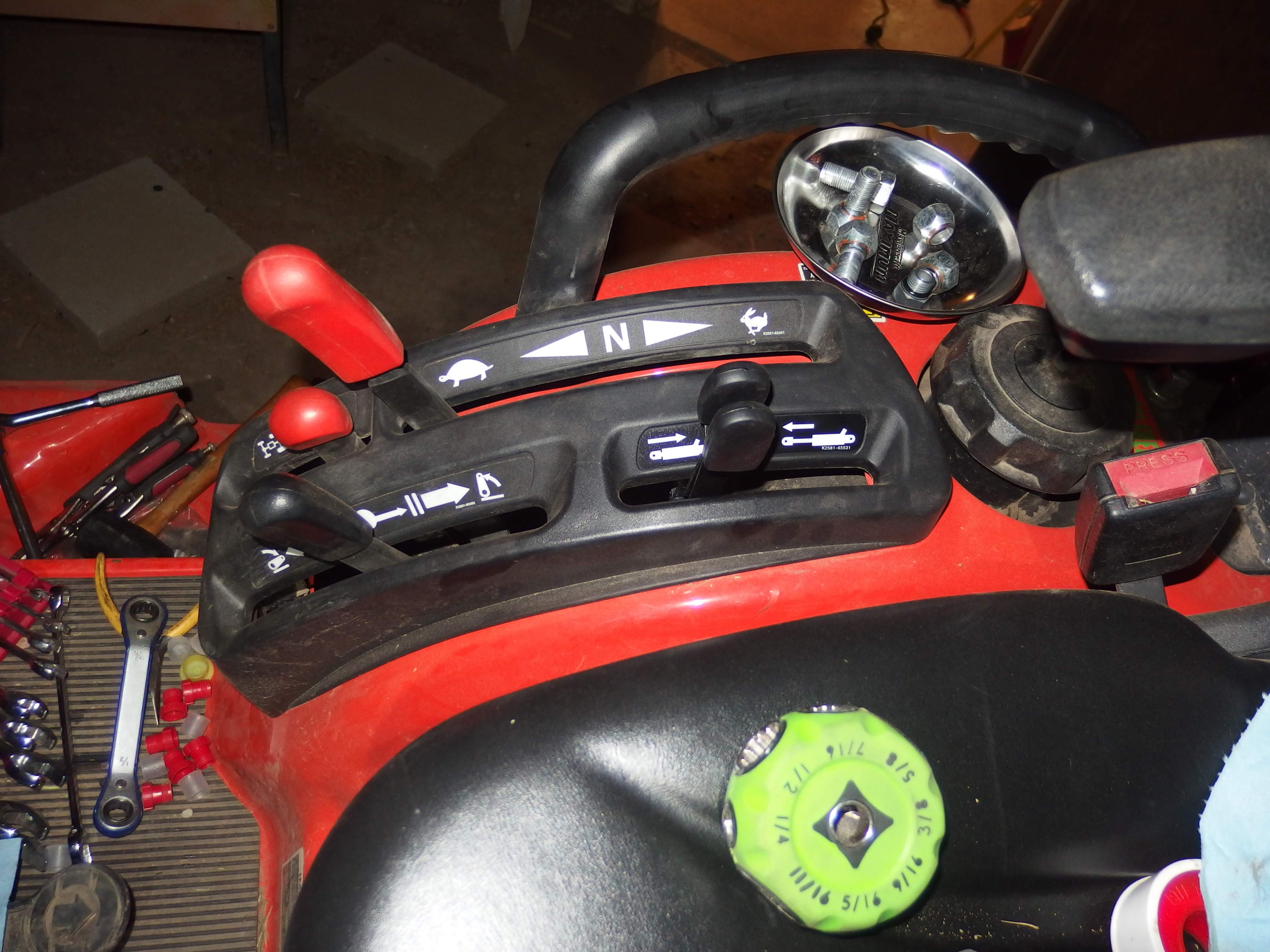

It clearly is a sleek OEM install for two hydraulic circuits, with a mount to the right ROPS and four 1/4" quick-connect couplers (H2-62 part number K2581-6632-0). It comes with two levers that fit in an unused slot next to my PTO lever, and include the labels that fit on that slot. Very OEM look. The install manual looks very straightforward and is complete and well-written. Why couldn't I find the manual when I was shopping? The manual is: Code No. K2771-9375-1, but even with that manual number, I can't find it online.
Hope that helps some of you. Now, the rest of the story...
The purchase was very odd, and seemed like a secret spy transaction. As everyone has noticed, no info is available online, nor in any other source I could find. The kit is NOT a Kubota part, but rather a "whole good", or a standalone product of its own. That makes no sense, since it is quite obviously a part and serves no purpose on its own. Messicks could not give me any information from their site, nor when I called them. I asked questions like "What components are included in the kit, does it have quick connects, what are the sizes of the connection points so I can buy some hoses?" But they could answer none, because they had even less information than this thread. So, I asked "So, my choices are either just buy this on a crapshoot, or don't, is that right?" And he said "Sorry, but yep." Now, I don't mind a gamble, and I have a couple of nickels burning a hole in my pocket, so I say "Let's do it! Here's my wife's credit card, let her pay for it. (Makes it free for me, see.)" I then asked, "How soon will it ship, and can I get tracking numbers?" The answers were "Well, I order it from Kubota. Their warehouse ships it to here. Then we repack it, and ship it to you. I'll call you if there's a problem, but if it all goes as planned, you won't hear from us." So I say, "Ummm...so, I don't know exactly what I'm buying, I don't know what it looks like, you can't promise me it fits my tractor, I don't know the quality of the product, I don't know what's included, and I don't know how it's shipped, nor when it will get here. Great, thanks." 15 days later, it arrived, well packaged and looking good. But what a horrible sales process and customer experience!!!! Shame on Kubota.

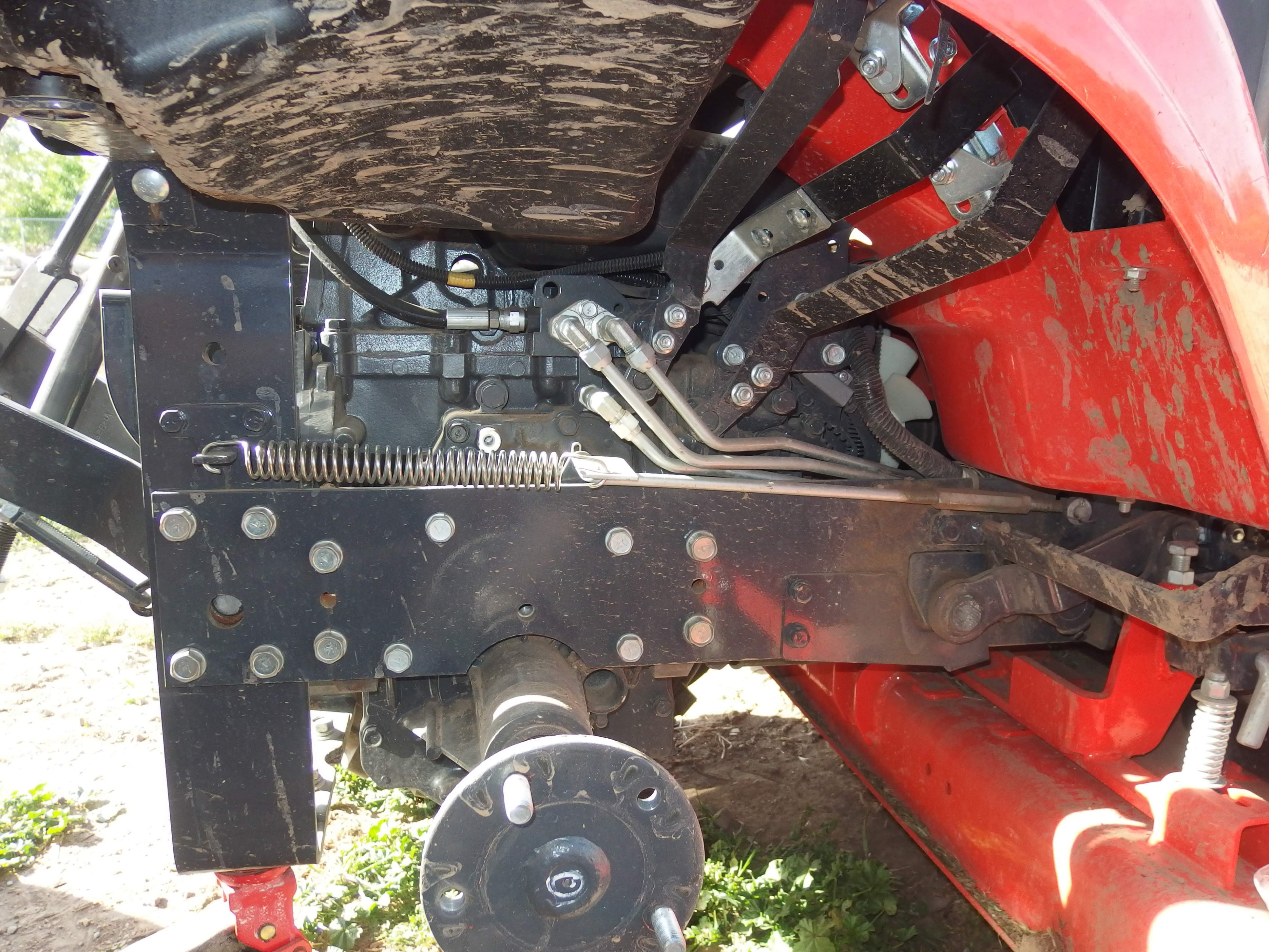

Well, at least you had this thread and a few others on TBN to go by. Thank Actionaj for making us all aware of it. The kit worked out great on my old BX1860, but alas, it won't work with the backhoe equipped BXs due to interference with the backhoe subframe. I had to make up an aftermarket setup on my BX25, which does not look near oem, but works. Will await your pic's and feedback on the installation. Hope you have a good array of open end and box metric wrenches, and maybe some crows feet wrenches. It gets real tight in there trying to turn a wrench.
   / BX7326 Rear Aux. Kit (install) #59

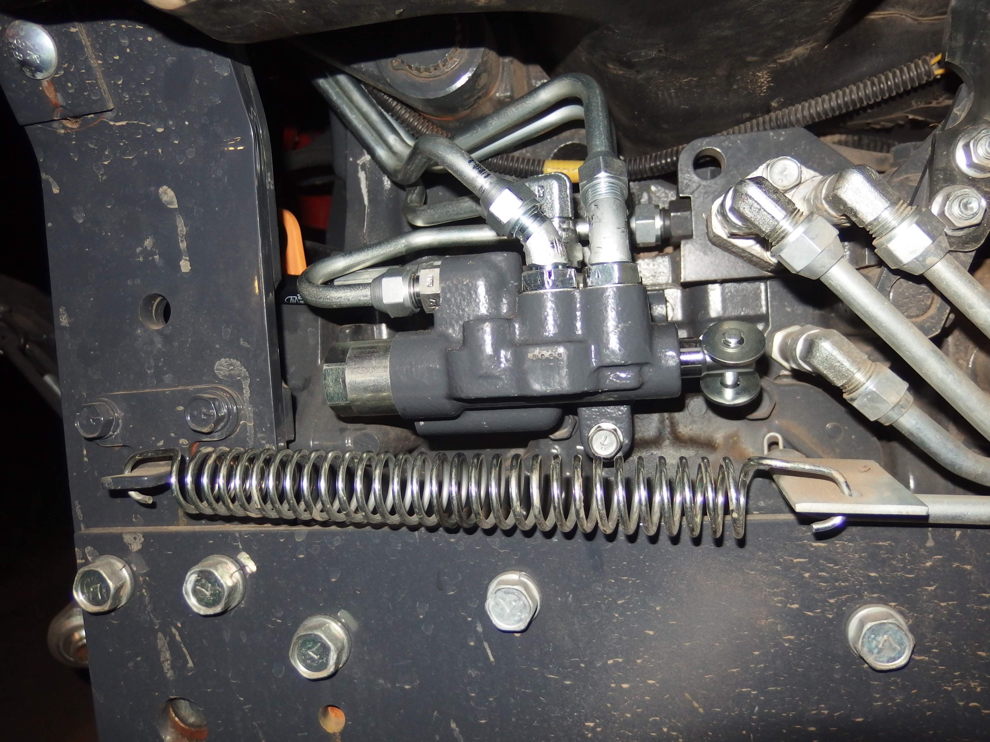

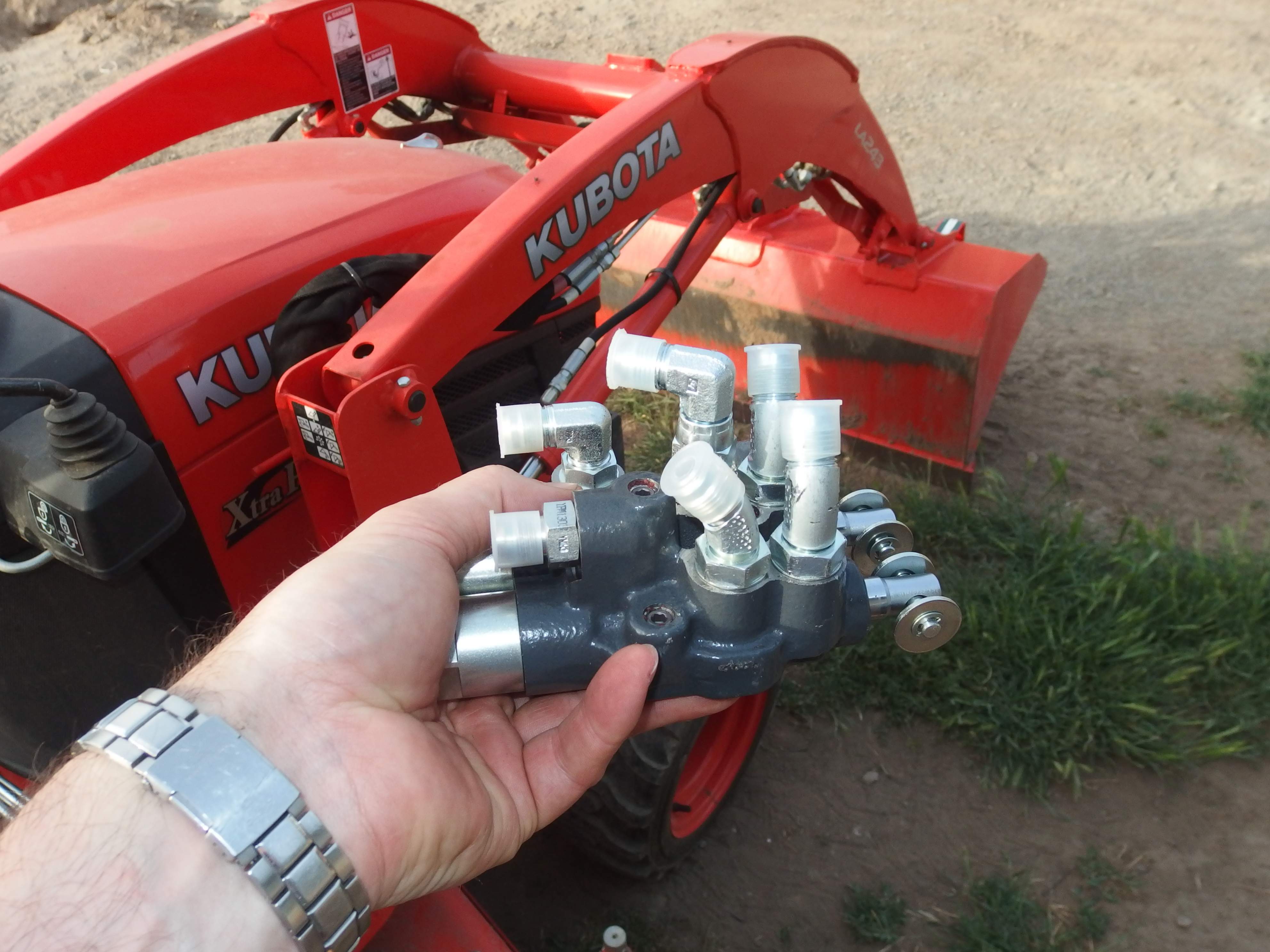

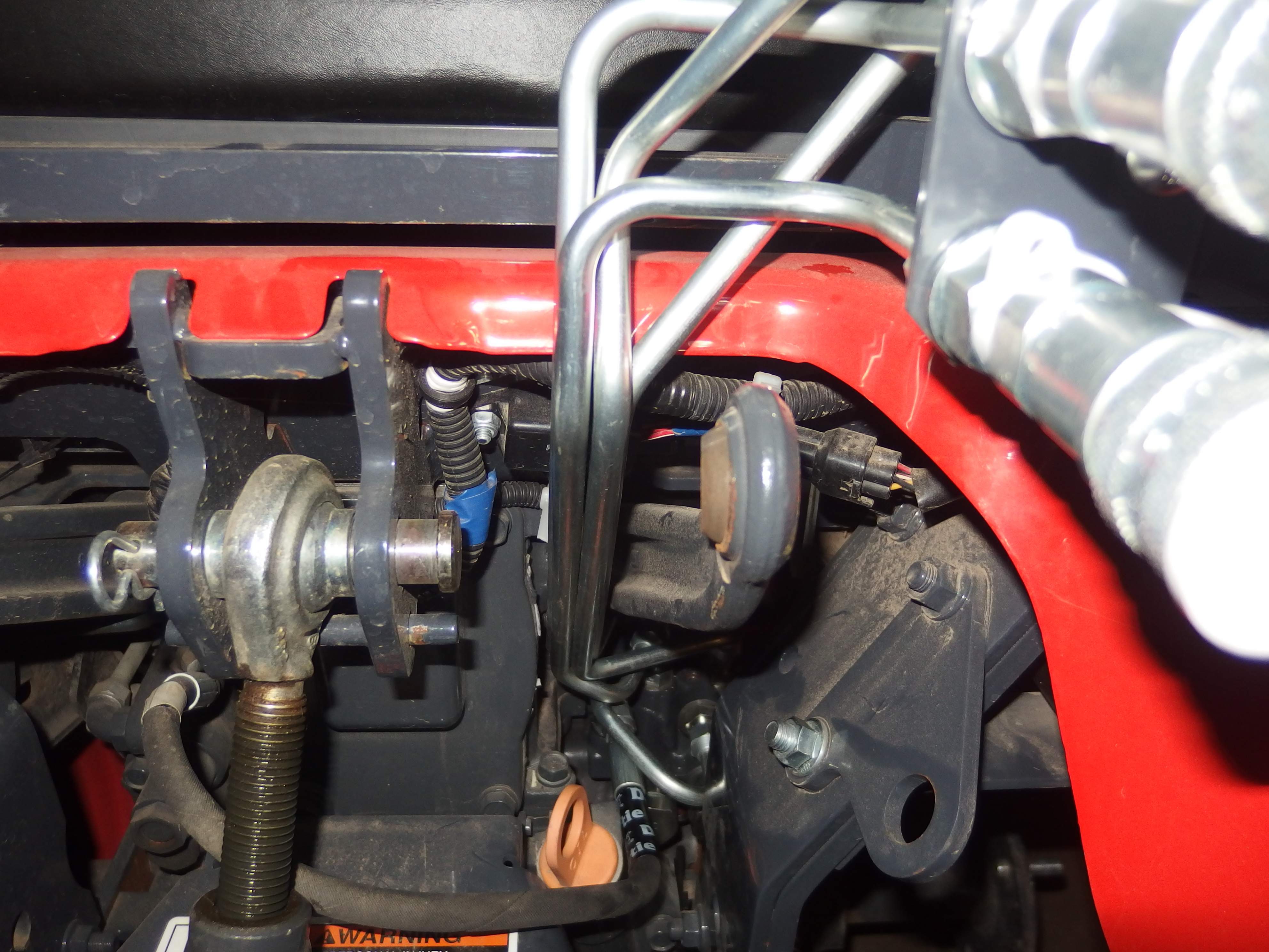

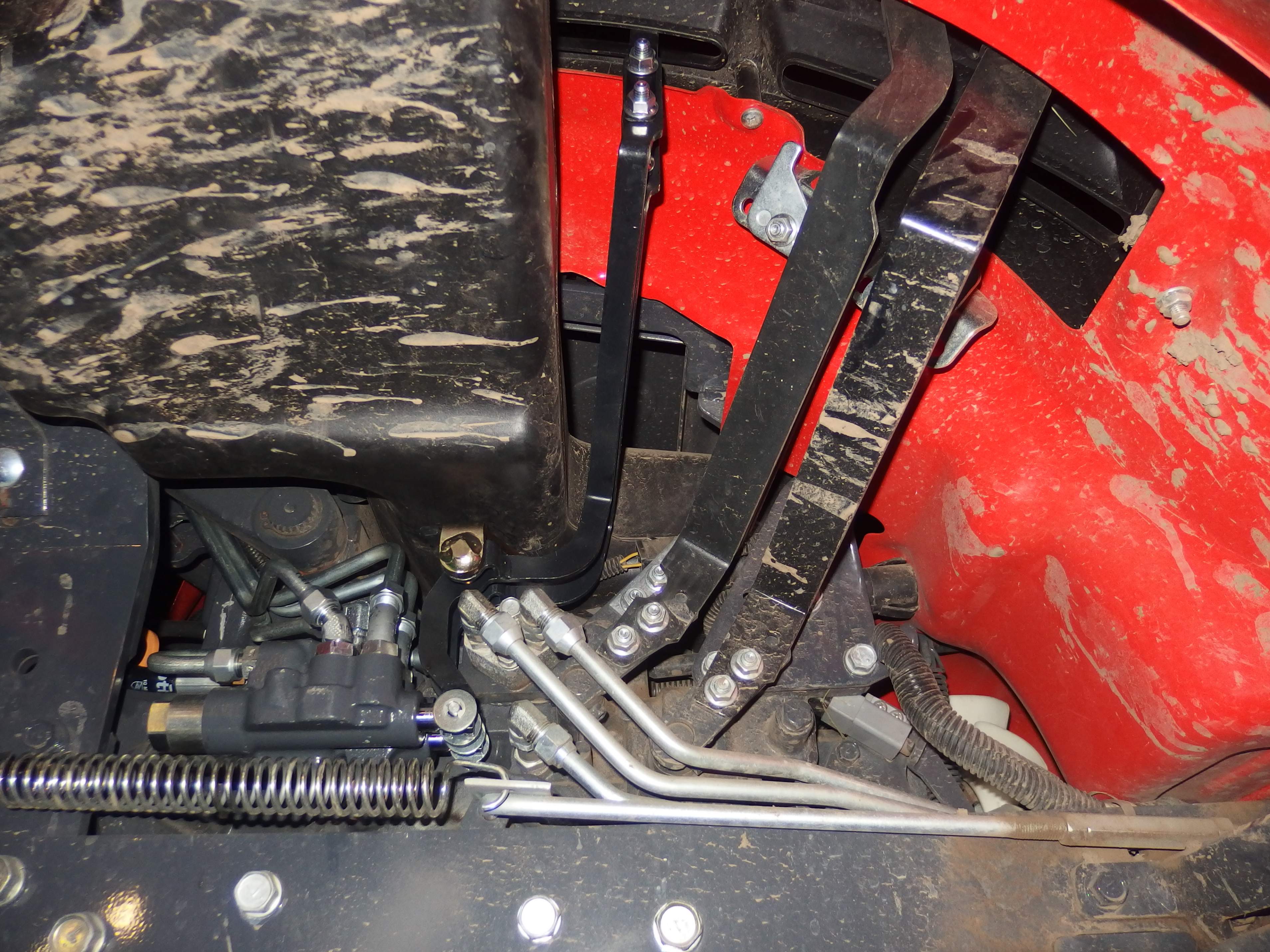

Well. That install was a lot harder than I expected. I'm embarrassed to admit that it took me 5 hours with a few interruptions. My biggest problem was connecting the hydraulics. All the tubes had to be aligned VERY precisely, or the threads would not line up and tighten. And it was very hard to align. I had to loosen and re-tighten many of the elbows at new angles. And it was hard to loosen and tighten bolts in there, with almost no space between the bolts. None of my wrenches were really skinny enough to work on the valve. It required lots of time with many different wrenches and pliers. It would also have been nice of Kubota to label those four tubes instead of having us match a 3D bent tubes with 4 2D pictures of them.
But I got it done, and it looks very OEM. No monster valves and levers hanging off the ROPS, just Quick Disconnect goodness and two OEM levers. Next up, buy a hydraulic top link.
If you want my install advice, here it is:
The tubes you see in my pictures don't connect directly to the valve. They connect first to elbows using seated compression fittings.
Ignore the part of the instructions that tells you the order and when to install the elbows and connectors to the valve.
Instead, put the elbows on finger tight. Only tighten the two straight ones.
Now Install the valve to the tractor per the instructions. Leave it loose for a little play.
Now thread the tubes from the ROPS to the valve.
Now, working from the hardest to access forward, one at a time, line up your tubes with your loose elbows.
REMOVE the elbows that are in your way. Tighten the ones you have connected to the tubes, then replace the elbows you removed.
This sounds stupid, and maybe it is, but it's what I had to do anyways after following the instructions first. Until I loosened the elbows, nothing would align. And I DID install all the elbows at precisely the angle indicated by the manual. The tubes are each just a little unique, so you need some wiggle room.
