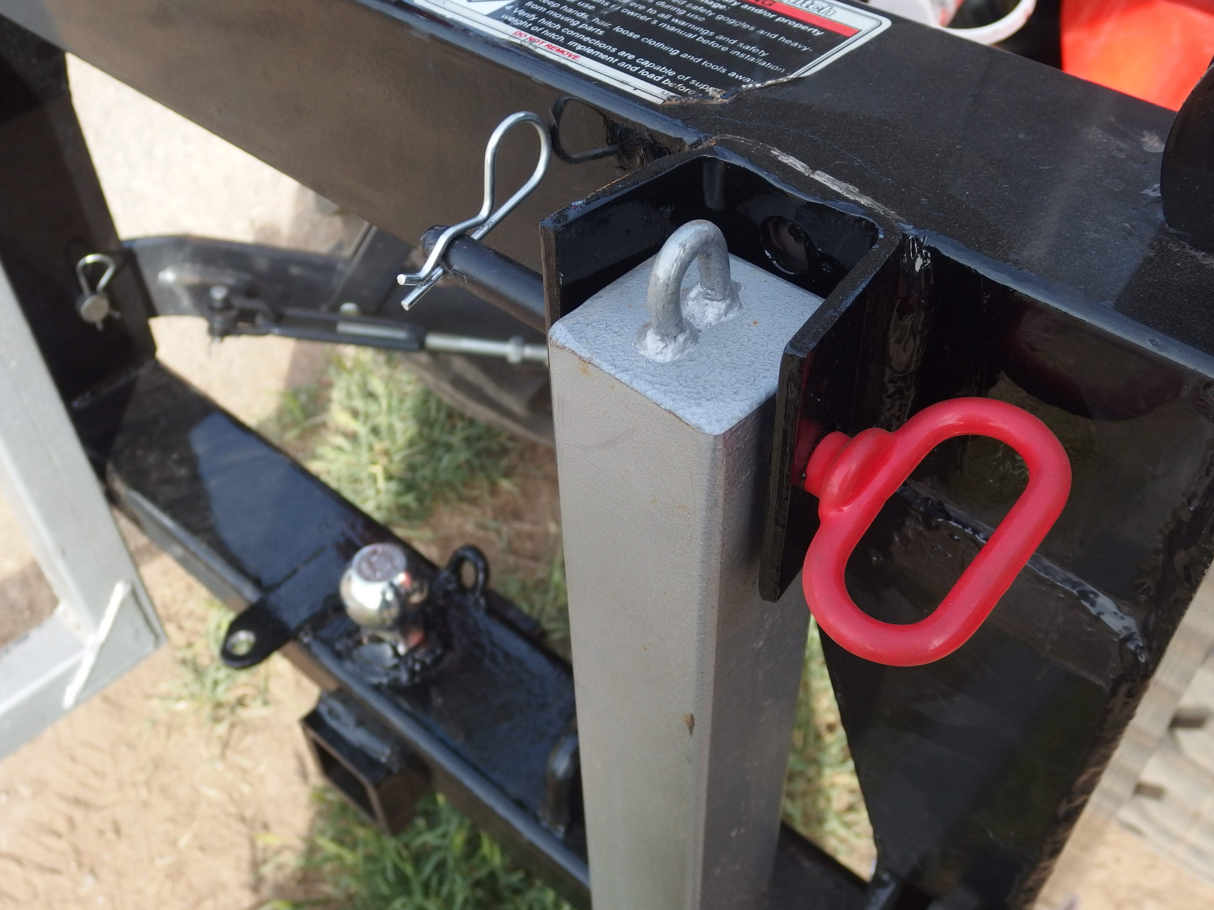

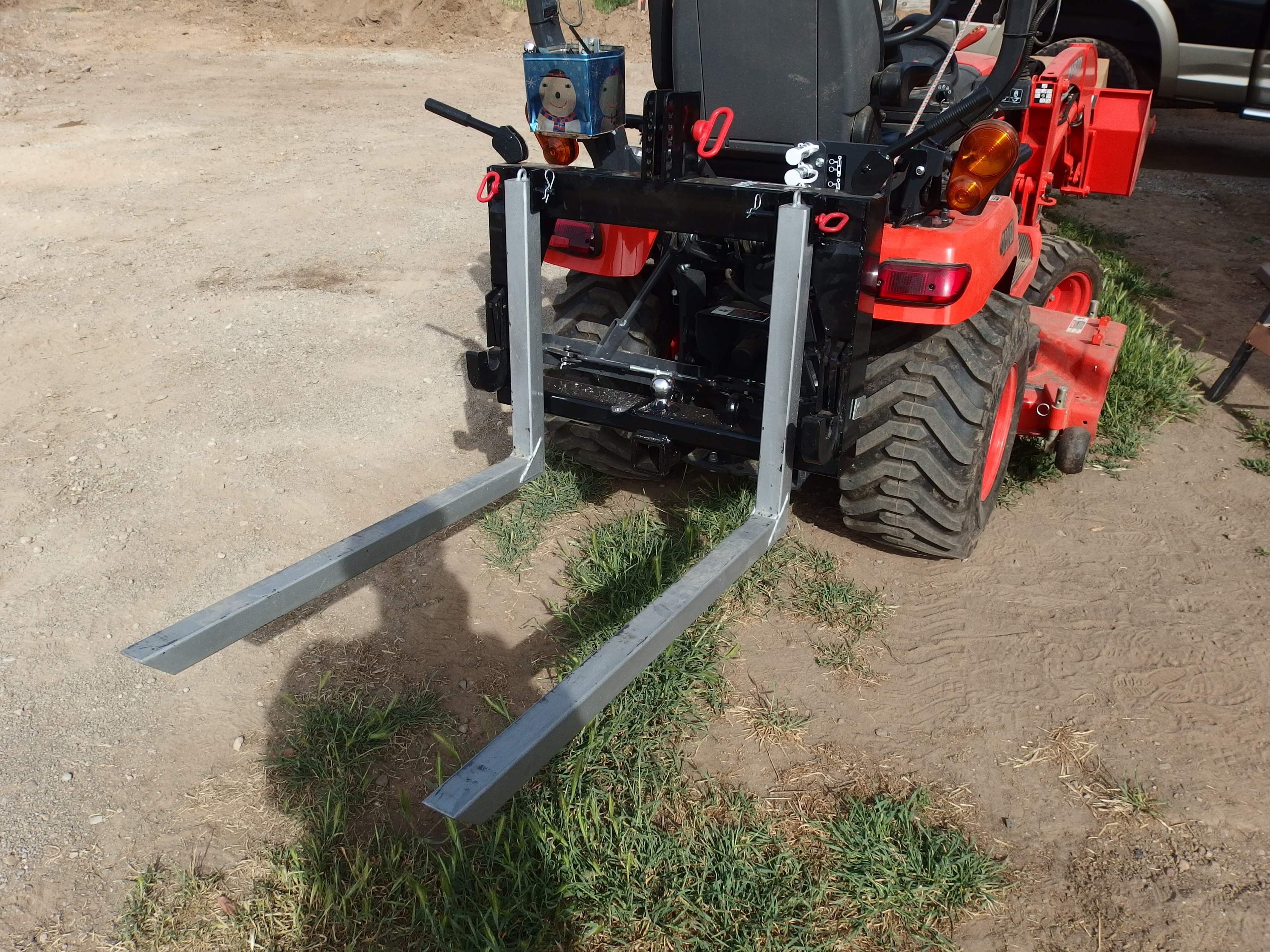

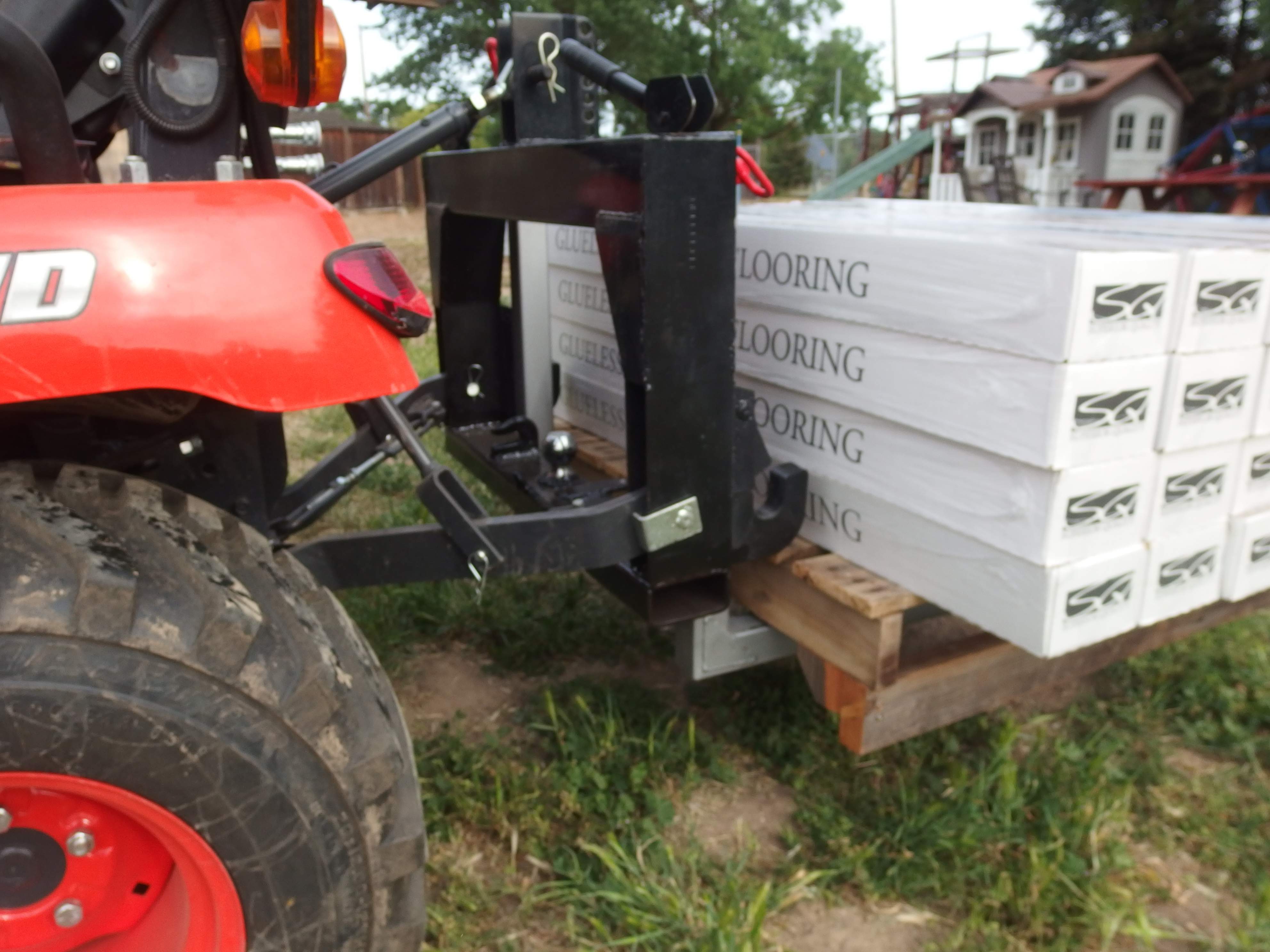

By the way, here's one of the useful things I wanted the rear aux hydraulic kit for. I welded up some extra mounts for my BXpanded bucket forks, and moved them to the rear onto my quick hitch. Now I can forklift on the back or the front, but the back is stronger, and makes for more maneuverability. Pic is of me lifting 850 lb of flooring (I had to split the pallet they dropped off in two :-( or I could not lift it). Anyway, when I get the hydraulic top link, this forklift will work even better.
