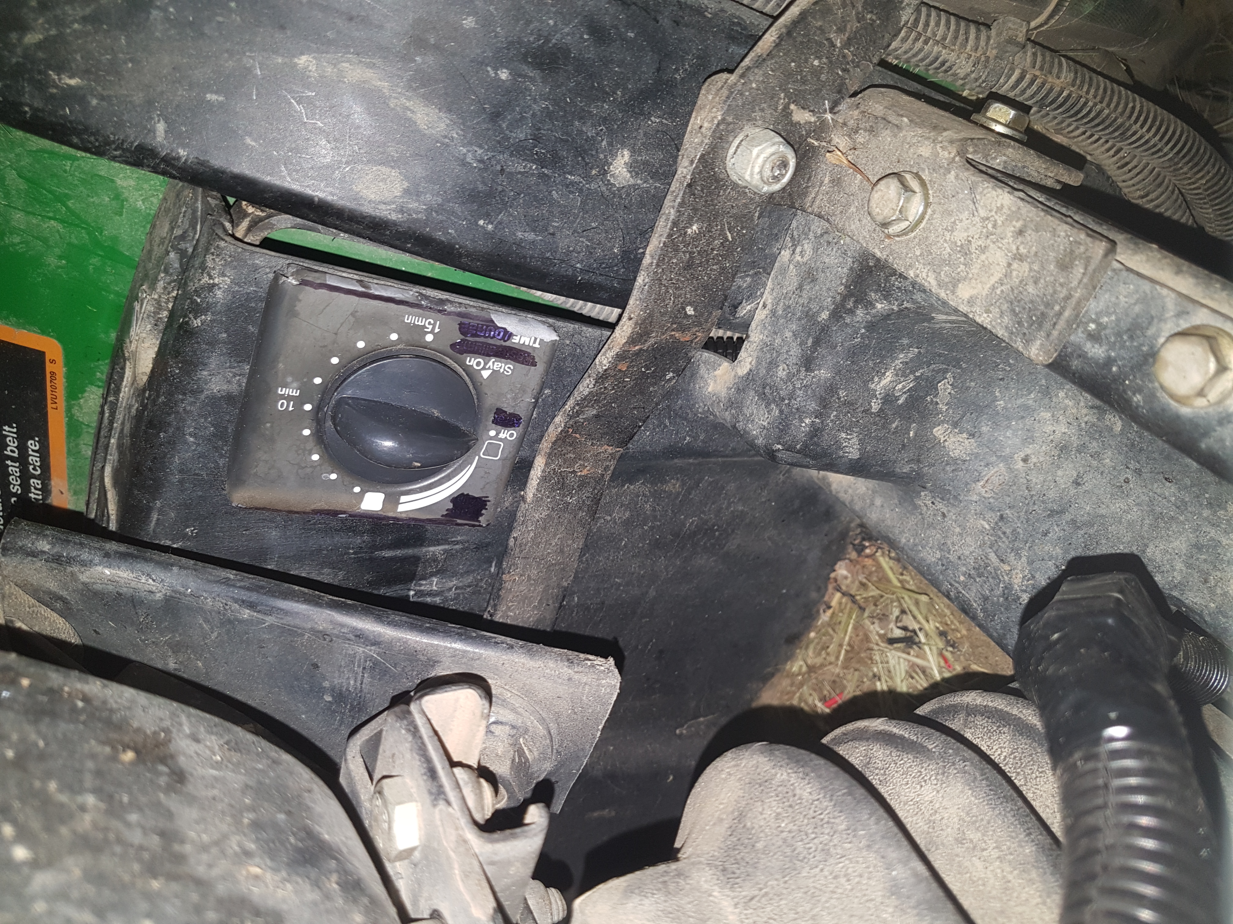

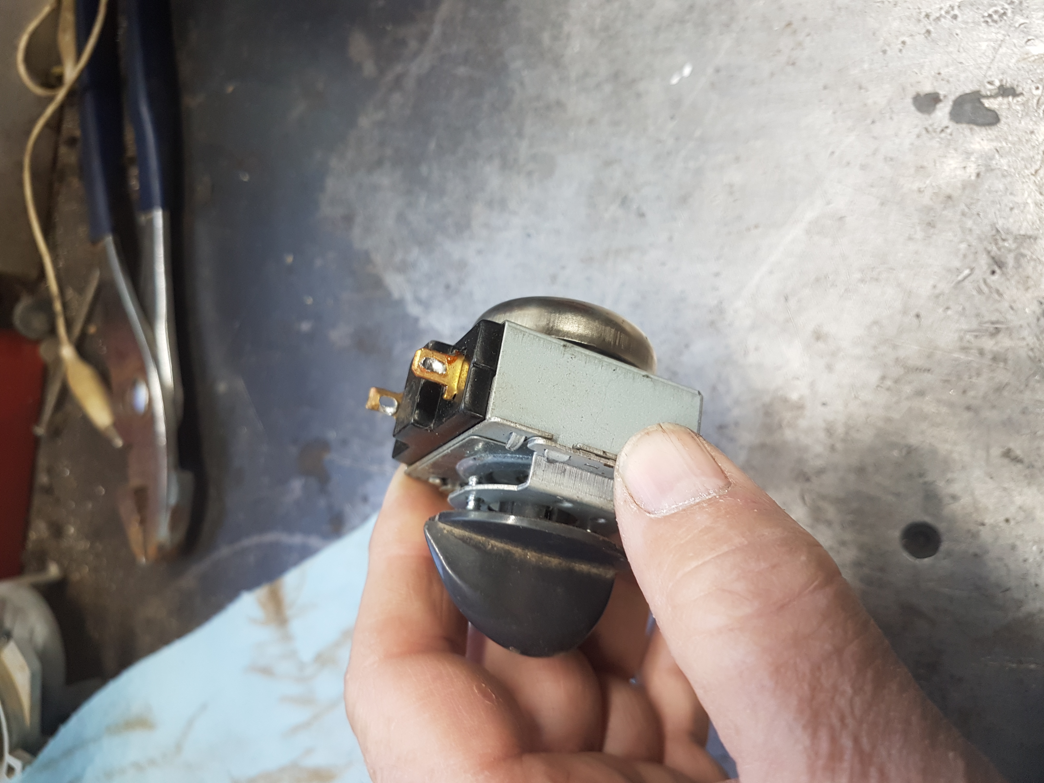

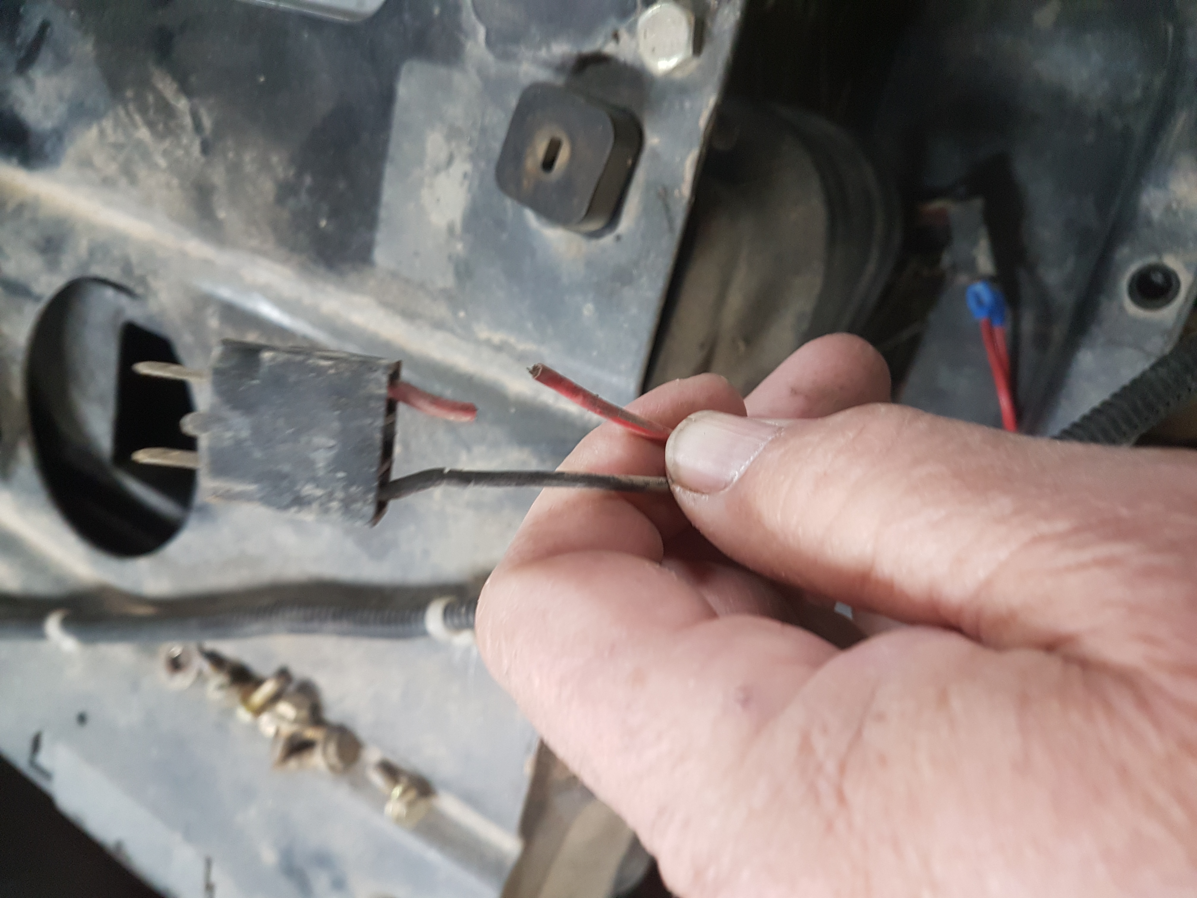

So this is what I ended up doing.
I really wanted a timer to limit how long the seat switch was bypassed as I knew i wouldn't always remember to disable the bypass. I was all ready to do the relay as per the wiring diagrams and I planned on working an a timer later. (winter job) Then I thought of the toaster oven that had issues. There was nothing wrong with the off/on/timer switch in the oven. So the oven got temporarily rescued from the scrap pile so that I could salvage the timer.
I still needed to do something with the seat switch. It was $80 CAD it the local dealer and I said no. For that kind of money I can rig up a $10 push to start starter switch or a microswitch as a seat switch if I have to. So I tested the switch and it worked ok. Then I went to modify the wiring to attach the bypass switch. There was a wire broken just into the wiring harness so I was glad I'd said no to the new switch.
So now I have a toaster oven timer switch mounted by my ROPS that does everything I want. Time will tell if it does everything it wasn't designed to do. Like 12 volts, vibration and dust.
FYI the red wire on the seat switch harness in a JD 4410 has power with the key on. It's handy to have a service manual even if it doesn't show you how to remove a seat switch!!!!!
