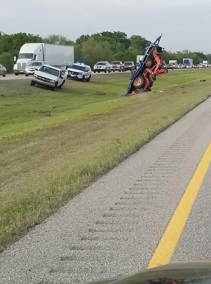

Personally I strive to be prepared as best as I can for the unexpected and worst cases. The following picture is a good example. No idea why the trailor came loose, but whoever tied down that tractor did well. That quality of tie down should be what we all strive for.
Wow! Totally trashed the trailer but the tractor still did not come off.

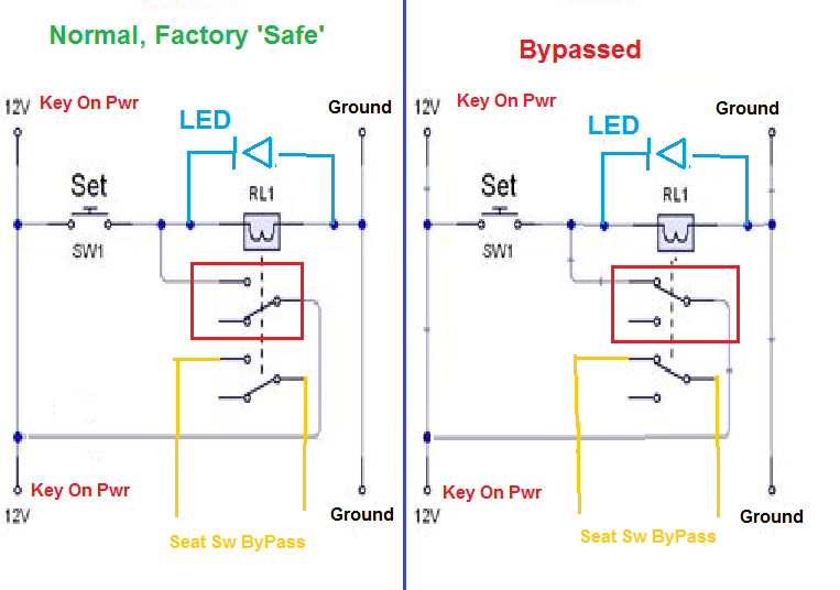

The operation on my Crapsman is as follows:
With PTO engaged, rotate ignition switch to secondary position, push button, LED comes on. PTO stays engaged (forward or reverse) until ignition is turned off or rotated back to primary position.
For those who want to add a switch, I suggest a momentary pushbutton switch that engages a self-holding relay that stays engaged until the ignition is turned off. That way, when the unit is started the next time, the safety works again unless the override is activated. A child or uninformed operator would be less likely to have an accident. Any commonly available double pole relay can be wired as self holding.

For those who want to add a switch, I suggest a momentary push button switch that engages a self-holding relay that stays engaged until the ignition is turned off. That way, when the unit is started the next time, the safety works again unless the override is activated. A child or uninformed operator would be less likely to have an accident. Any commonly available double pole relay can be wired as self holding.
This is the one of the better ideas I've heard of. I'm trying to wrap my head around how to wire it. If my seat switch has key on power going to it then it'll be easy, but even so there should be a way of making it work. The idea would be that the push button would energize the solenoid which is wired to stay on till the key is shut off at which point the push button would need to be used again to activate the bypass feature.
I like this idea as one of my issues with wiring in a permanent switch was what if you forget about turning it off. If I was only educated enough to wire in a logic circuit that would reactivate the seat switch after the seat had been sat in for more than say 10 seconds.
   / By pass of seat safety switch - pro's & con's #70
This SHOULD work, but you'd need to work up- a test rig to be sure. Pressing the 'Set' switch closes the relay, closing the contacts (in the red box) that hold the relay closed as long as "key on" power is applied. Turning the key off drops power to the coil which opens the contacts. They remain open on the next machine start unless the Set button is pressed again. The orange wires are the seat switch bypass circuit. I can't draw that here because they all might be different, but this is the same place a simple toggle switch would be. The LED comes on when activated. I may have the diode symbol backwards though. You'd have to verify polarity of whatever LED you choose. Most 12V auto type LED pilots come with red and black leads.
The seat switch doesn't need 'key on' power. You can run a lead from any 'key on' accessory to this override.
