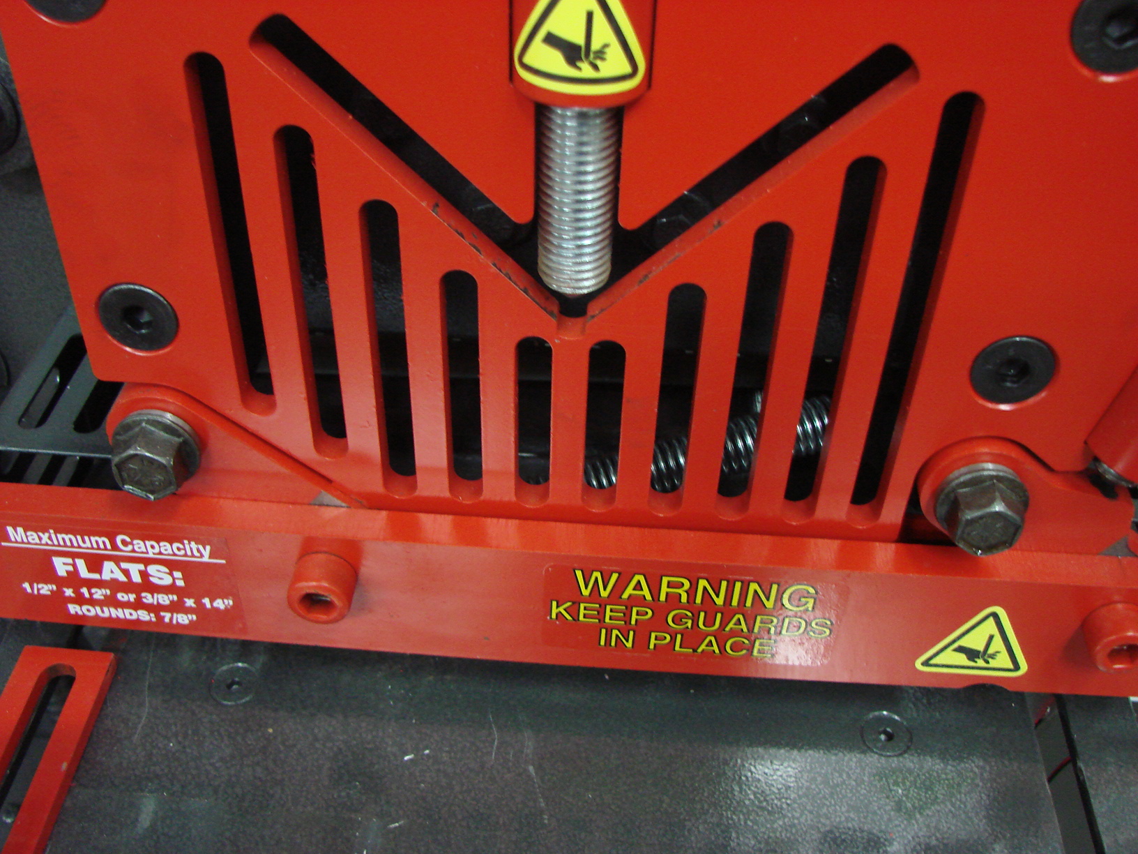

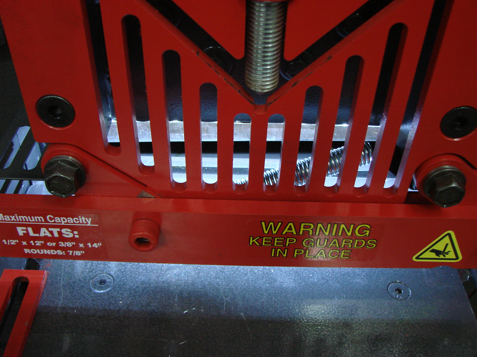

One of the other items I needed to address with this Ironworker was when I was cutting plate on the shears with the guard in place I couldn't see the cutting edge of the blade because it was 5.5" past the guard and I would have to use a flashlight to see in there to position the plate.

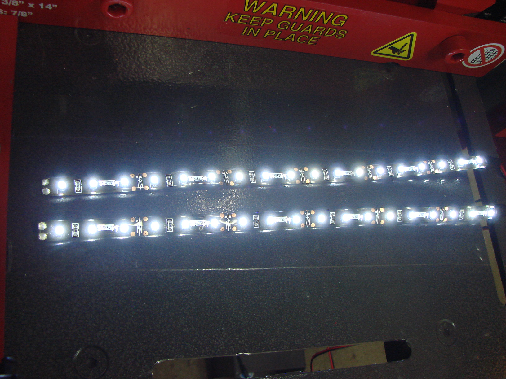

I was at wally world today and found a set of flexible LED strip lights. There 12 volts so I used a transformer to power them up and the results was amazing. It took ten minutes to install and they came with 3-M two way tape already on them and are built very well. I installed them up out of the way of the blades. I think i'm on my way to having a pimped out Ironworker ;) :laughing:
Take a look.

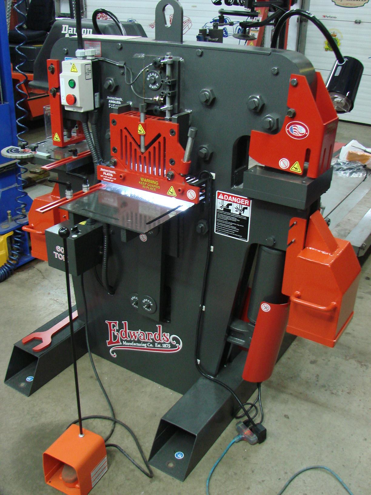

With lights installed and turned on.

Got the lights in the auto section of the store. As soon as I seen them I knew that's what would do the job. Really happy with them. It's nice to be able to view the cutting edge of the shearing blade now without having to use a flash light. Two more mods to do on this thing and it's where I need it to be. I used it every day last week so it's turning out to be a great addition to the shop. The next mod will require the use of the mill :)
