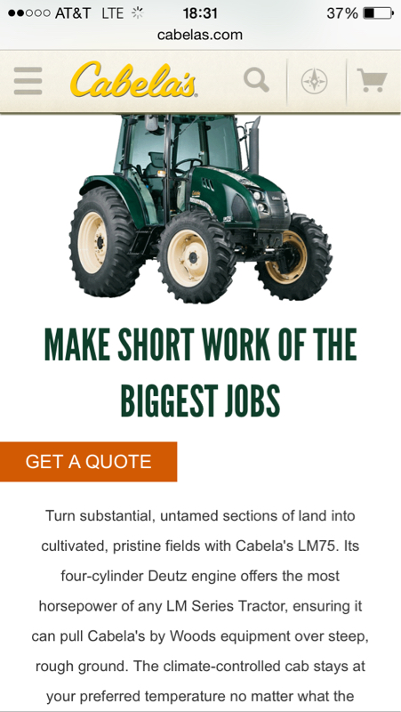

Cabelas now offers at 75 hp tractor that has a, you guessed it Deutz engine. Not the 72 hp Perkins used in the TYM T723. TYM is still selling brand new tractors with Perkins engines too. It's called New Old Stock.
