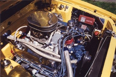

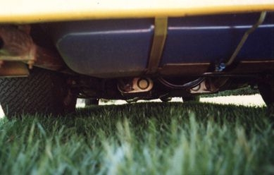

One of my several hot rods (mid-80's Mustang LX into which I jammed a 7.1 liter motor) didn't have space in the trunk for a proper fuel cell, since there was a NOS bottle and battery already eating up that space. But we were having fuel delivery problems with the OEM sump on the tank, whether it was too small or damaged, so a buddy offered to braze a bung fitting into the bottom of the OEM fuel tank for me.
Believe you me, I have never washed and rinsed anything so well in my life, as I did with that fuel tank prior to drilling it and then letting him put a torch to it. :ROFLMAO:
Digital cameras weren't really a thing yet back then, but I managed to find some old and very small scanned photos, one showing that tank bung.
