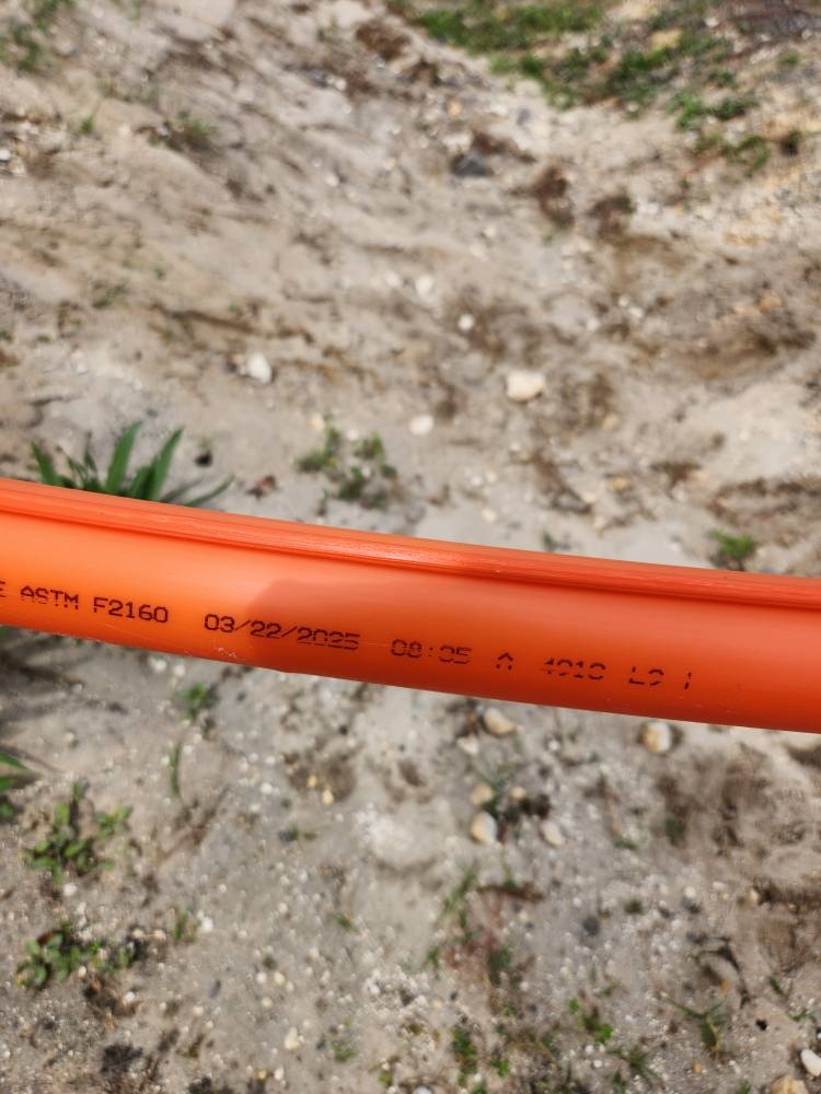

We have started doing a couple jobs with this new style conduit, with the tracer wires embedded in a bulge on the side of the pipe. Now, that seems like a good idea, IF, they connect that tracer at the tie-in points.

It really sucks doing couplers on that pipe with tracer wire.

I'm assuming you skin it back to couple. Do you have to use a clamp style coupling? Then the real key, from a future locating point, getting a good connection of the wires. Haven't really messed with this except hand hole to hand hole shots so far.
Recently did a small 2" poly forcemain, guy that normally does private property work, and he was surprised that he needed tracer wire.

Yeah. After a month I was told connecting the tracer wasn’t needed. You still had to peal it back to make the coupler work properly though.
