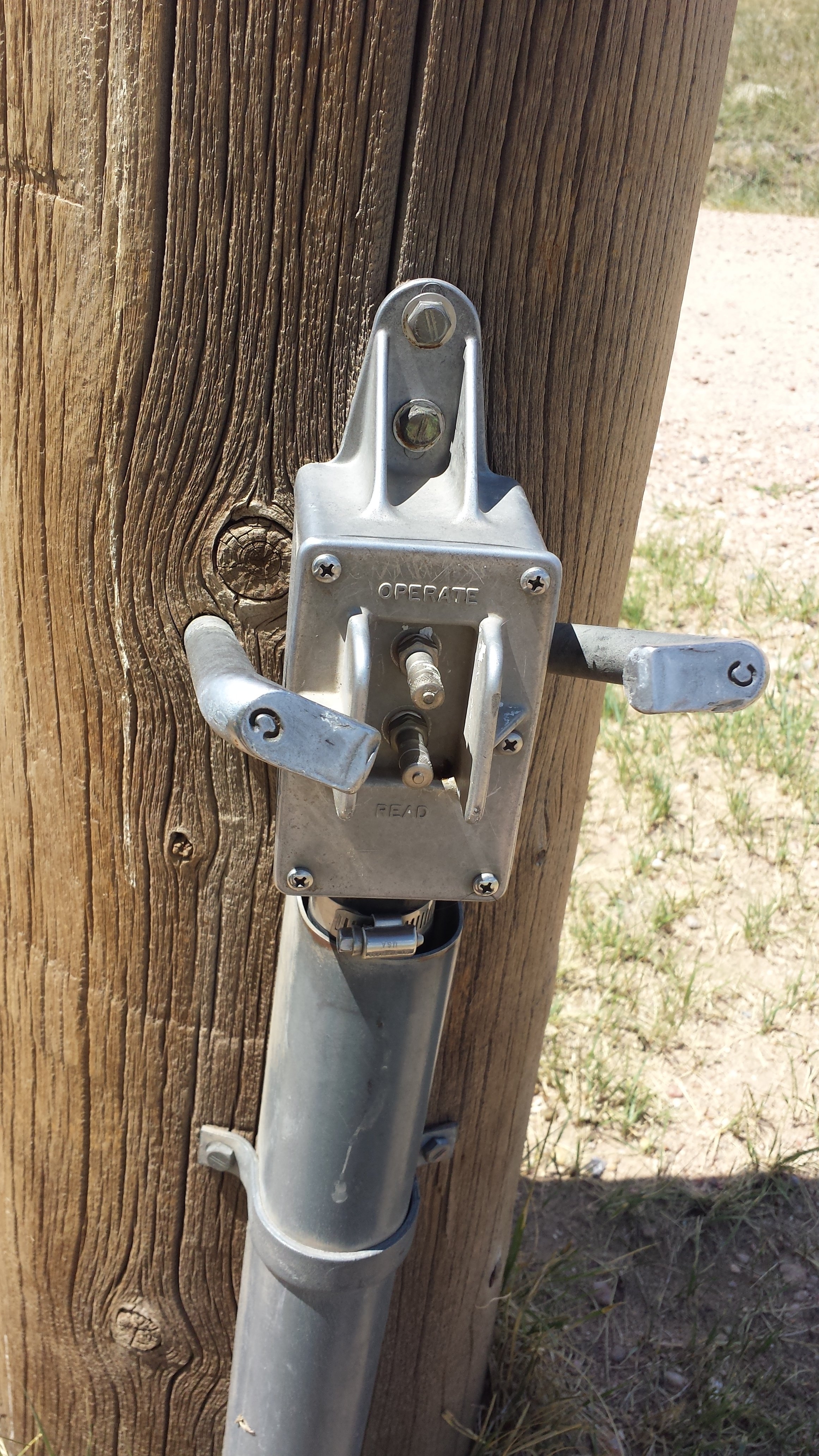

Cable test point in a remote area of NE Colorado. I would have not noticed it but was reading a trip report to the Pawnee Buttes area and they presumed it was for area nuke silos. So I kept an eye out for one. Maybe someone in in here knows exactly what it is. It looked like schrader valves.
/ Call before you dig #122
Leaded air cables have Schrader valves, but that doesn't look like the lead air cables I've seen. Ones I've seen, is in a pedestal, and it's a soldered lead "hose" with a Schrader valve.
But, much of our infrastructure predates me, and frankly often any living person. Not uncommon to work on nearly 100 year old stuff, from bridges from late 30s to water lines from the teens. People miss something with FLa, they know St Augustine and Pensacola are Old, like 450 years old, but they think the rest is 1980s or newer. Gainesville, Palatka, Ocala, Starke, Lake City, Tallahassee, Jacksonville, ect are pre-war.
/ Call before you dig #123
That could be a specialized splice, that is pressurized to keep ground water out? Now they are grease-wax filled, but i wouldn't put it past old copper splices to use air, or other inert gas to keep them dry?
/ Call before you dig #124
I wasn't about to take the caps off to look. I do recall the rough area and there is a cable line marked on topo maps. Some seem to go nowhere or they end next to a silo/launch complex. This whole area is active Minuteman III silos 321 Missile Squadron, Warren AFB.

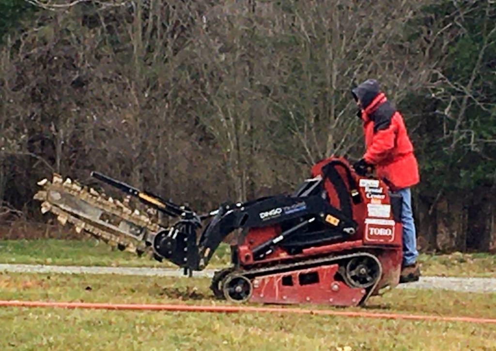

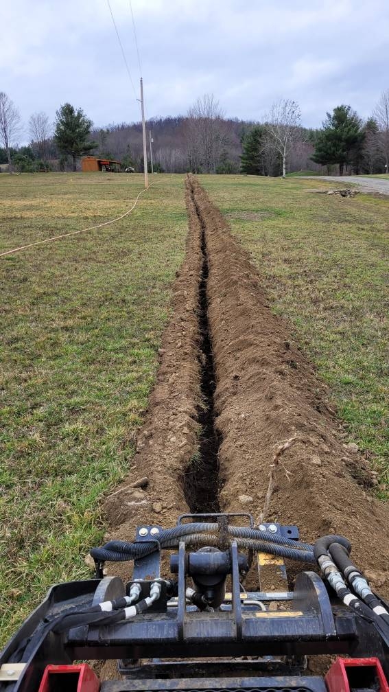

I called 811. Guy shows up and flags all the utilities including a major gas pipeline crossing my property. He said I'm not supposed to tell you this, but that's a 12 inch main line, installed in 1978 (so over 45 years old) that is down about 6 feet "according to my meter". Rules were I could not dig within 25' either side of the pipeline without a representative from the gas company present.
Followed up with the gas company and they agreed to be there Tuesday by 12p to watch. So I rented a very capable Dingo to trench in the 1000' conduit run for the cable service. I had already trenched the 950' balance before he got there, so was familiar and very comfortable with the whole trenching operation at that point.
Amazing how much higher the pucker factor was trenching the last 50' running over the pipeline...though only digging down 2 feet, and in spite of it being brrr suit weather, I was sweating bullet sized drops the whole time while digging over that pipeline!View attachment 2993213View attachment 2993254
In FLa, that gas would be "high profile" and the utility can list it as that on their positive response, and require a rep to be onsite. That may or may not come mark them prior, and that's why it's important to check your positive response.
