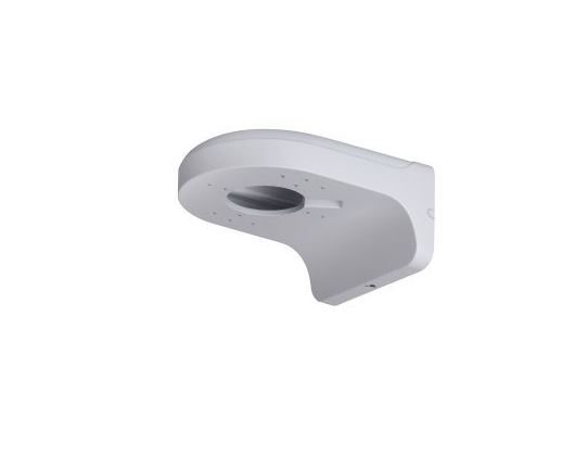

Dahua, amcrest has a nice wall bracket for their dome cams.

I understand the bullets are spider magnets. I did just order a Dahua Starlight to compare with my Reolink. They are double the price though. Also am considering the very same 5231 that you suggest but I do like the ease of mounting the bullets on vertical surfaces which is pretty much everywhere on my house. Otherwise I am going to have to fab up some brackets and I will have wire exposed.
Dahua Does make a mounting bracket for them and also a waterproof junction box.
