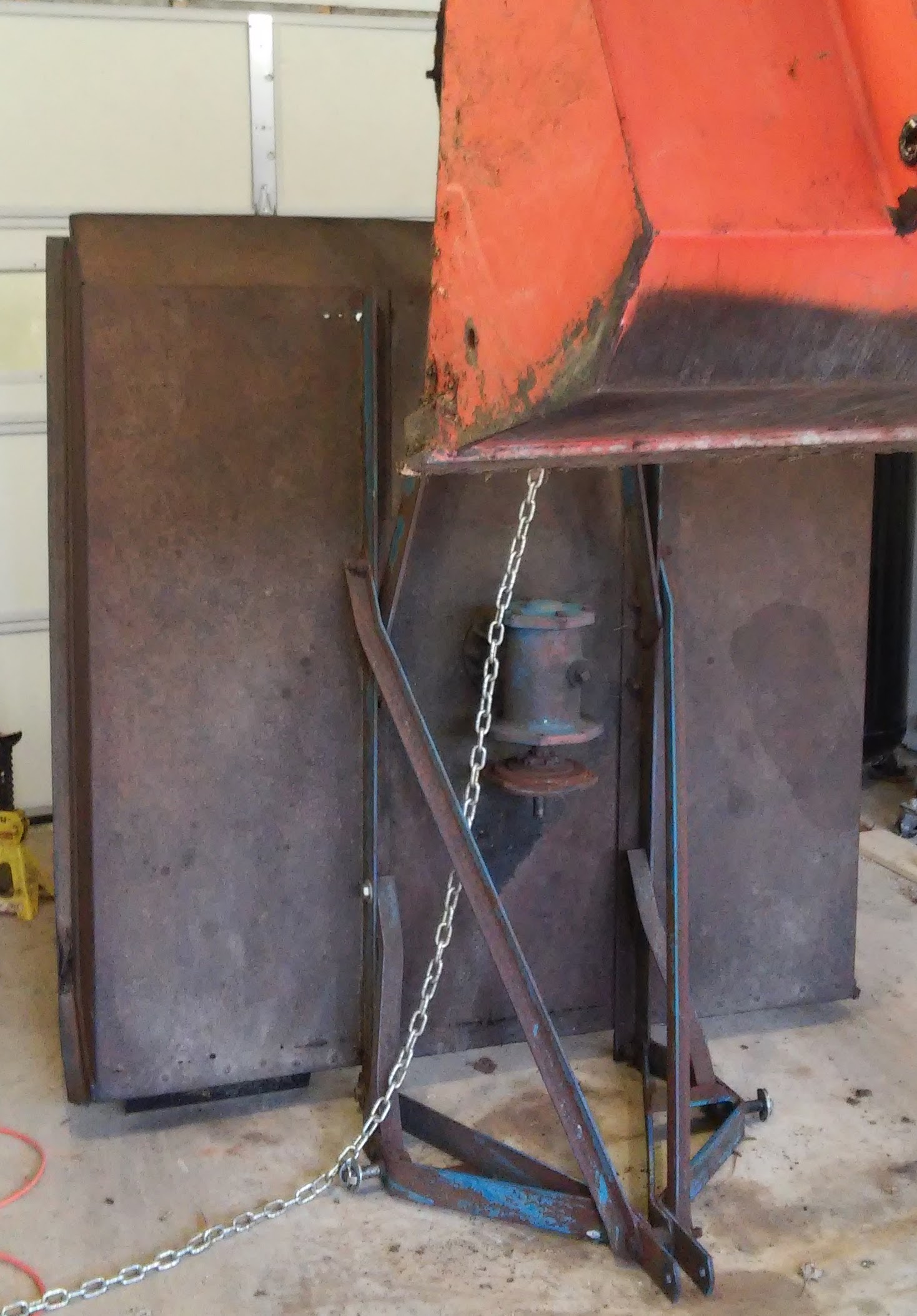

Any pictures of the thing? Might get more accurate advise on patch/replace and the best way to go about it.

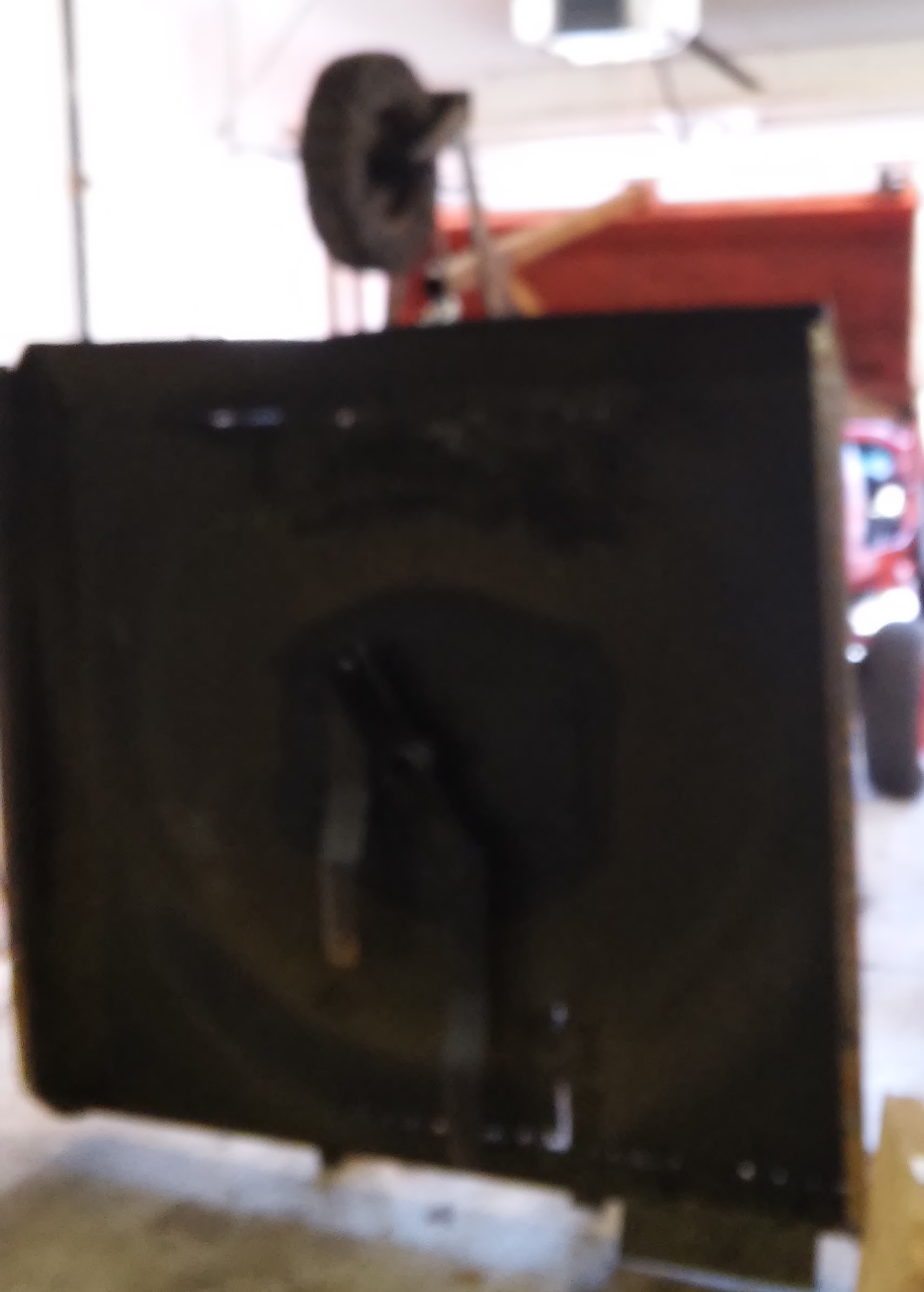

Picture?
   / Can I repair bush hog sheet metal with stick welder?
#36
Photo from bottom side is blurry, but you can see the light shining through holes.
   / Can I repair bush hog sheet metal with stick welder? #37
If it were mine, I'd re-deck the whole thing.
I have re-skinnes a lot of snow plows. Lots of support ribs and all. A rotary cutter looks easy In Comparison
#39
If you do all the fab and prep work, you can probably find someone to MIG it for you for an hour or so of shop time.
That's a very good idea. I found a guy that will come here for $80/hr, has all the mig stuff on his truck. I doubt it would take him an hour to do this if I get everything prepped.
   / Can I repair bush hog sheet metal with stick welder? #40
I think you could cut about 6 patches and tack them down with very little work. Might not look too pretty but probably last for years. Use something heavier than 20g.
