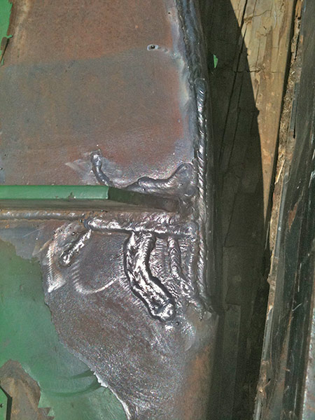

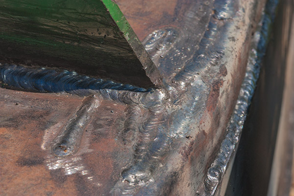

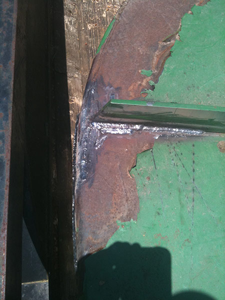

I repaired this bush hog for a guy I used to work with, You can see the patch on the side in the 1st pic and some of the welding where I had to weld up cracks and some small holes in the unit. All of this was welded with 1/8" dia. 7018 rods. with a Miller Synchrowave 200.

Nice work on the JD cutter repair, but that appears to be a heck of a lot thicker metal (3/16" thick or more) than the OP is trying to repair. No reason 7018 would not work fine on 3/16" thick metal without burn through.
The unit metal was just a little thinner than 1/8".....like about 12 gauge. I used 1/8" plate for the patch on the bush hog.
Nice job, he really did a number on that thing.
