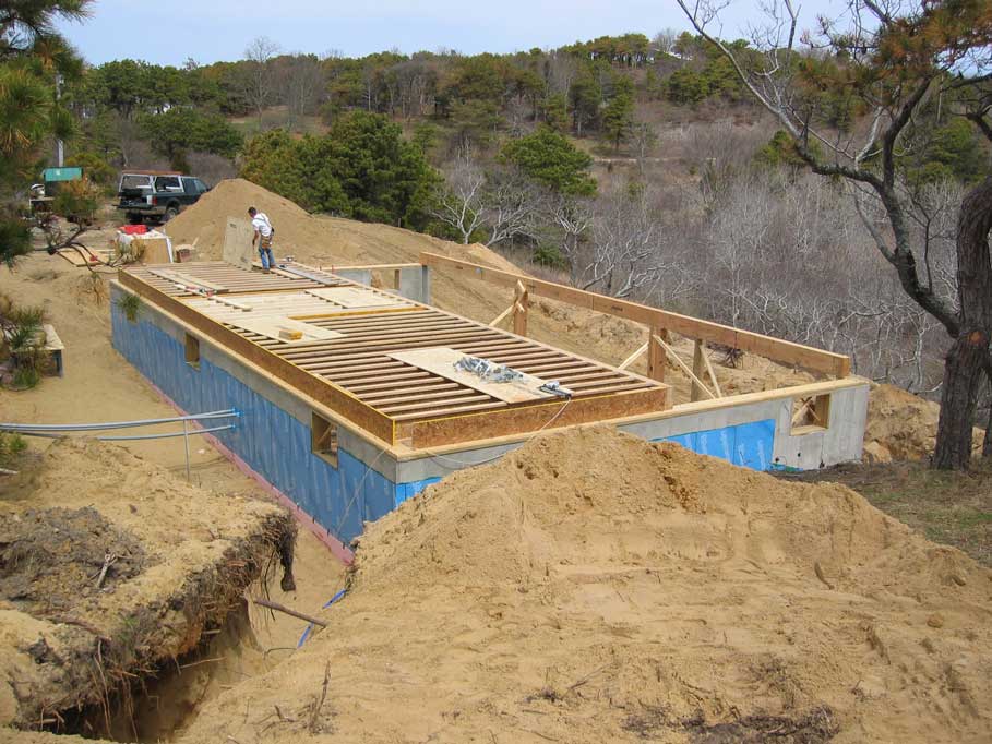

Harv, thanks for the reminder. Things have been busy. Finally catching up on my photos.
Here's a photo of the first SIP going on at the NE corner. It's a 4 1/2" thick panel (3 1/2" of foam between 1/2" OSB). Panels are 4' wide and extend from the sill to the eave, and fastened with 7" galvanized pole barn nails.

Photo of a smaller panel cut to fit around the ridge beam and getting ready to be lifted into place.
