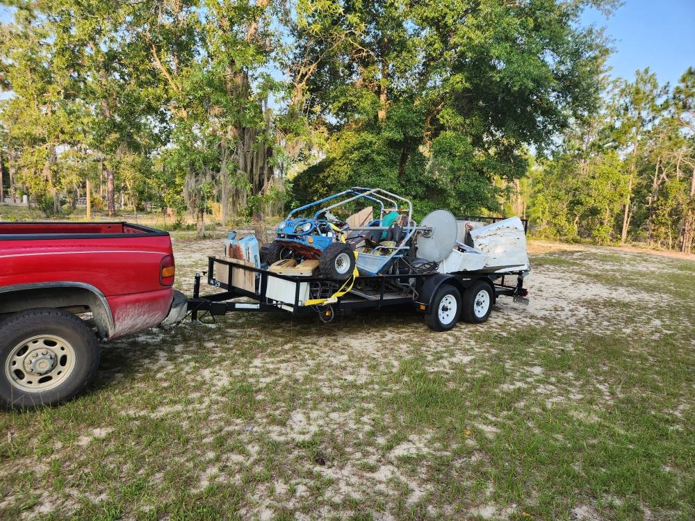

Some pics:
Here's a trip that was made much easier being a landscape utility rather than a car hauler:
