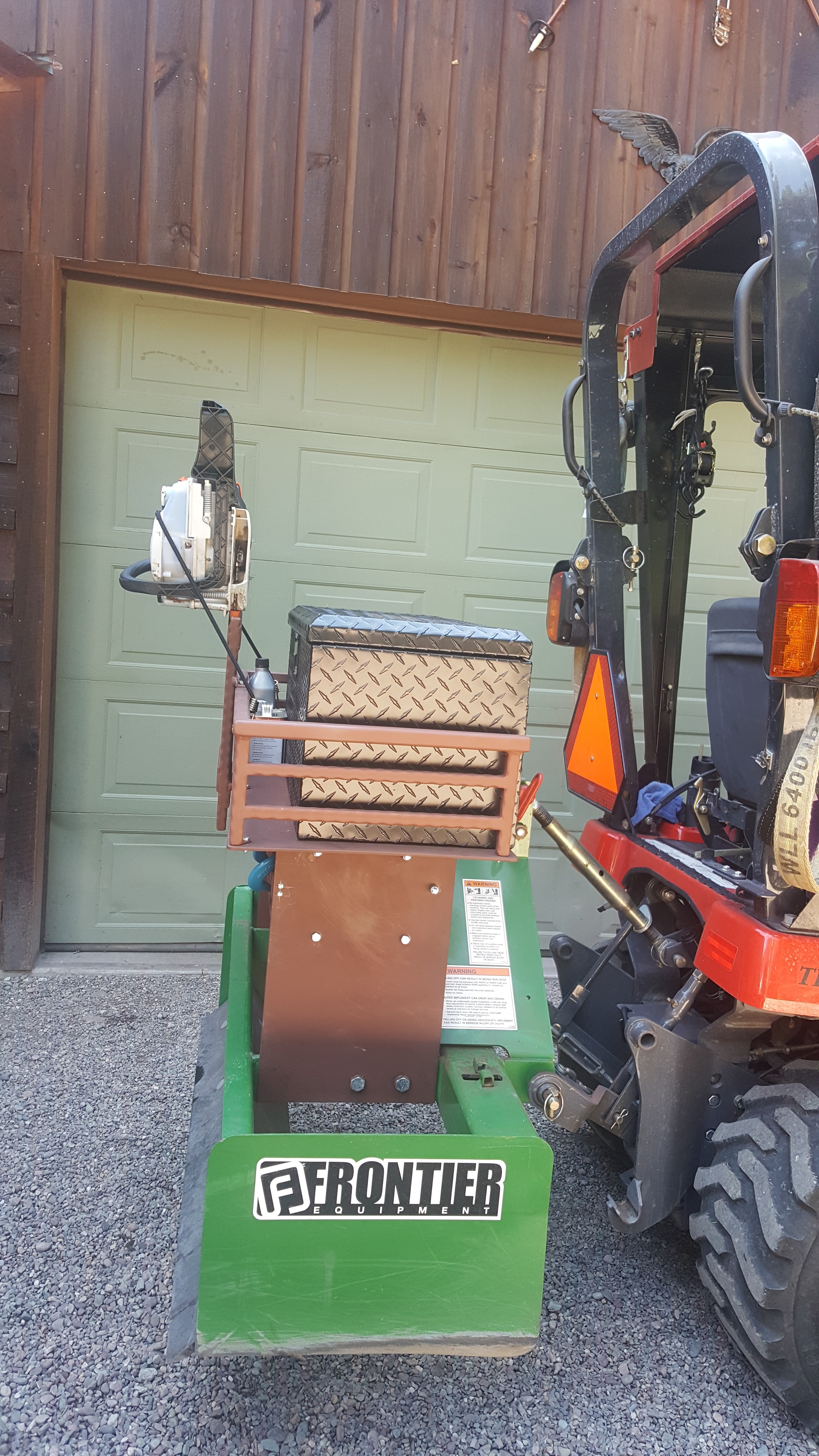

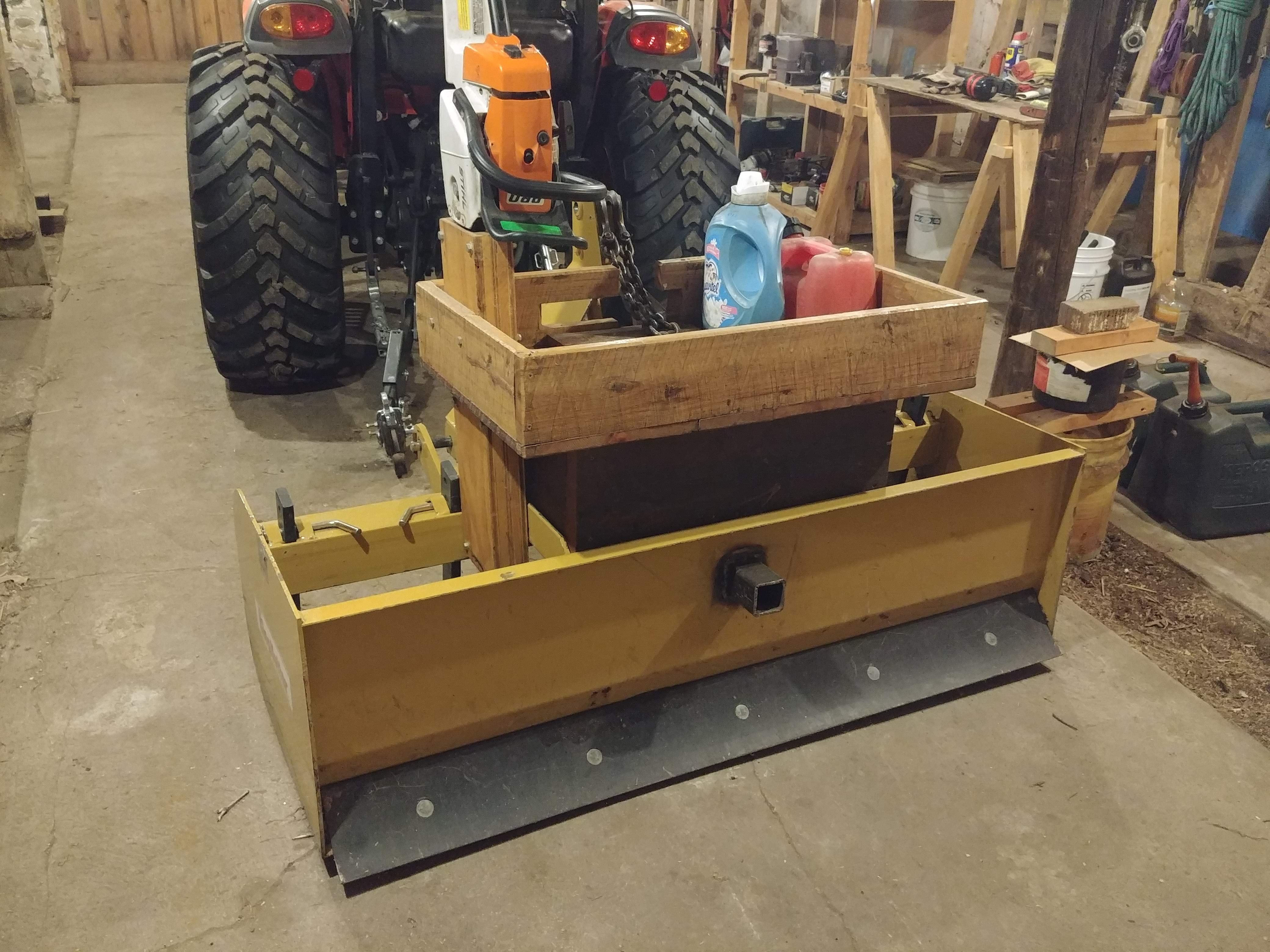

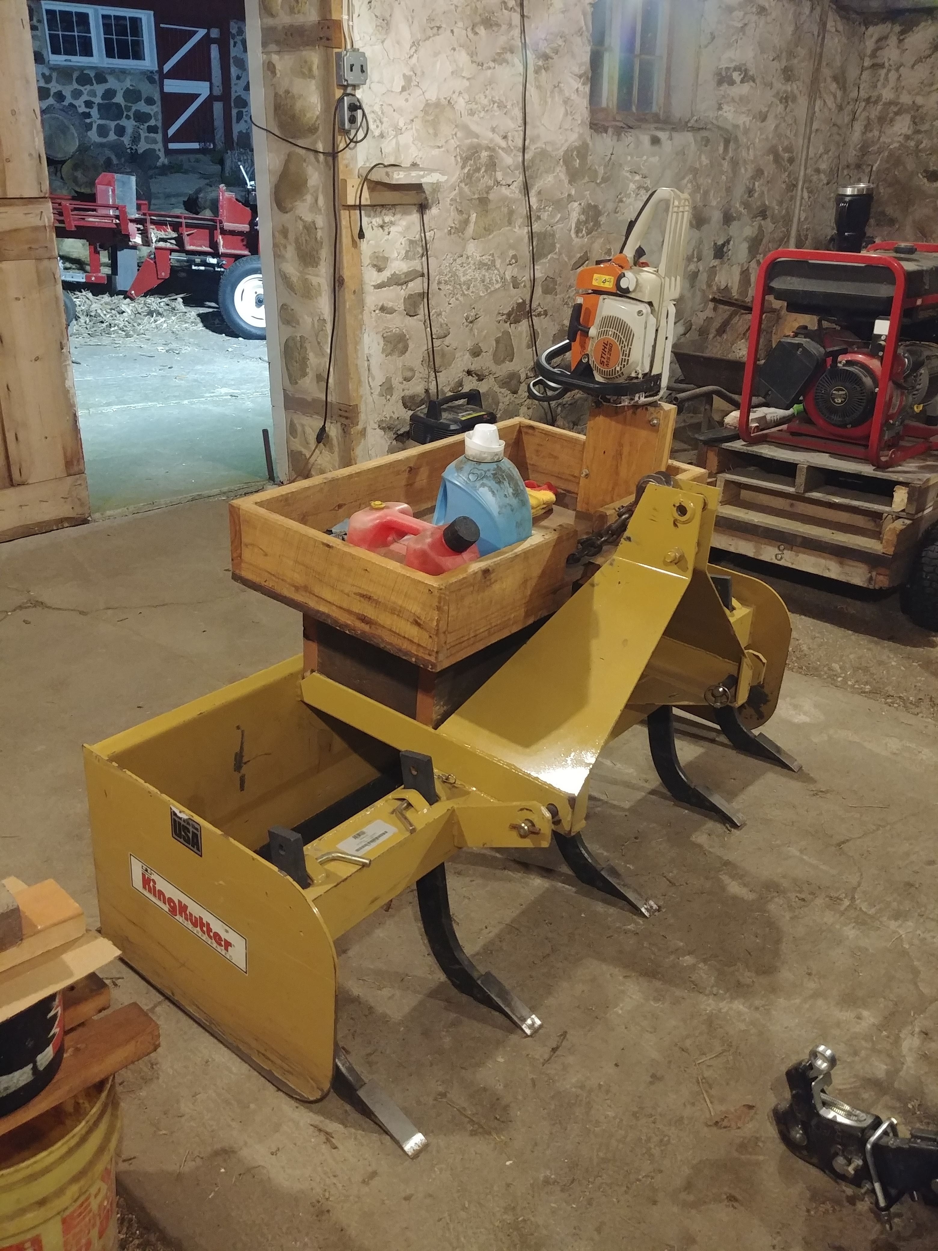

How are you guys carrying chains, chainsaws, gas/oil, etc? I see a couple of posts where chainsaws are being carried on top of the engine cover and a PT is towing a trailer, but what are the other ways you guys are using to at least carry a chain and saw from time to time?
The box on top carries the saw fuel and oil, and other tools like files hammer and wedges. The box underneath carries the chains with just the tops hooked above. It's nice having the grapple on the front for moving logs, just enough counterweight in back with the box blade, tools in the wood box's above, and chains accessible yet out of the way.

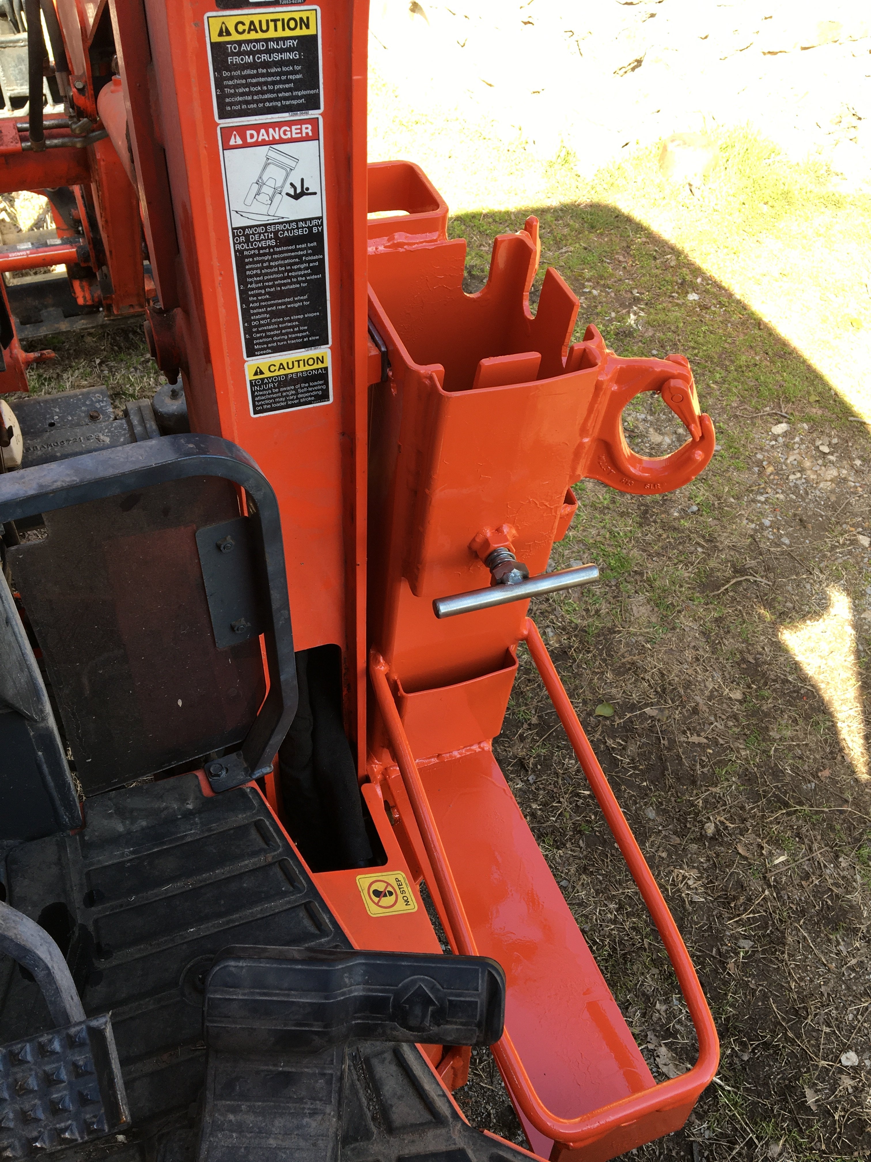

View attachment 1013408View attachment 1013409View attachment 1013410View attachment 1013411I made square tubing based tool carriers for my tractors. Variety of tools depending on job. Woods work needs to carry tools safely. Any hook to carry a 5 gallon bucket helps too. All tractors could use a chain box.
I really should make up a mount for the PeeVee. I usually just shove it into the FEL cross tube. And then keep an eye on it.

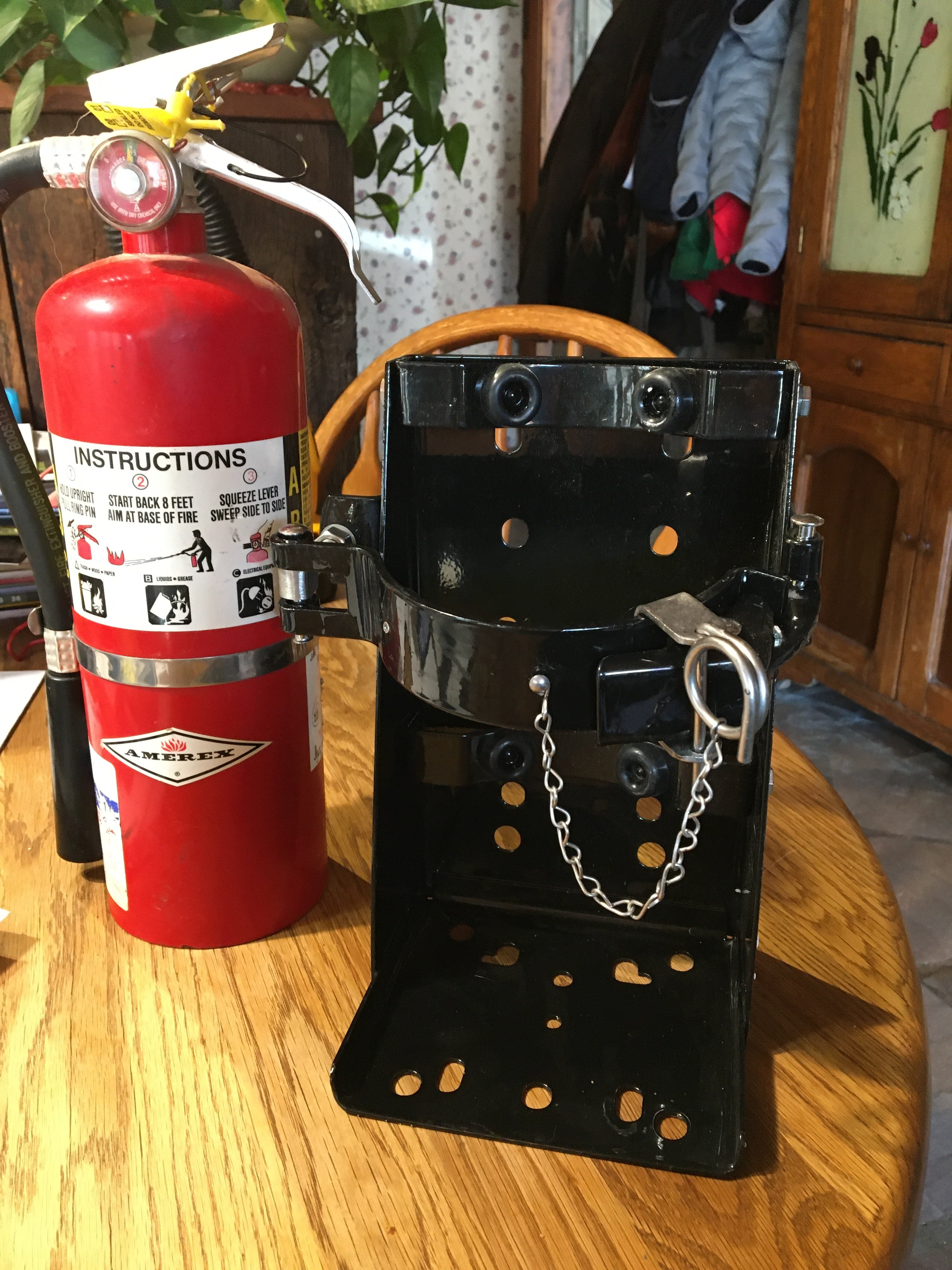

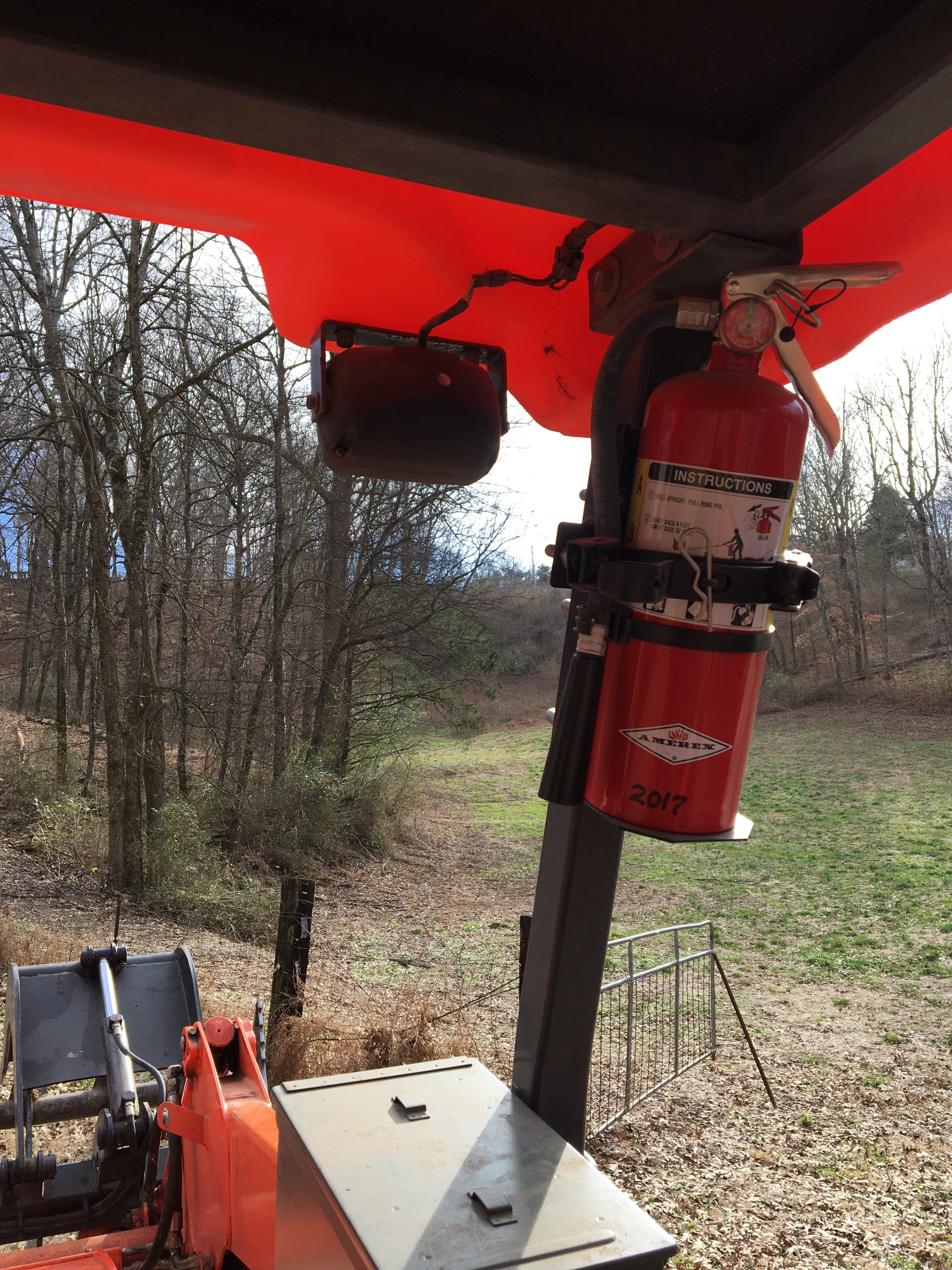

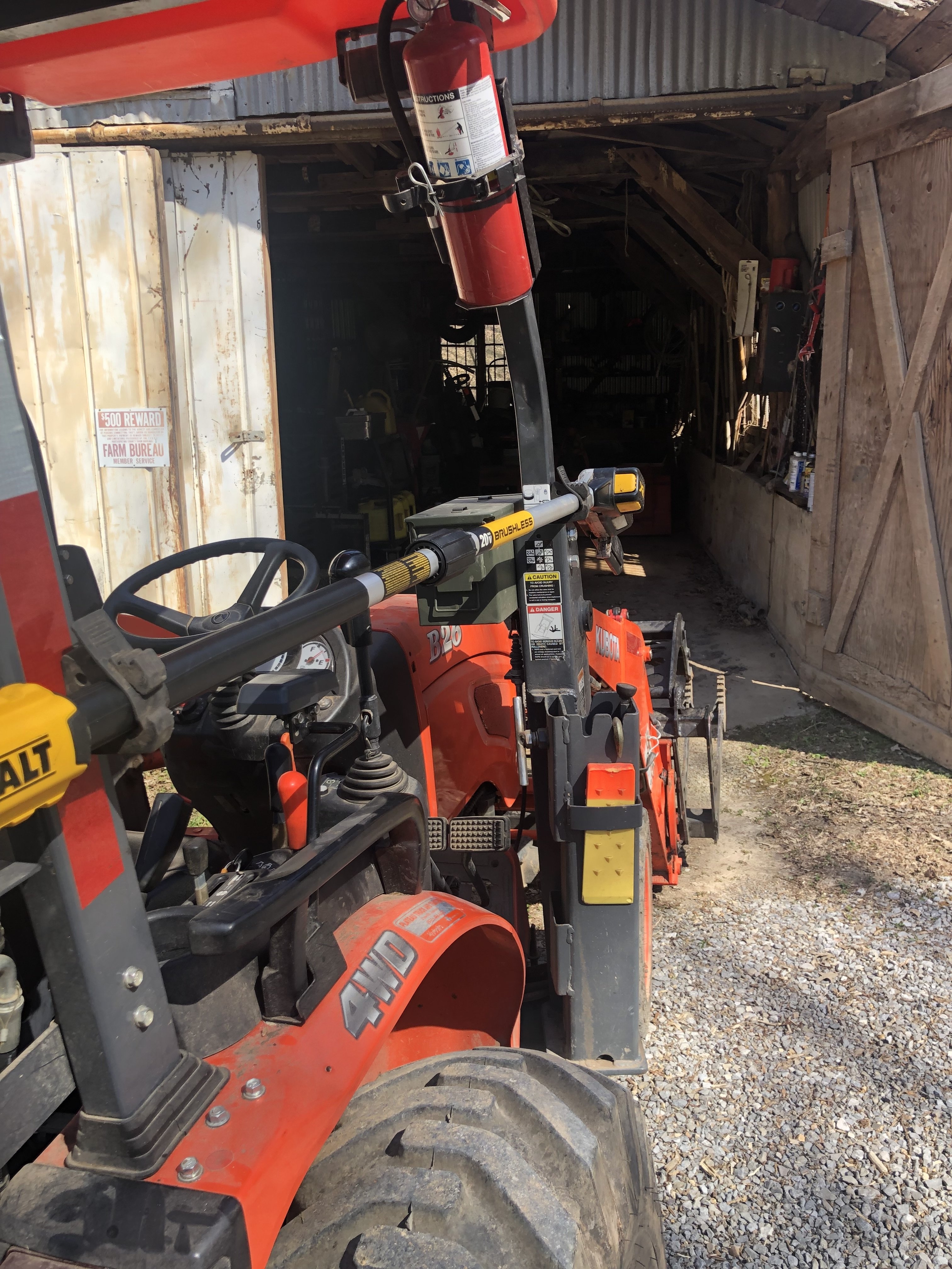

Think what I bought was Amerex 809 brand. Both tractors, farm truck and RV in 2017. Now I see Amazon has many more choices like Amazon.com Watch their pricing as they can really drop sometimes.
Always being brushed by trees when mowing it has withstood abuse. Added a little rubber washer to the pull pin to secure the handle pull pin.
On this forum someone had posted a recall notice from Kidde. I had 4 10# fire extinguishers 20-30 years old, taken out of service because the gauge had fallen out of the green. Contacted Kidde, sent UPS to pick them up and drop off 4 new all metal valve handle ones.
We practiced fire extinguisher training where I worked. With a little training, quick action and working equipment you can stop a little fire from becoming a catastrophe. With tractors working in dust, hay, spilled fuel, dry woods, barns, sheds, old vehicles just makes since to have a little extra protection. Never needed to use one but have neighbors that have lost tractors and barns that wish they were better prepared.

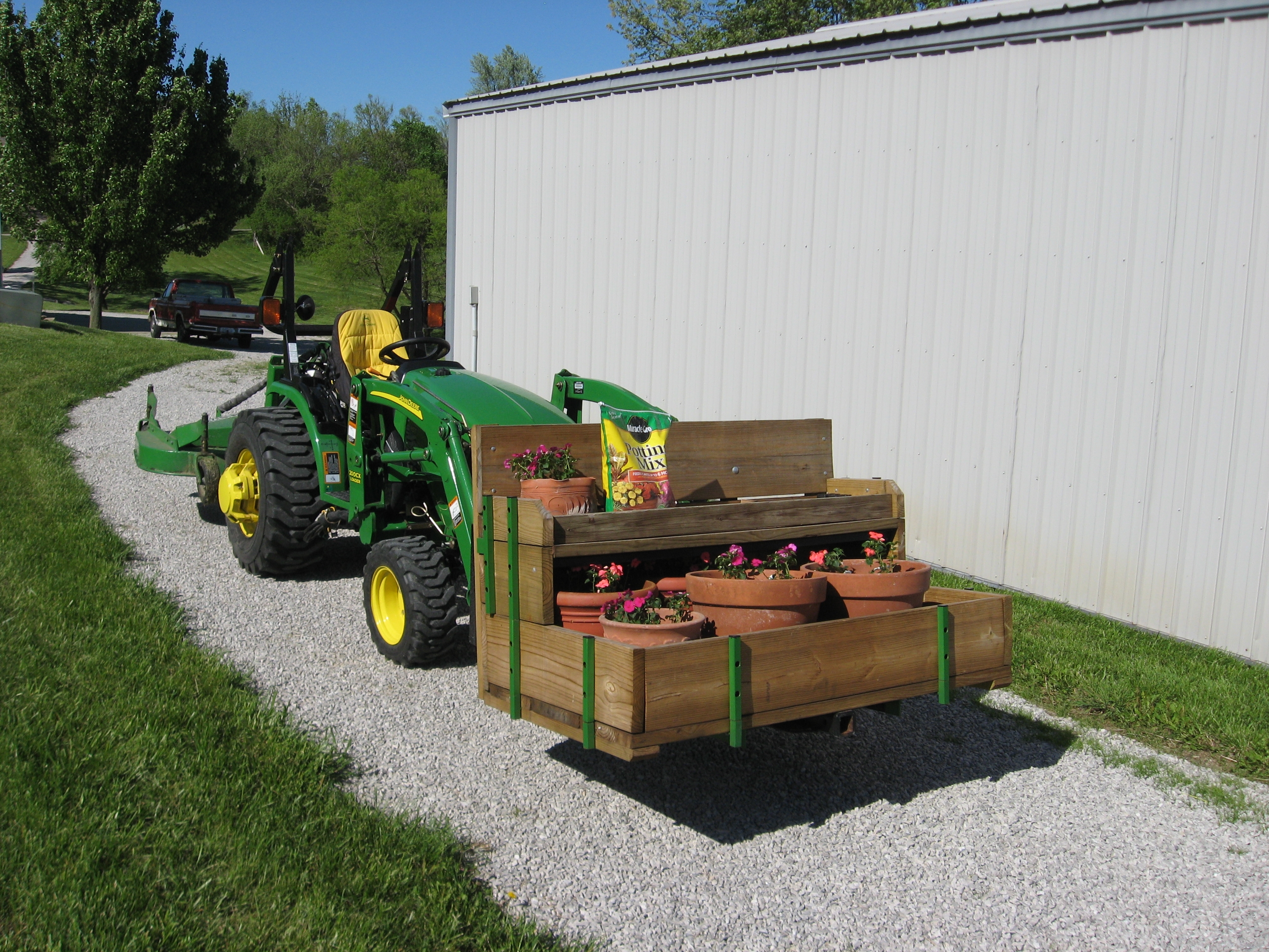

When it's not carrying flower pots, I frequently have this carryall on the front quick hitch full of chain saws, etc.

Looks like something you'd see at a pro garden center or nursery.

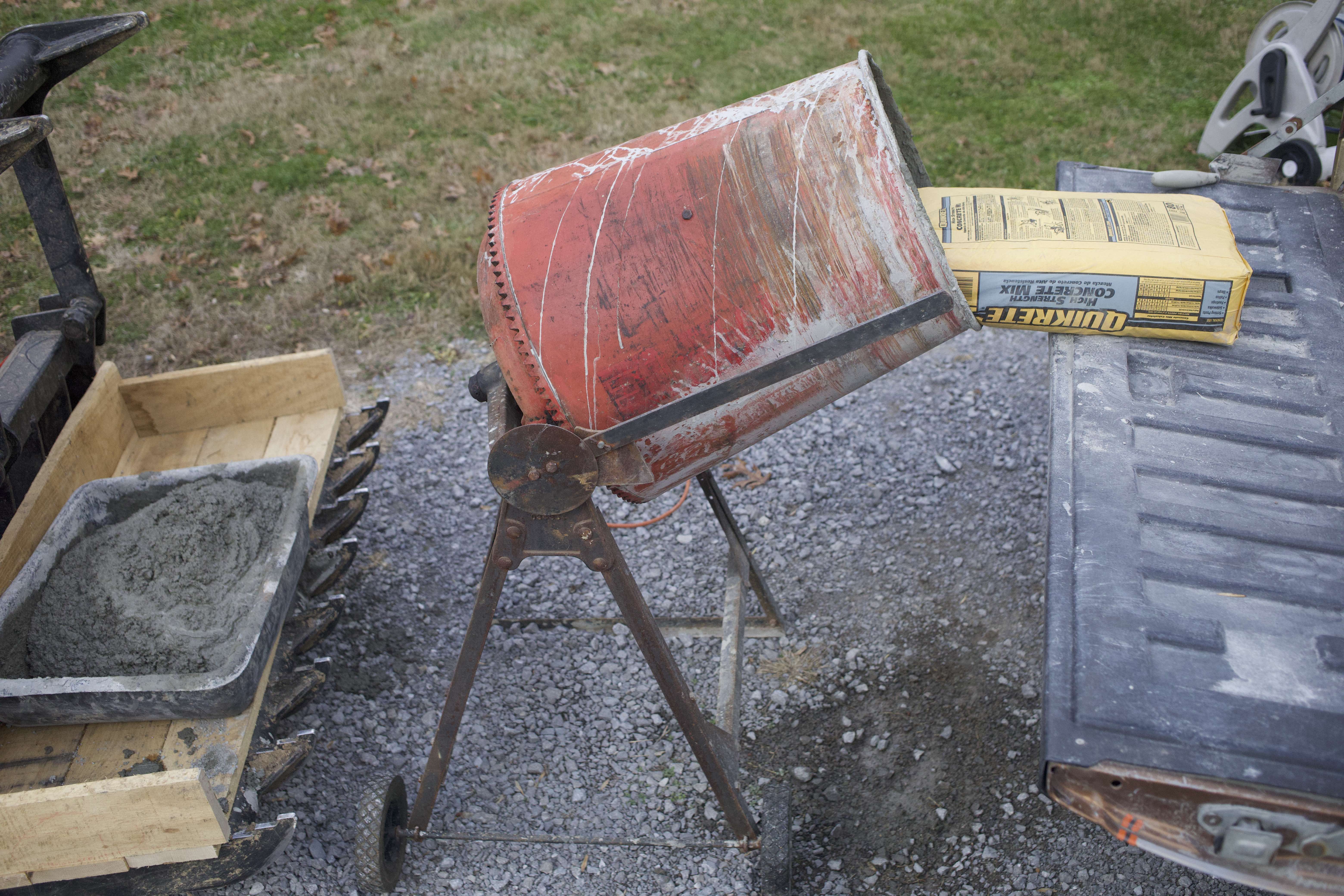

I needed to move some rock for a project. Hate the sound of rock clanging when thrown in a metal bucket. Built a wooden box for my grapple on the Kubota so I can just lay the wood box in the grapple when needed which eliminates the noise and avoids having to change SSQA implements.
Here's a picture. When I need to mix concrete, the bed of my truck is about the right height to load it into the mixer without lifting the bag. After mixing, I dump it out the other side into a plastic mixing tub inside the wooden insert on my grapple.
While my grapple would also work for carrying chainsaws, etc., if I were to use it on my Power Trac, my intentions are to fabricate a different style of log puller for the Power Trac. So I'm trying to figure out how to carry my chainsaw, etc, on the body of the Power Trac.
But as a general tractor carryall, I like what you've done, Runner.

Thanks. The "seat/workbench" and sideboards are removable. I also use plywood sides to haul bulk material (wood chips/grass clippings/leaves) from time to time. There is also a 2" receiver hitch in case I want to use it on the rear 3-point and pull a trailer behind or need to use a D-ring on the front to pull a tree down.
