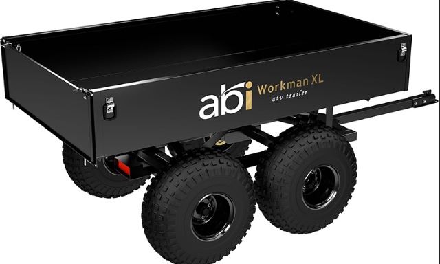

This one looks nice... Not sure on the price.

The problem with trailers having the bed OVER the wheels is that they are unstable, loaded, on uneven ground.
If you want a trailer to follow everywhere your tractor will go with 4-WD the load should be carried low, between the wheels.

Atv wagon is the same designed to tow behind an atv. They make them for ABI. Around $2100 delivered with 1500 lb capacity.
