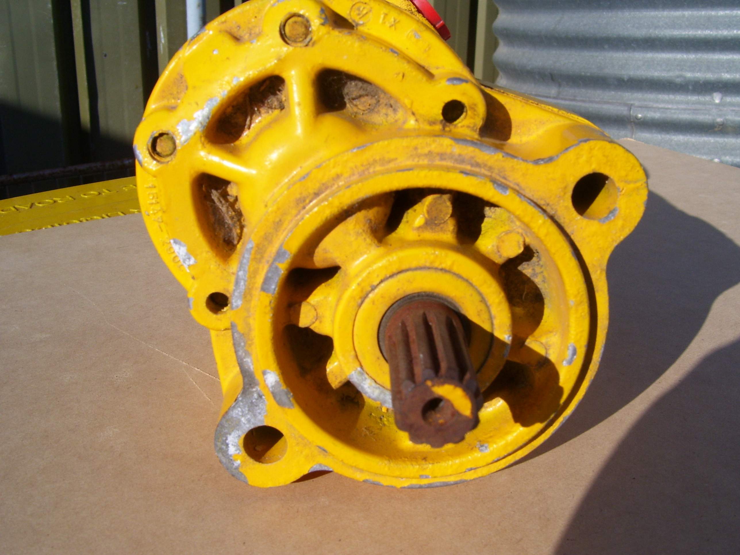

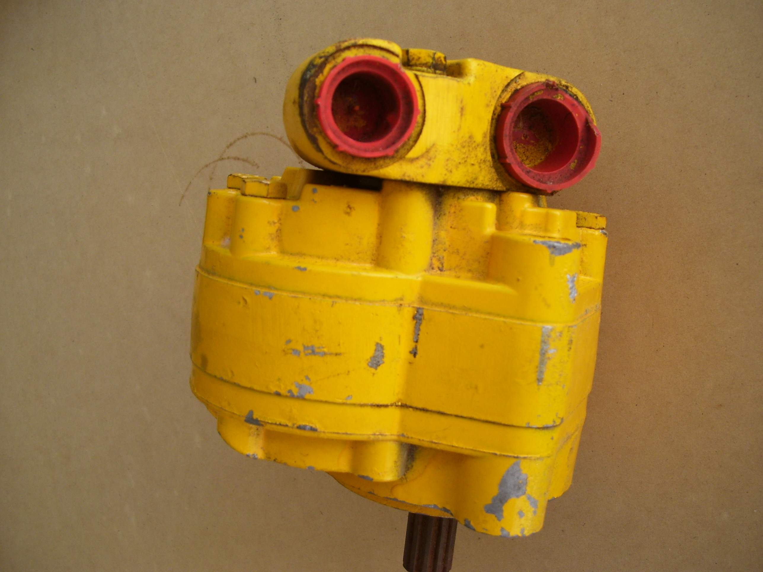

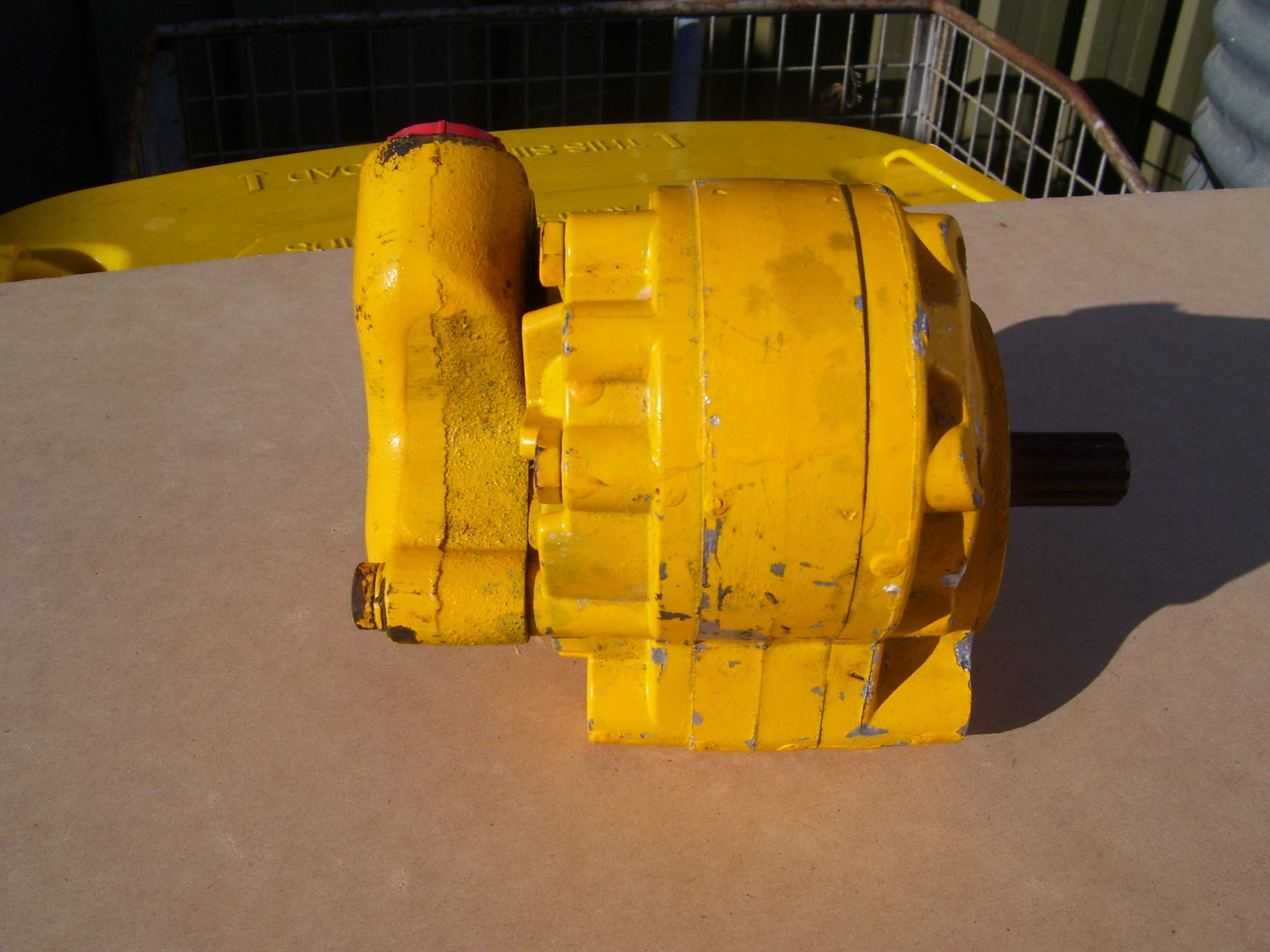

hey guys still slowly collecting for my splitter,kinda came to a hault for a while was saving to buy one but with xmas etc we know what happens to savings.
Anyway just scored another pump I have been trying to find info on it it is made by cessna and marked us patent #2809592.
All I can find is some old posts on google of people looking for one or parts as they were used on tractors.
It still has red plastic bungs in the ports so I have no idea if it is new or recond and whether it is single or 2 stage
It looks like it will take a pulley so that will eliminate expense of lovejoy couplers and an engine pump mount.
It was amongst a late friends bits and pieces he had been aquiring to use on his ferro cement boat he was building
so any info on the suitability of this would be appreciated or any better links to it's use than I have already found cheers and thanks

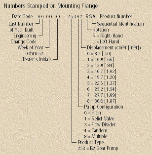

If your pump looks like this, the number should be stamped on the mounting flange and have a number like this pump number.#25500xxx The X's mean the type shaft, size, and direction of rotation. There may be an arrow somewhere on the pump.
Are you sure it is not a motor?
This pump is for right hand rotation. You would have to know before using it. Some pumps can be converted to run in reverse.
Surplus Center - 1.30 cu in CESSNA 25500RSC HYD PUMP
This is what the numbers on the Cessna pump mean.

No it doesn't look like that one JJ here are all the details I could find on it
US patent number2809592
alcoa x
made in the usa
cessna
15147-173c
6 27 gs+
all these numbers are on one casting
on top of that casting is the in and out ports
middle casting has no numbers
shaft side casting has numbers k20644ij and a directional arrow
with numbers15147-290c
also two small symbols and x1
it is painted yellow which made me think of caterpiller
and in the inlet and outlet casting is writing i can not read probably cast when it was made
so I dont know if I have a pump or a motor found this link but he didn' get thepump info Allis Chalmers Discussion Board - Re: Front mounted hydraulic pump on Allis Chalmers

Allison-Chalmers and later Deutz-Allis used Cessna gear pumps on combines throughout the time I worked for them 1967 - 1989 but they were always left untainted or painted black. When I moved to Cat I fell back on a Cessna pump for a machine when the original one we planned for the design wouldn't handle the job and the Eaton rep came through for me with the old Cessna design I had been so familiar with through the years. Eaton had taken over Cessna's hydraulic division by then. At Cat they were all supplied to us in Cat yellow; however, the pump we used was similar to the one in JJ's post. The ones like JJ posted - we usually ran them on our combines belt driven, an extremely durable pump. At Cat we ran with a tapered shaft that fit a gear to run from the front engine gear train on a 3116 engine. Unfortunately I now don't have access to the Cessna numbers of any of those pumps.

hey guys about to try again to load pics the help I was hoping for did not arrive

well got the pics up

JJ excuse my ignorance but what is the difference between a hydraulic pump and hydraulic motor cheers
Most hydraulic pumps cannot be used as hydraulic motors because they cannot be backdriven.
The input port on a pump is usually larger than the output port.
A motor will have equal pressure rating on the input and the output port.
A motor can be reversed.
Excerpt:
First Hydraulic Motor should be able to now, reverse, and therefore requires that its internal structure symmetry; hydraulic motor speed range required is large enough, particularly the minimum steady speed it has certain requirements. Therefore, it is usually with rolling bearings or hydrostatic bearings; second hydraulic motor oil due to the input pressure to work under conditions, which do not have the self-absorption capacity, but requires some initial tightness, can provide the necessary starting torque. Because of these differences, making the hydraulic motor and hydraulic pump is quite similar in structure, but not reversible work.
   / cessna pump
#9
Many thanks JJ your description lets me know what I have is a pump,next trip up to my late mates place I will look in the box that the pump came out of and see if there is a pulley in there that matches the 11 spline drive cheers and thanks
