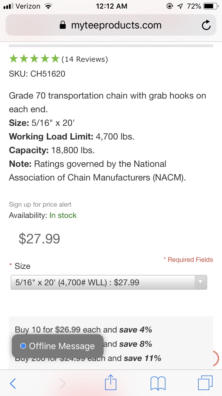

I didn't see it here, but Grade 70 chain has links stamped with the grade on it. Many lower grade chains do not, and do not require it. If the chains, hooks, binders etc do not have markings or permanent tags for the grade or WLL, the assumption of the lowest commercially available WLL applies.
I have a tool box on my trailer and keep 5/16 grade 70 chain, binders and hooks in there specifically to tie down the equipment. 3pt attachments get a labeled 2 inch strap each. Those straps and chains are for transport only. Its cheap insurance. Plus, who doesn't love chains? :)
/ Chain Grade #54
Another often overlooked part is a grade 70 chain with lower rated hooks or binders is useless.
