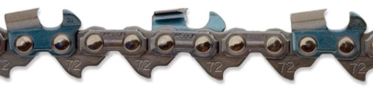

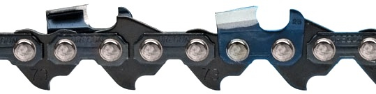

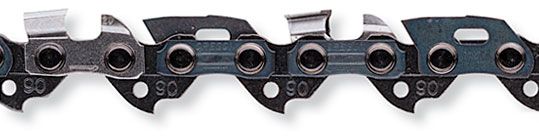

As noted in my description, Oregon does not consider their LPX series to be "safety chain". As you noted, the extra ramp next to the depth gauge does help reduce vibration. However, it does in fact also reduce kickback energy should the "kickback zone" at the tip of the bar come in contact with a log. ORegon specifically lists that "Bumper drive link" as a kickback reduction feature. From the description in their brochure on LPX chain: "• Ramped shape helps reduce kickback energies • Smooth cutting action"
If you imagine that chain bent around the radius at the tip of he bar, that ramp fills some of the gap between the teeth, pushing the chain a bit further out of the wood than it would be otherwise.
I remember reading something about X-grind a while ago, but Oregon's descriptions of the LPX and LGX chains do not mention it. IS that something that is associated with their newer EXL chain?
BTW, the extra hook I was speaking of is not shown in the photos. It can be duplicated by just sinking the round file a little too deep when sharpening.
Just went and looks at the Oregon products page and they list the X- grind for the series 20 and series 70 LPX chains and the 70 series LGX chains.
Found it here Oregon brand 3/8" pitch chain saw chain for professional chainsaw users
Appears to be an older version of the oregon website, since it doesn't appear to include the EXL series which is listed on the current oregonproducts website, but no were does it mention X grind on the newer page.
Just confirmed that is an archived page from 2018 since it includes the catalog for 2018
