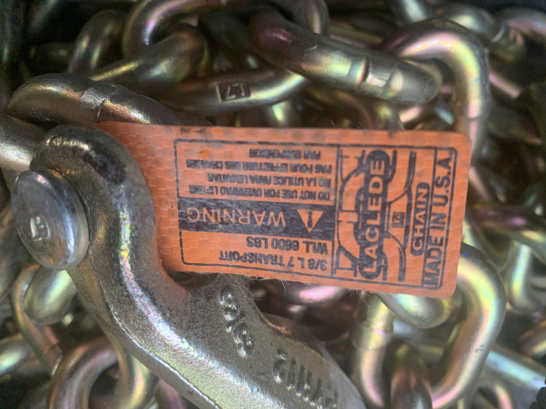

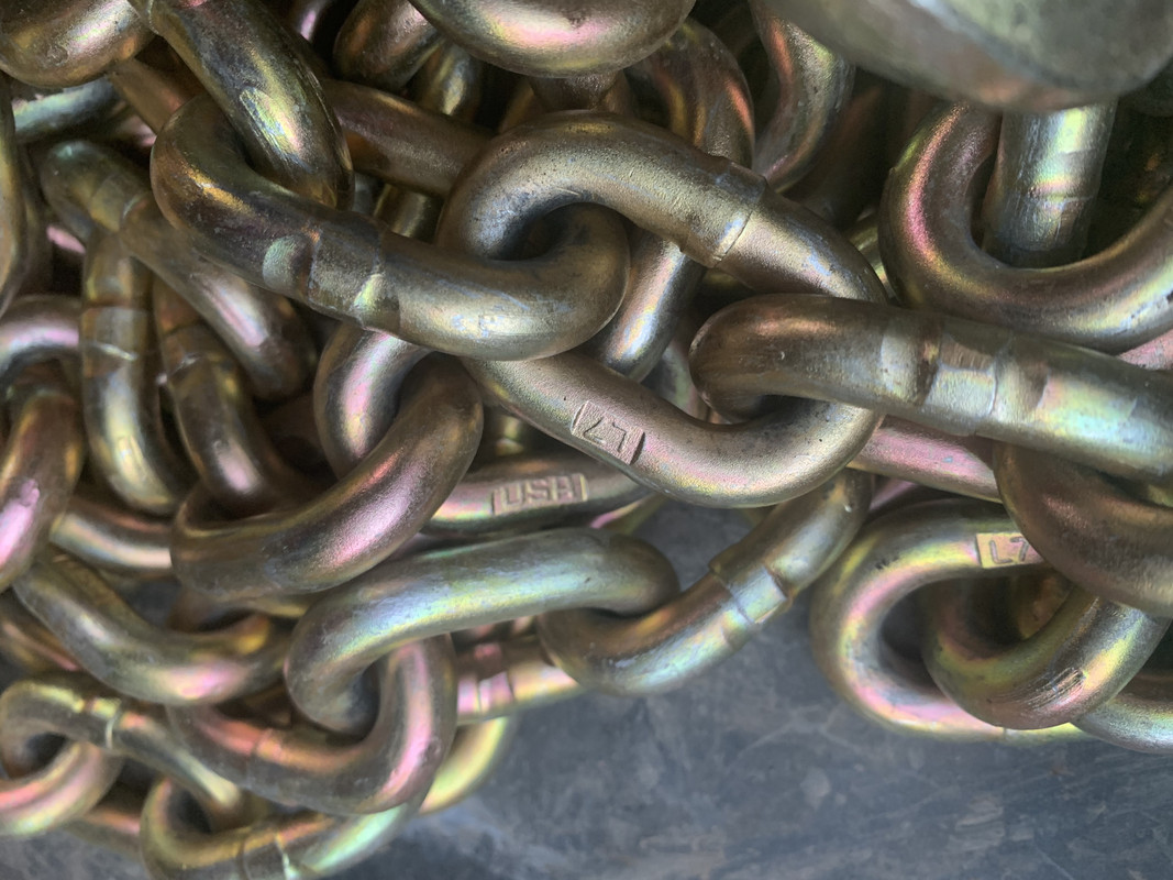

I use Laclede 3/8” G70 chain. It’s made in USA. Finding extra hooks made in USA is difficult, around here. On the internet, the made in USA books are around $20, each. I went with the Peerless Quikbinders. I hoped to find sone made in USA binders with a storable handle, but couldn’t find any. For loads under 10k, you need two tie downs. Over 10k requires four. Best practice is to always lower buckets to the deck and secure them, independently.
