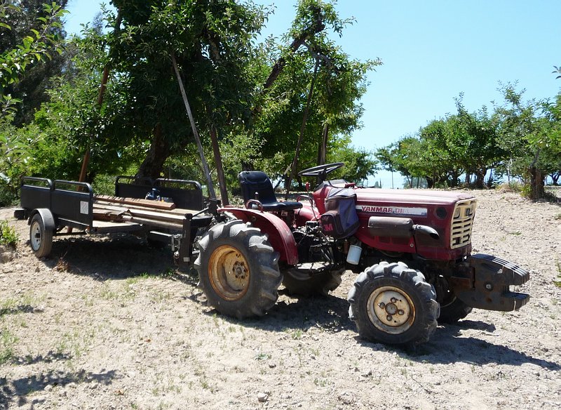

I added a kid-size golf bag strapped to the inside face of the right loader column. I carry the chains there now. (Two 12 ft chains).
I just found a photo. Here I used the bag as a holster that wouldn't damage my cordless reciprocating saw, that I use to prune dead limbs in the orchard. Normally the two chains and my long handle pruners ride in there.
I recommend this, it works well.

I looked up this old picture to illustrate my chains wrapped around the hooks on my loader. But I guess it illustrates your point too! :laughing:
I found that chains wrapped like this on the loader are a nuisance to untangle which discourages using them. It is a lot simpler to tug them out the top of my golf bag - they lift out without tangles ready to go to work. Any sort of vertical tube or bucket would serve as well.

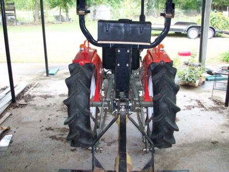

I think I am going the car doc route of installing a tool box behind the seat and between the rops vertical bars. The problem I am having is fab'ing something that doesn't involve drilling or welding to the bars. I am thinking of using some hose clamps that go through a couple of slices I can make in the tool box. Car Doc...did you weld brackets to your rops? if not how did you do it?
I drilled holes in my tool box and set it on top of the lower bar. I then used u-bolts to hold it to the rops. Your not suppose to drill a rops as it weakens it and could allow a rust location or spot for water intrusion.

Here is a pic of my toolbox. Just an old metal one i found around the farm. The ply is just 3/4" that sets between the toolbox and the ROPS. As i was worried the old toolbox sheet metal would flex to much with weight in it and or be to thin possibly from rust. The Ply just gives it a solid base. All of it is clamped up with the nuts on the u-bolts being inside the toolbox and either another piece of wood in there or large washers to keep them from ripping through.
