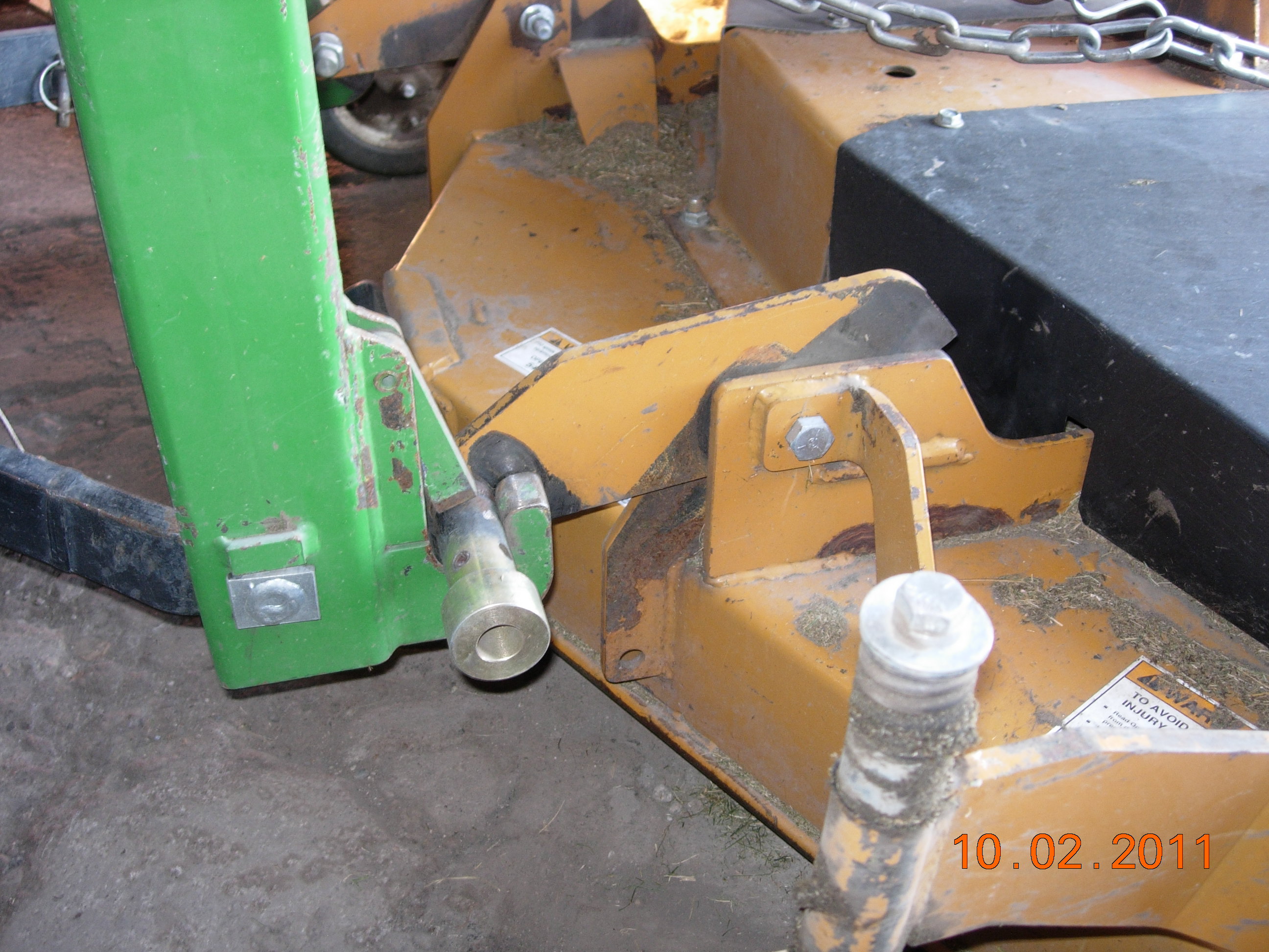

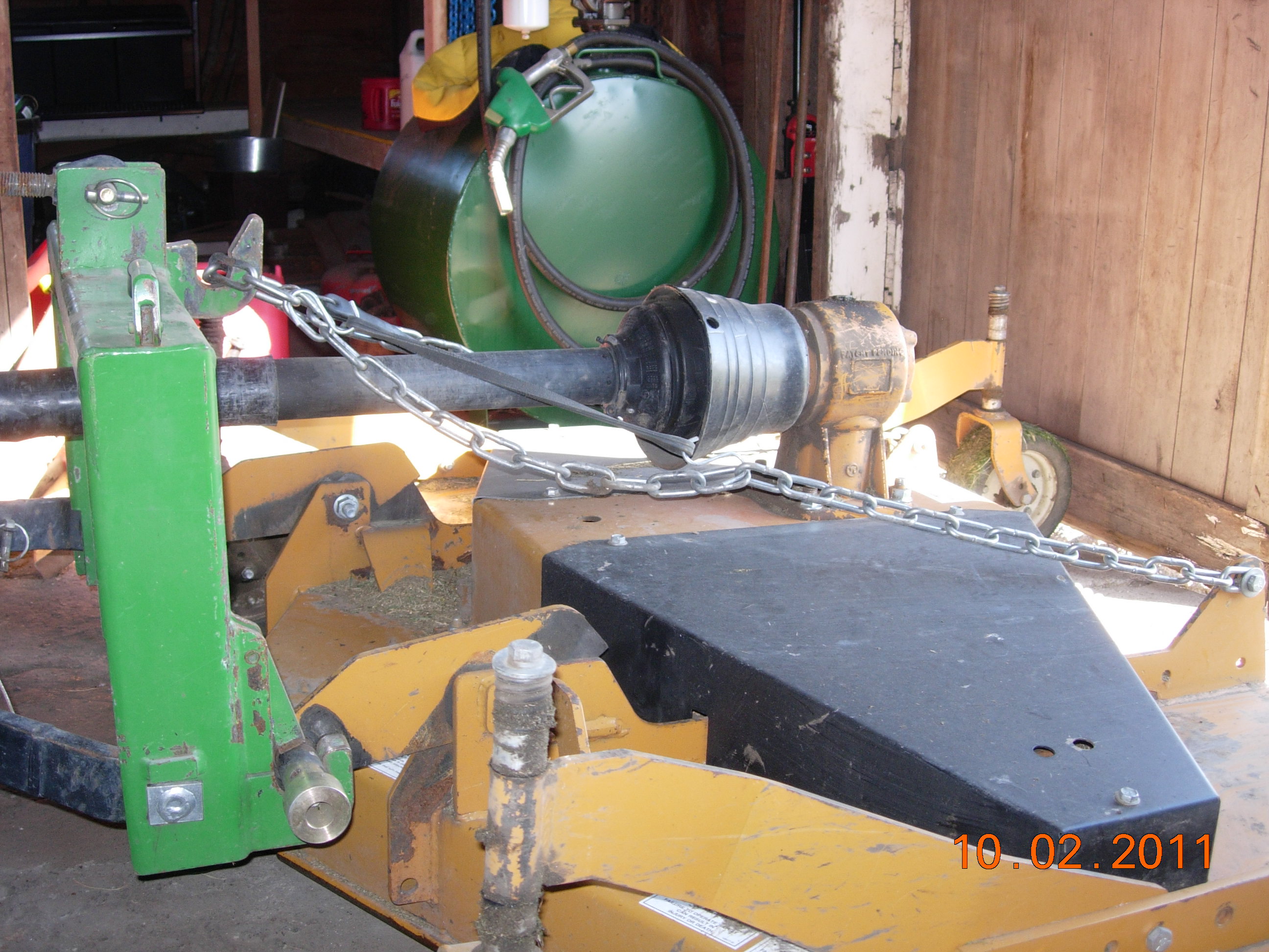

DSCN0265.JPGMy woods finish mower came with a chain and pivoting lower pin setup from the dealer. He said I would be happier with this setup and having used both the pivoting top and a chain I much prefer the chain. As with anything though, I think its all what you get used to.;)

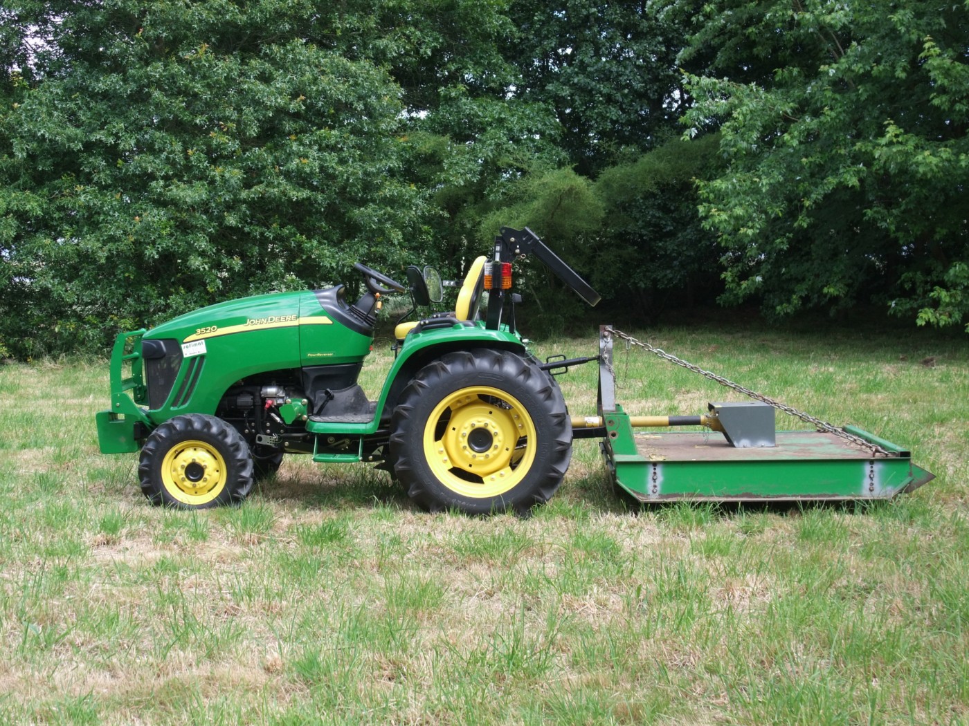

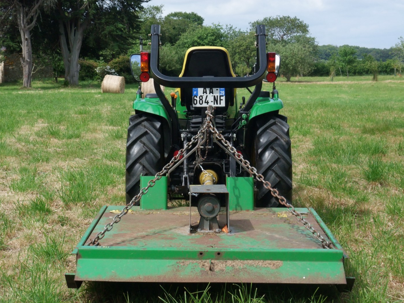

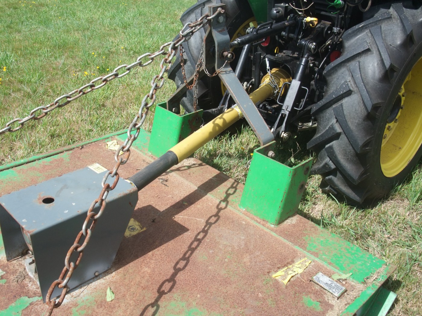

All our bush hogs here are sold with chains supporting the back to allow them better to follow the irregularities of the terrain. Never had any issues with that system.

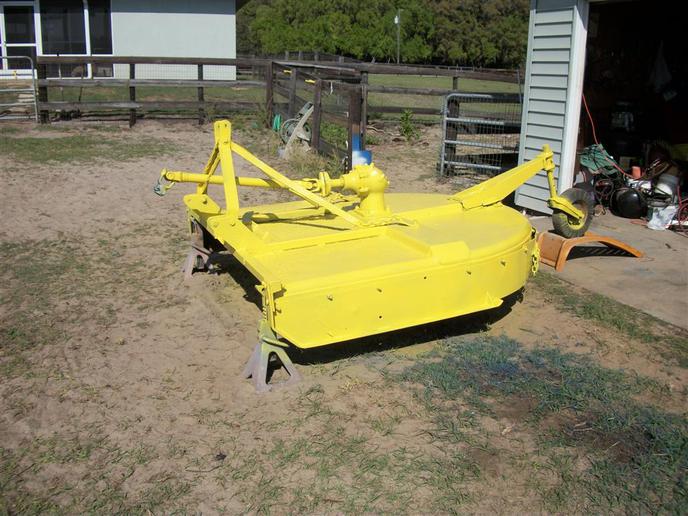

it's hard to see in this pic.. but I have an old servis mower .. probably from the 0's I'd say.. it has a small section of chain at the end of each of the bars that travel rear fromt he aframe, and the aframe pivots at it's base where the 3pt attaches.
real old beater mower I got for free.. did a bunch of welding and patching on. works ok.
tail wheel fork and mount had been broke from years of the PREV owner backing into things. finally got it all spabilized and welded up.
it's the mower I use when reclaiming 'non clean' areas at the back of my property.

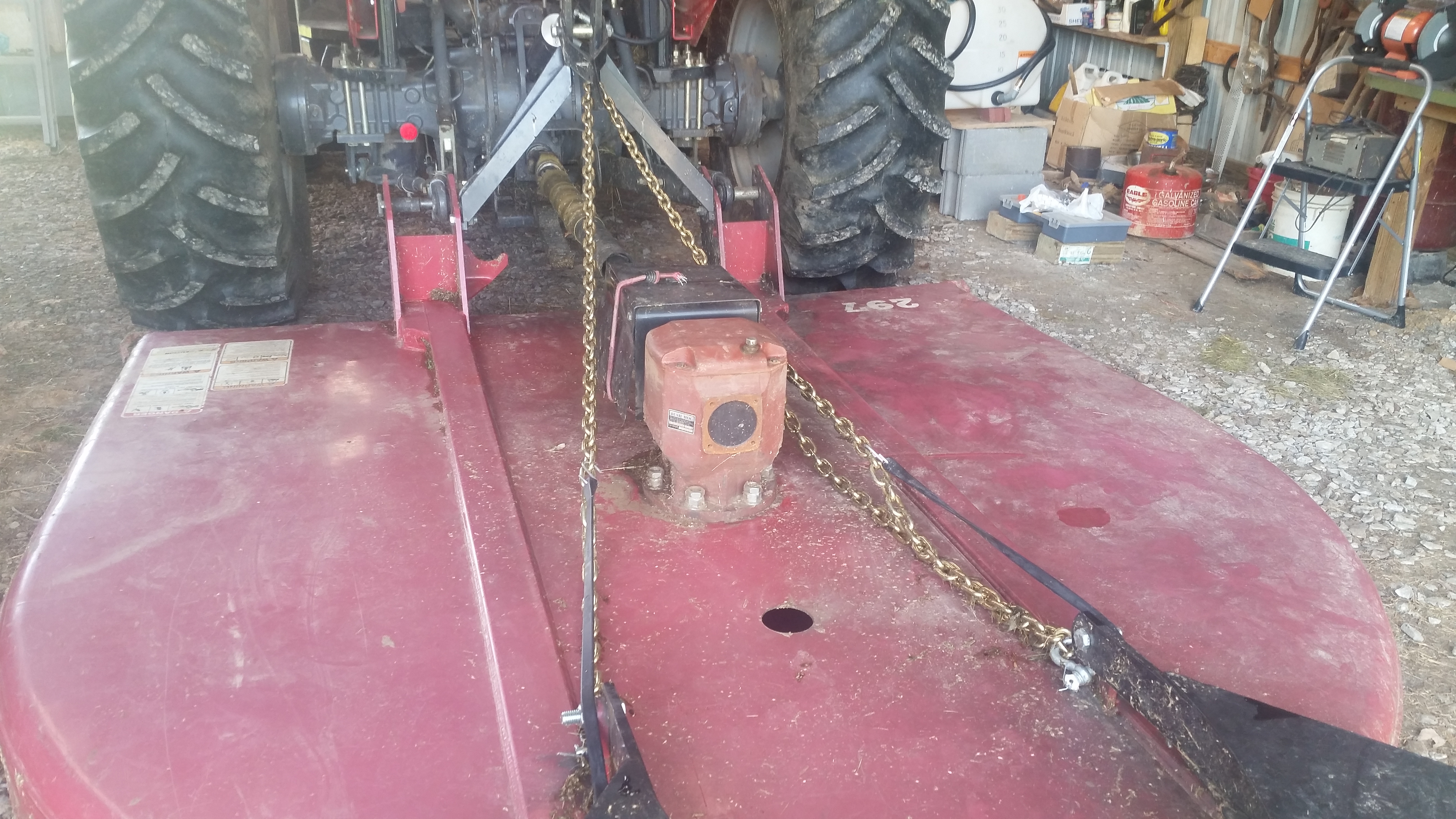

If the implement is set up like my Frontier (Woods built) RFM, the implement would pivot around the lower links while the A Frame remains vertical.
If you have a Quick Hitch, replacing the threaded upper link with a chain would be moot...in fact, the QH would pivot toward the tractor (not what you want). The chains running from the A-Frame to the cutter's deck allow quite a bit of movement and flexibiity.
Although I don't think a cutter would flip up enough to injure the operator, there is a possibility it could flip up enough (or the operator could back up a steep enough embankment) to fully collapse the PTO drive shaft. This could damage the tractor's PTO, the implement gearbox, or both.
A solid upper link would prevent that...
I'm liking this set-up more and more.

I had broken one of the straps that were the original links between the top of the A-frame and the back of the hog. 1/4" steel maybe 1.5 in wide. Broke where hole was drilled at factory for unknown reasons, maybe to hold the instrcuction book tube ? To get by while having welding done, I made up these chains in the pictures above. They work so well I will not put the solid straps back on until / unless there is some future motivation to do so.
