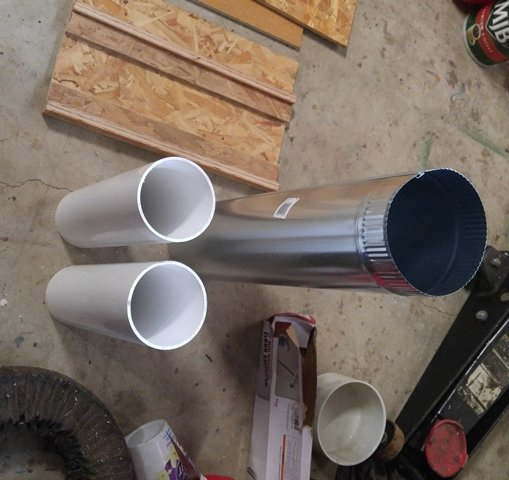

There are a great bunch of threads and posts on this subject here, but I like to try my own thing.
This is my version of a home made chainsaw carrier.
It is made from PCV pipe I molded in the shape I wanted.
Mounted with all-thread I bent and covered with tubing to prevent vibrations.
The start of the project.
The setup.

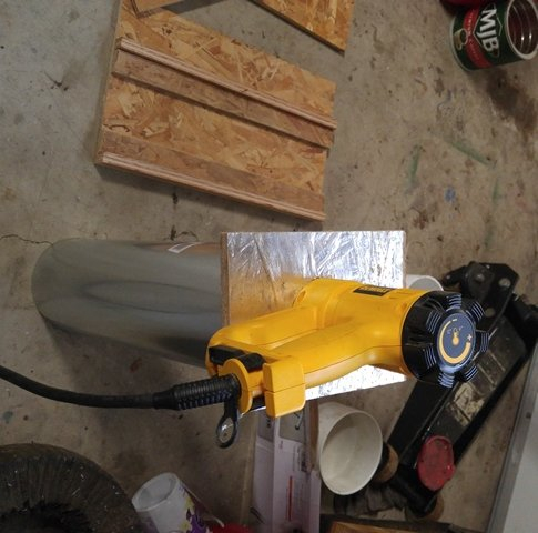

4" PVC pipe, stove pipe as heat chamber, and the mold.

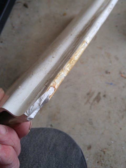

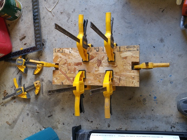

My first attempt did not go so good. On the mold I left 1 side long so I could make it wider if needed.
This caused a problem with the clamps not getting good pressure. I also burnt the end of the pipe, but still did not get it hot enough, which caused it to crack.
I cut the mold side down, and adjusted my heat times. Try 2~3 worked great.

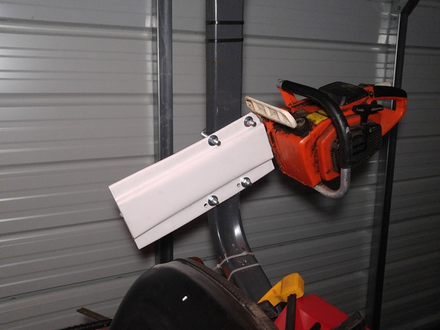

I mounted one to the ROPS with the all-thread I bent.
Only time will tell how well this position will keep the saw inside it, and if the PCV will hold up.
If it does, I plan to add the other one on the opposite side.

I can't say how hot it actually was. With my Dewalt heatgun set to high heat and low airflow, I heated for 2 minutes, then I turned it over inside the pipe, heat for 2 min, turn, 1 min, turn, 1 min.
At this point the PVC was slouching inside the "oven". Any more and I was afraid it would collapse onto itself.
Working time is not long. Maybe 3 minutes. But once I had a system down that was not an issue.

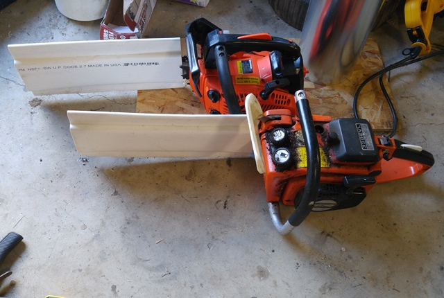

Pull it out of the pipe, lay it down in the bottom, insert the inside spacer and press the spacer down into the groove. Clamp the ends of the insert.
Roll the sides out as evenly as I could, and placed the top board on it. Clamp it for about 8~10 minutes.
The ends were misshaped a little so I cut them off.
Another thing I noticed is it shortened in length. I lost approx 1"~1-1/2" of length before I trimmed off the ends.
18" to start, -1" shrinkage, -1/2" trim (1/4" [+/-] off each end).
It worked out OK because my saws are 16" and 12".

First test, success.
Today I ran the tractor cleaning up branches and I also did a little brush hog work.
The saw stayed exactly where I put it while I was going into, thru, and out of brush/ small trees, and as branches flexed around the ROPS then slapped the caddy. No signs of wear or stress on the caddy after 6 hours of work. By 2 hours in I kinda just forgot the saw was even there. But sure enough when I needed it, there she be sitting nicely in the caddy.
The saw also stayed put while I was brush hogging. I thought the the bouncing over the ground might cause the saw to come loose or slip out a little. Nope!

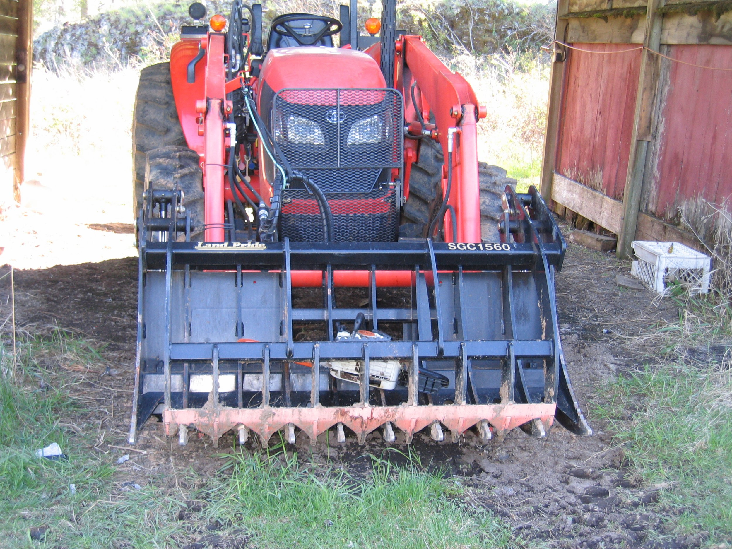

This is mine. Kind of expensive but, fortunately, it has multiple uses. View attachment 692675
Lol right until you forget it's in there, and grab a log and smush your chainsaw on it. And then dump it out in the log pile. Lots of stories about people forgetting what is in the bucket until you go to use it. I put all my tools into a dirt pile once.
/ Chainsaw Caddy (carrier) #19
Lol right until you forget it's in there, and grab a log and mush your chainsaw on it. And then dump it out in the log pile. Lots of stories about people forgetting what is in the bucket until you go to use it. I put all my tools into a dirt pile once.
Everyone including me throws tools in the bucket, heads to to job sight and says "must remember that", then 15 minutes later grabs a bucket of gravel. For me, not do that again. :LOL:
