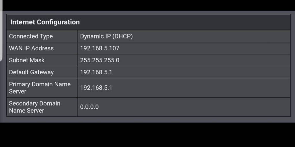

Not particularly happy with this GLAR150 I have, except for it's price. It simply not as stable, and I want to port forward for security camera reason and can't make it work.
If your connection is similar to mine, a tracert shows two private subnets before getting to the first public address, so the chances of making an uninitiated inbound connection are very slim. One of the reasons the service is inexpensive is because users don't consume public addresses.
   / Cheap $20 a month Stand Alone Unlimited Rural Internet through AT&T Wireless #810
That occurred to me the cellular connection is a problem doing that.
