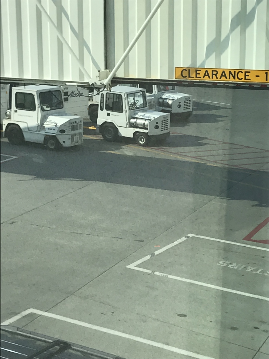

I noticed this at an airport. Millions of gallons of jet fuel is apparently not a big deal. A few baggage trucks that are probably 50 hp or less has to be propane... IMG_7213.JPG

I noticed this at an airport. Millions of gallons of jet fuel is apparently not a big deal. A few baggage trucks that are probably 50 hp or less has to be propane...View attachment 618748
The baggage trucks drive indoors to unload the luggage. People stand next to them all day long, propane exhaust is a much better option health wise.
