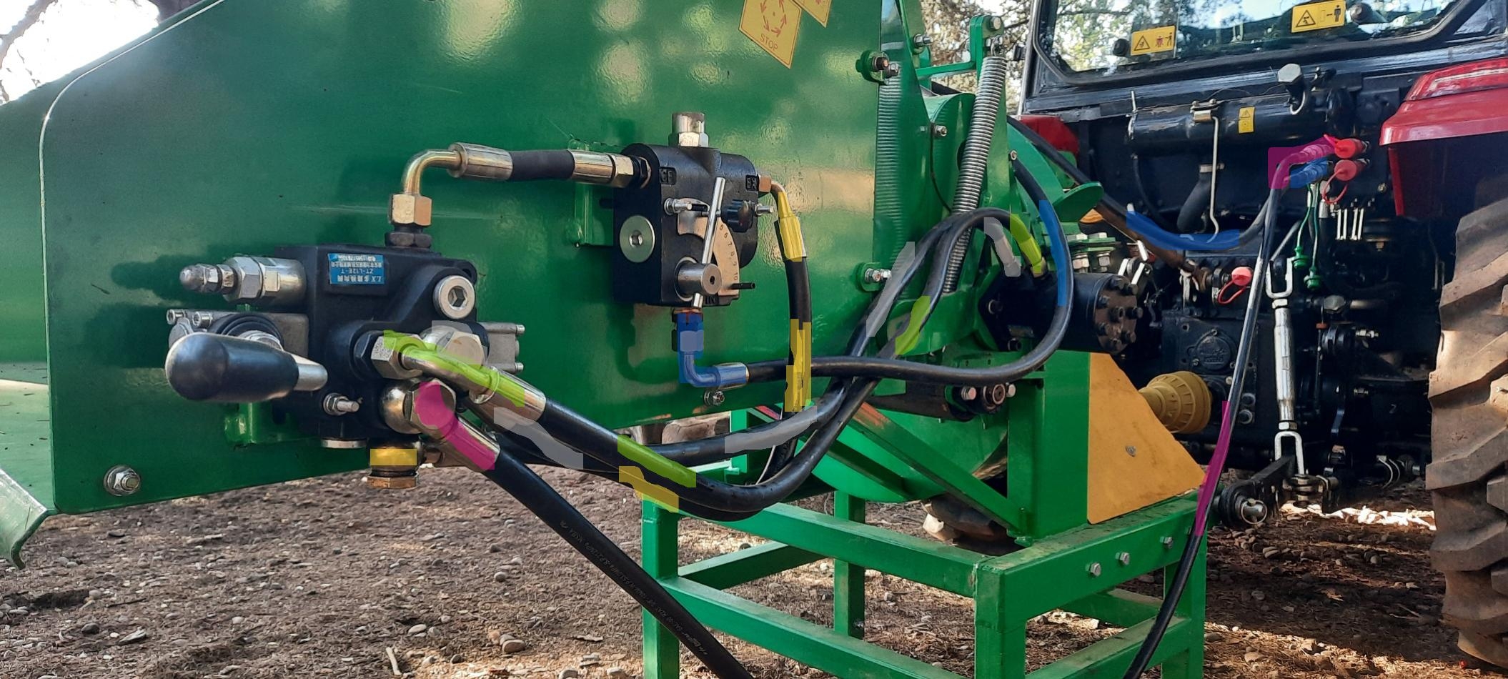

DFKRUG, You suggest I now disconnect the 2 hoses at the chipper and put them into a bucket?
From what I´ve read on this forum I should bungy the auxiliary shifter in the front or back position.
Then start the tractor and see witch hose the fluid flows from and connect that port to the valve that has the shifter. The other port to the speed control.
IS THIS CORRECT?
   / Chipper hookup to tractor hydraulics #22
IS THIS CORRECT?
I can't see from your pix: is one hose from the flow control valve connected with a TEE at bottom of the spool valve? Maybe you can annotate your photo with letters or numbers on each hose.
If your AUX valve is not detented, you will have to use a bungee cord or something like it to hold it in one or the other actuated positions. You have to find out where the OUT work port is. 2 open hoses into a bucket will do that.
Dunno what you mean by "shifter". Label your valves on an annotated photo.
#23
I see no T´s, Shift is part of my ignorance, meant auxiliary lever.
Took a better picture and tried to mark them.
Hope it helps

OK, to me it looks like blue is the supply from the tractor, and pink is the return. Blue goes into the flow divider valve, with excess fluid going to the return port of the spool valve (yellow). I think that the spool valve has two return ports, where pink and yellow are connected, which acts like a tee. You should verify that, perhaps using air.
The short unmarked hose is the IN hose for the spool valve. To the left of that IN port is the adjustable relief valve.

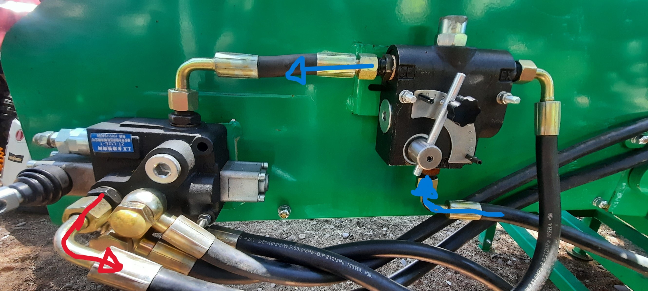

Is this how it should flow?

Late to the party but, yes.
Also that lonely single fitting is a return line to the tractors housing.
If you use that for the return from the splitter valve, then you can connect the inlet hose to any of your rear remote connectors and as soon as you move the right control the correct direction everything will work.
Using the remote return line simplifies the hookup.

Do you mean the fitting circled in white?
How does it simplify hook up? excuse my ignorance.
Pink goes there?
