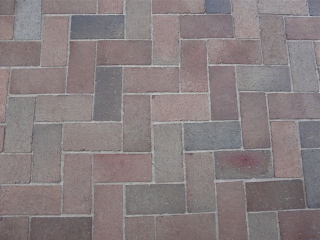

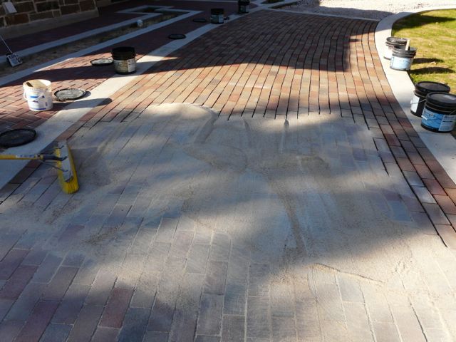

Thanks Brandi and Kyle!
Beautiful day to finish up the first 1300 pavers in section one. I got all the leaves out and did one last leveling/spacing and then spread the polymer sand and then tamped everything one more time. The instruction call for a light mist 4 times, ten minutes apart which I did.
On to section two, 8,700 pavers to go!

I have never seen it done like that using spacers, Can't see how that would be a recommended method of installing, being so slow. Most pavers have the little bump on them for that. You are one very determined person, I would not have the patience for that.
I know you did some research, and I'm no expert on the matter, But I would think that you would want direct contact between the units, especially for vehicle traffic dynamics. Poly sand is only good for a period of time then breaks down to just very fine sand, at least it does here in the northern region. That would leave the potential for the pavers to move around.
I do like your choice of the color, but I would of went with a larger unit size to speed things up.

JB, I'm wondering how it will hold out over time with traffic. I am taking extra time for packing the ground and gravel underneath. The spacers would not be needed if it was a smaller area. All the points you mention sound like you are experienced and I would do it differently next time, especially the spacing part that takes too much time.
The next section is has more of a curve to it and the slight turning of each paver will be easier with the space to play with. I hope.

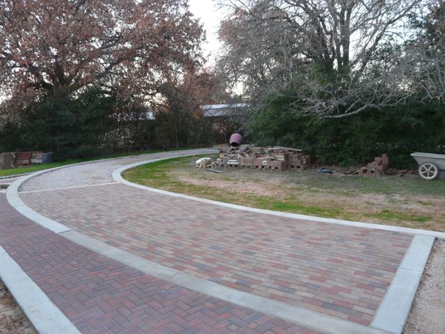

I have 87% more pavers to lay and need to pour six more cross cement dividers, and one drain to install in the middle of one divider. Oh yeah, the last part of the entrance will have to be cemented, I'll call a truck out and Ron and I can spread it. As usual, I should have estimated how long it would take me and then doubled it.

Don, did the rains erode your progress?
The polymer sand in section 1 was solid and did not wash during the quick 4" downpour.
I cover section 2 yesterday after I leveled and tamped it several times. No redo damage just a little rain delay.
