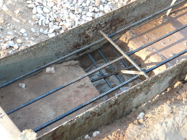

Can you provide more details on materials used for forms for curbs? Did you use trencher or dig by hand?

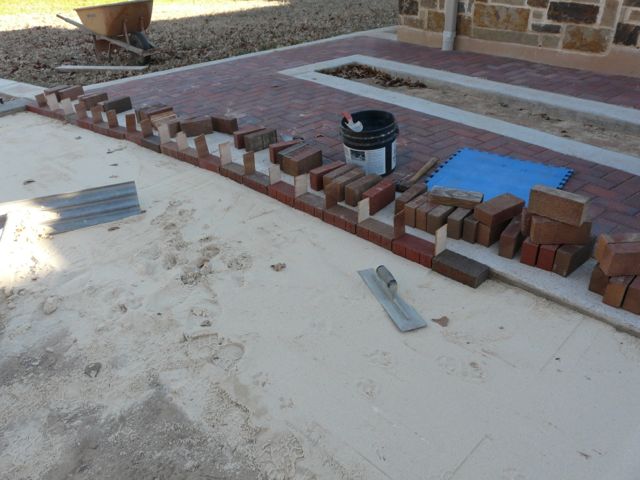

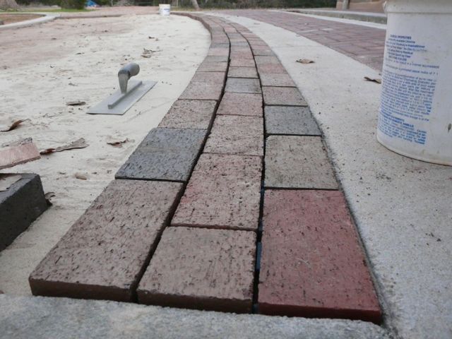

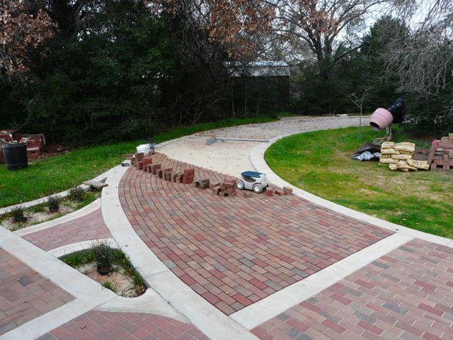

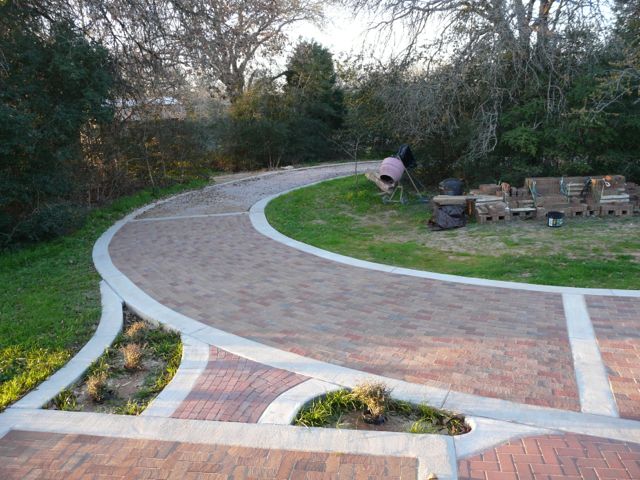

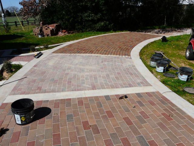

Finished section 2 (of 8) today.
pic1 - half of the pavers laid
pic2 - sweeping in the polymer sand
pic3 - finished

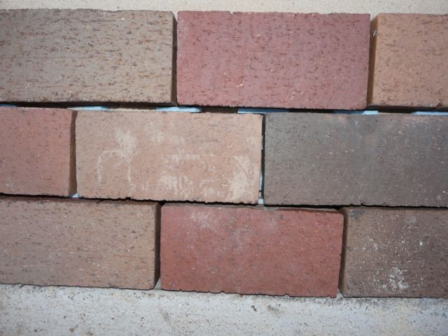

pic4 - inspected

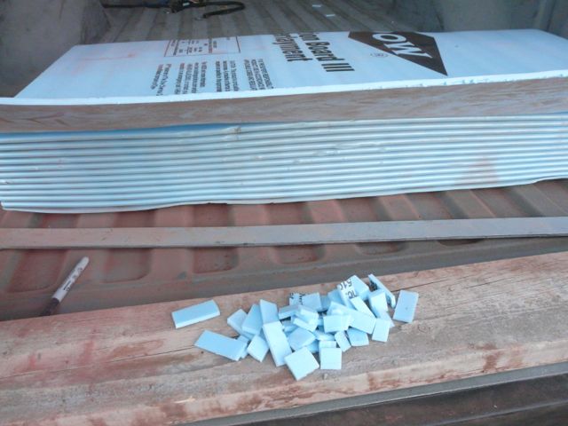

Eddie, actually I try not to think about them, maybe that's why every other project interrupts the paver project. 2,500 laid 7,500 to go.
I got it down to just 2 spacers for each pavers and then spend about an hour right before the pouring of the sand correcting any obvious spacing problems. On this section I had three rain delays and a knee injury so it took a little longer.

Thanks, my knee is getting better. That little rolling cart on the first pic was a knee saver rolling back and fort and back and forth etc...

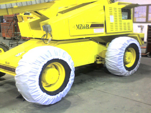

Do they make slippers for tires? Something that wont scuff the pavers? :laughing:

Eddie, I found the slippers by googling tire booties. I like them!:D
/ Circular paver driveway #98
Hopefully you can buy them in bulk and have a porch area before getting to your driveway so guest can put them on!!!
