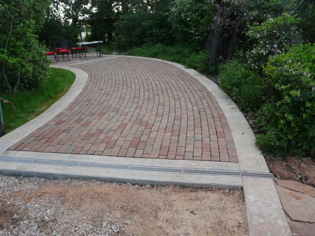

Looking at it again it's kind of like a "R". The "R" has short fat unequal legs and long top part with a slightly curved forward back. The legs are the entrance and exit points. I'll get the inside and outside measurement from the top part of the "R" tomorrow.
   / Circular paver driveway
#52
The outside measurement of the circle (including curb) is 72' 10" and the inside is 48' 3".

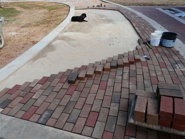

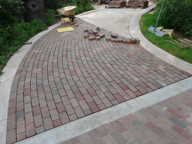

Kyle, doing good, slow but good. I was going to take pictures when I poured the sand today but the sprinkle in the morning made the pavers wet. The pavers must be absolutely dry or the polymer sand will stick to the surface of the pavers making a big mess. By the time they did dry I was busy in the garden and I want a full day for this step, hopefully tomorrow section one, (of seven) consisting of 1300 pavers, will be complete only 10 days behind schedule.
Below is a picture of section one from last week when I was about 1/3 done.
I found about 6 different colors of the clay pavers in the stacks.
I'm getting slower at working and faster at playing. I'm running 20 miles a week and tonight I did my fastest 3 miles at a 8:22 pace and feeling good. :thumbsup:
