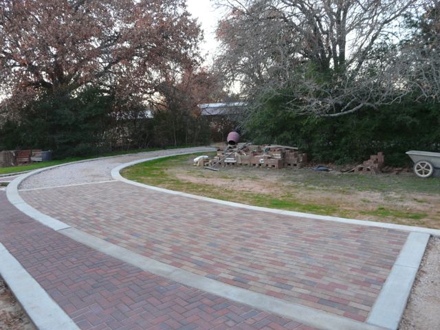

here is a good picture of where we are.
You can see the beginning of section 1 and the end of section 4.
I have enough pavers for only 3/4 of the remaining curbed in area.
The other picture is the stack of pavers I have left.
A decision will have to be made shortly on which stretching method to use and have it not look like a stretching method.:D

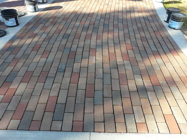

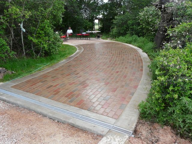

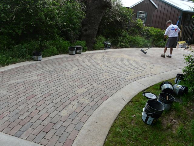

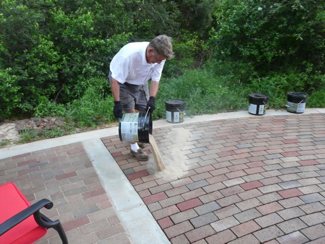

Today we finished section 4. YEA!
We hand tamped the pavers, recheck all the spaces, elevation and replaced a few that cracked. We then poured polymer sand and swept it in the spaces, hand tamped it all again to set the sand and re-swept it and then misted it.

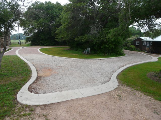

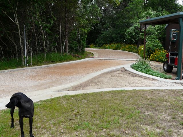

Today I counted pavers to get an exact (+ - 5) count.
There are 3835 pavers left and I have 90 feet of driveway left. section dividers will leave 88'. The drive is exactly 29 pavers wide and 3 pavers long covers 2 feet. That means I need 3828 pavers to complete the "O" only. I do not have enough for the slash in the Q. At my count I will be 7 pavers over.
To stretch a few I will put a 8'X20' cemented car wash pad next to the golf cart porte-cochere. It will be boarded by pavers on each side along with the slash of the Q to tie things together. I'll buy extra pavers for the compass rose which I will frame the boarders into the cement.
Below is a crude drawing. Green is cement red is pavers.
Thanks for all the suggestions, if you have any more now is the time.:thumbsup:

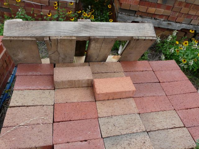

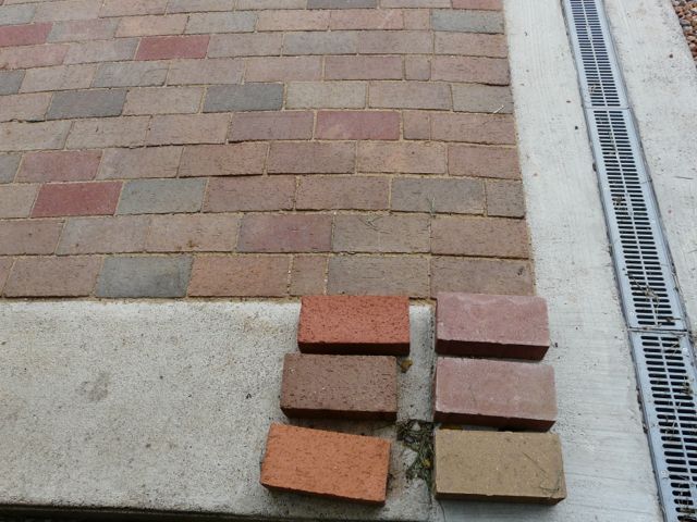

NEW PLAN! I found clay pavers.
Since Acme Brick (clay paver plant) shut down I was short on pavers to finish the drive. I just could not get enthused about pouring cement on the drive so I took out on a quest. I first went to Paverstone's manufacturing plant in San Marcus and they made only cement pavers, the right size and color but the texture was different. They referred me to Claymex in New Braunfels and there they were. They are making a batch for me this week!
// Claymex //
On the first photo the three on the right are Pavestone and on the left Claymex, I'll be getting the the top two on the left the lower third one is too orange.
On the second photo the two colors of Claymex pavers are on top of Acme pavers.
On third photo section 5 and 5.5 the one I'm prepping the drive for pavers now. (5.5 is a second exit/entrance ramp on the circular drive.)
