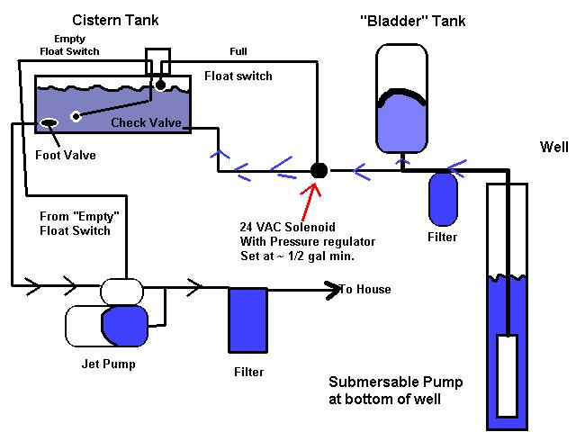

Attached is a schematic of how the basic system works.
We have been using it since this Saturday afternoon 3/11/06. So far so good -.

Well I can just not understand why you have a pressure tank between the cistern and the well just does not make sense. The pressure tank needs to be between the jet pump and the house. If not the jet pump is going to cycle on and off at very short intervals and fail very quickely. They are not designed for that. The pressure tank needs to be after the jet pump and allow the pressure tank to service the house as it would in any normal situation. It should look like this.

</font><font color="blue" class="small">( Well I can just not understand why you have a pressure tank between the cistern and the well just does not make sense. The pressure tank needs to be between the jet pump and the house. If not the jet pump is going to cycle on and off at very short intervals and fail very quickely. They are not designed for that. The pressure tank needs to be after the jet pump and allow the pressure tank to service the house as it would in any normal situation. It should look like this. )</font>
I have to respectfully disagree with that logic. Maybe you should CLICK HERE to learn about modern jet pumps, these jet pumps are designed for multiple cycles per hour.
The well can produce maybe 2-3 gallons a minuet with about 40-50 gallons reserve until it has to recharge. The jet pump has it’s own bladder pressure tank and is a Grundfos pump, very high quality, it is designed to cycle. The submersible pump it the one I really want to protect from multiple cycles and not running dry. Who wants to pull a submersible pump out of a well due to over cycling? No one except maybe a well service company. Having the pressure tank on the well and SLOWLY discharging the water into the cistern over a long period of time, ensures that the submersible will not cycle excessively and that the well will not go dry, overheating the pump.

</font><font color="blue" class="small">( The jet pump has it’s own bladder pressure tank )</font>
I don't think he meant to incite, You just left that part out of the diagram because it is a part of your pump. Some jet pumps have a separate tank, Mine has 2. Every system is different
