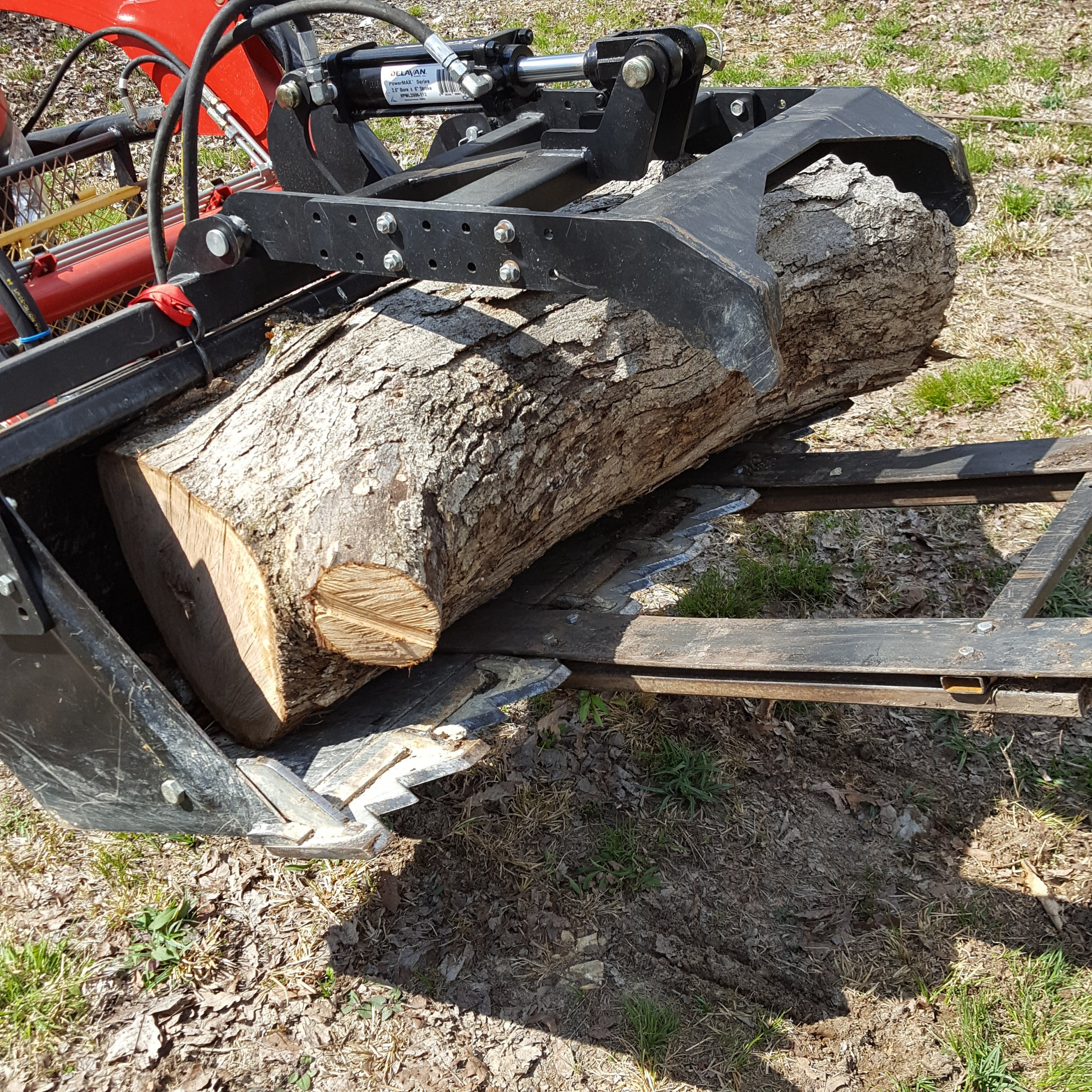

This is what I made for brush moving/hauling....Works well for small logs too....
dsc02207-jpg.707275
DL, is that square tubing? What size and wall thickness?

The problem I found with clamp-ons is if you want to load some-thing into the bucket, 48" log, lumber etc, it will stop at the clamps or if it goes over the clamps it jams up against the clamps on the inside. I made these strap-on forks.
