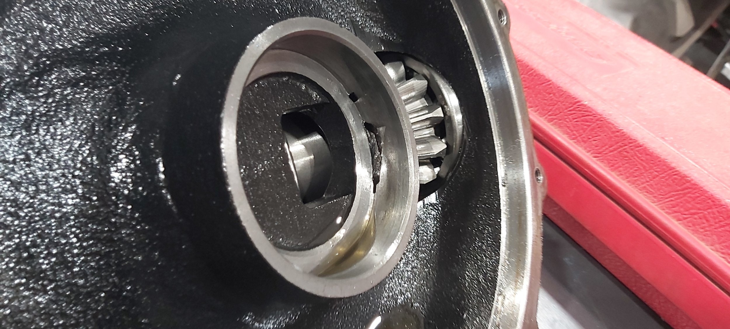

So just a follow up question for all the newer TYM owners...next time you drive your tractor, put it in a full turn left or right and see if you hear/feel a slight knocking through the steering wheel as you are turning.
Just curious if this is "normal" as the first original dealer said all their tractors do it...its just the way TYMs are...
To be clear, the part in question is not after market, it is original..we need a new wheel final drive case as the original has a jagged hole in it after 20 hours of use. The repairing dealer says they are made "paper thin" along the lines of what Caleb90 is saying...and Caleb...thanks for your confirming that TYM is impossible to get a hold of.
