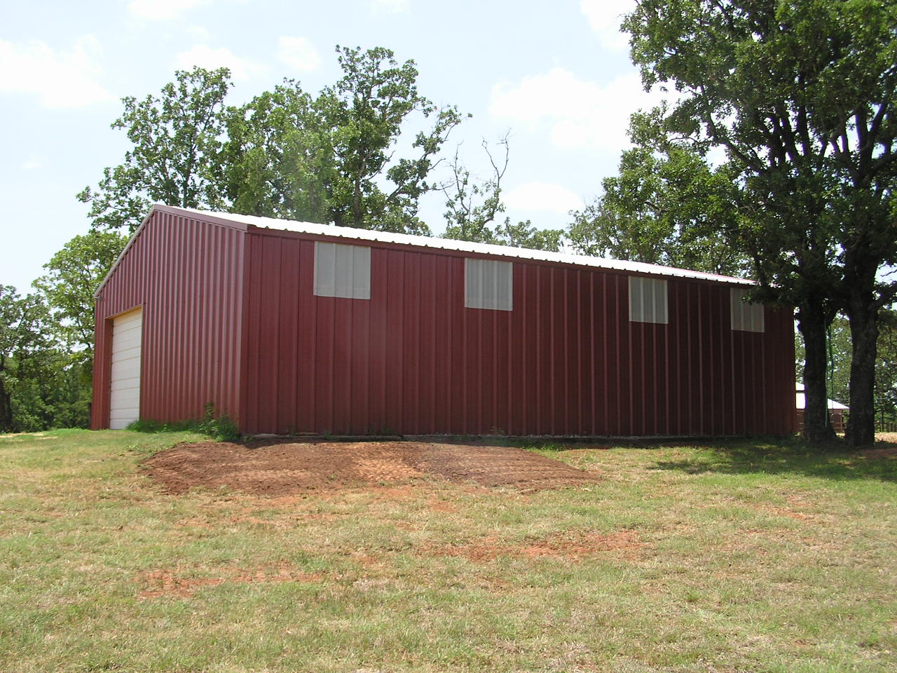

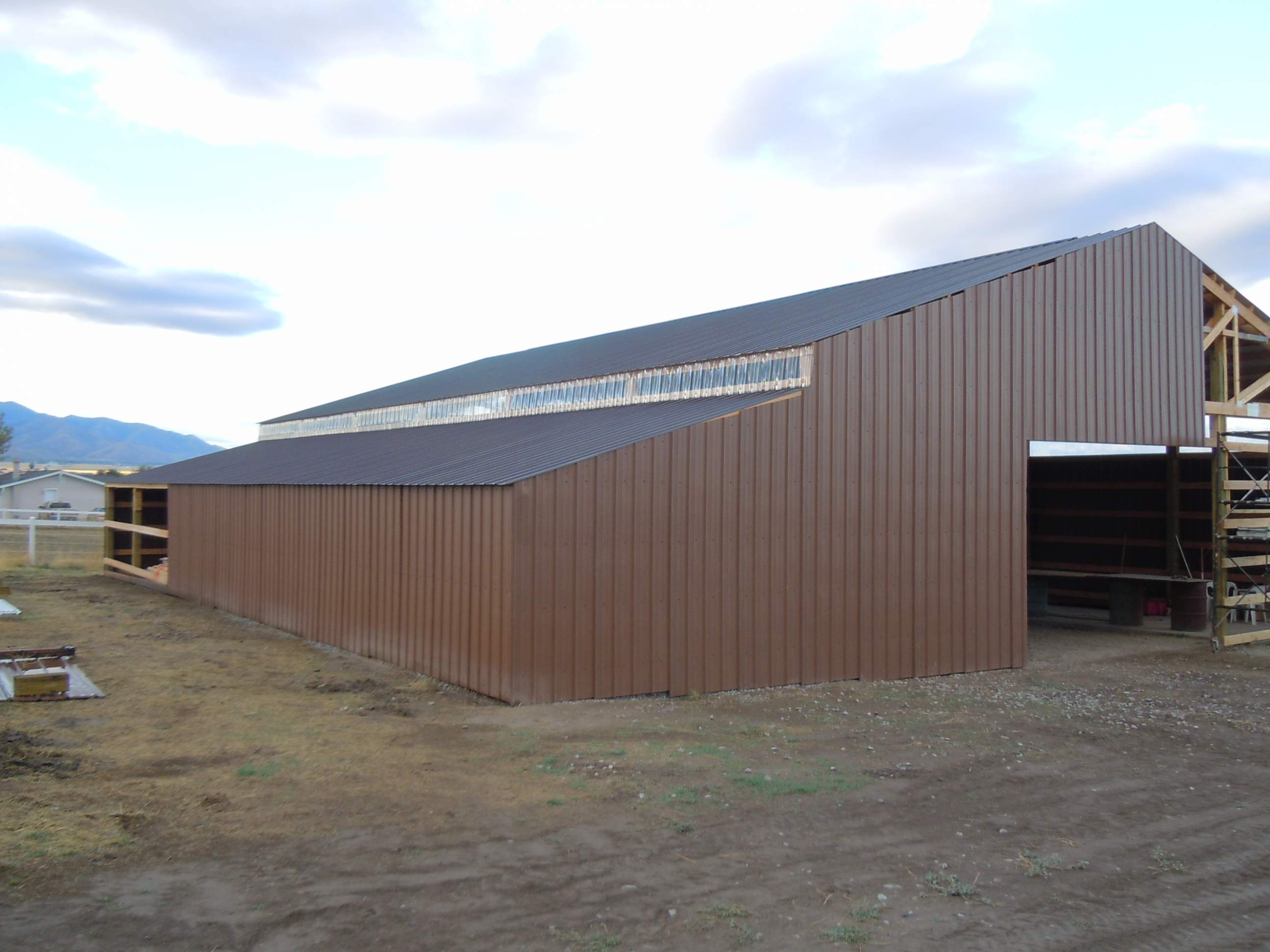

The builder put them on the side walls, not the roof, 4 years ago, still look like new.

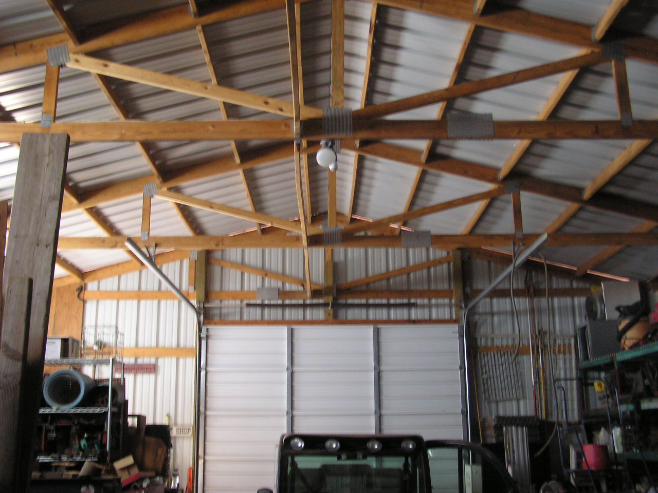

I have the originals still on my barn. 26 yrs old. The barn has power, but no insulation. They are dirty for sure, but still let good light in during daylight. I can't even guess how many times I have left the lights on at the end of the day, hate having to go back outside in the dark and rain to turn them off.

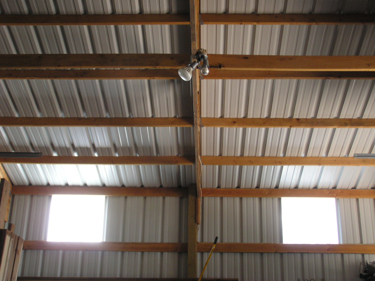

Yes, but don't have to turn on the LED lights during daylight. :thumbsup:

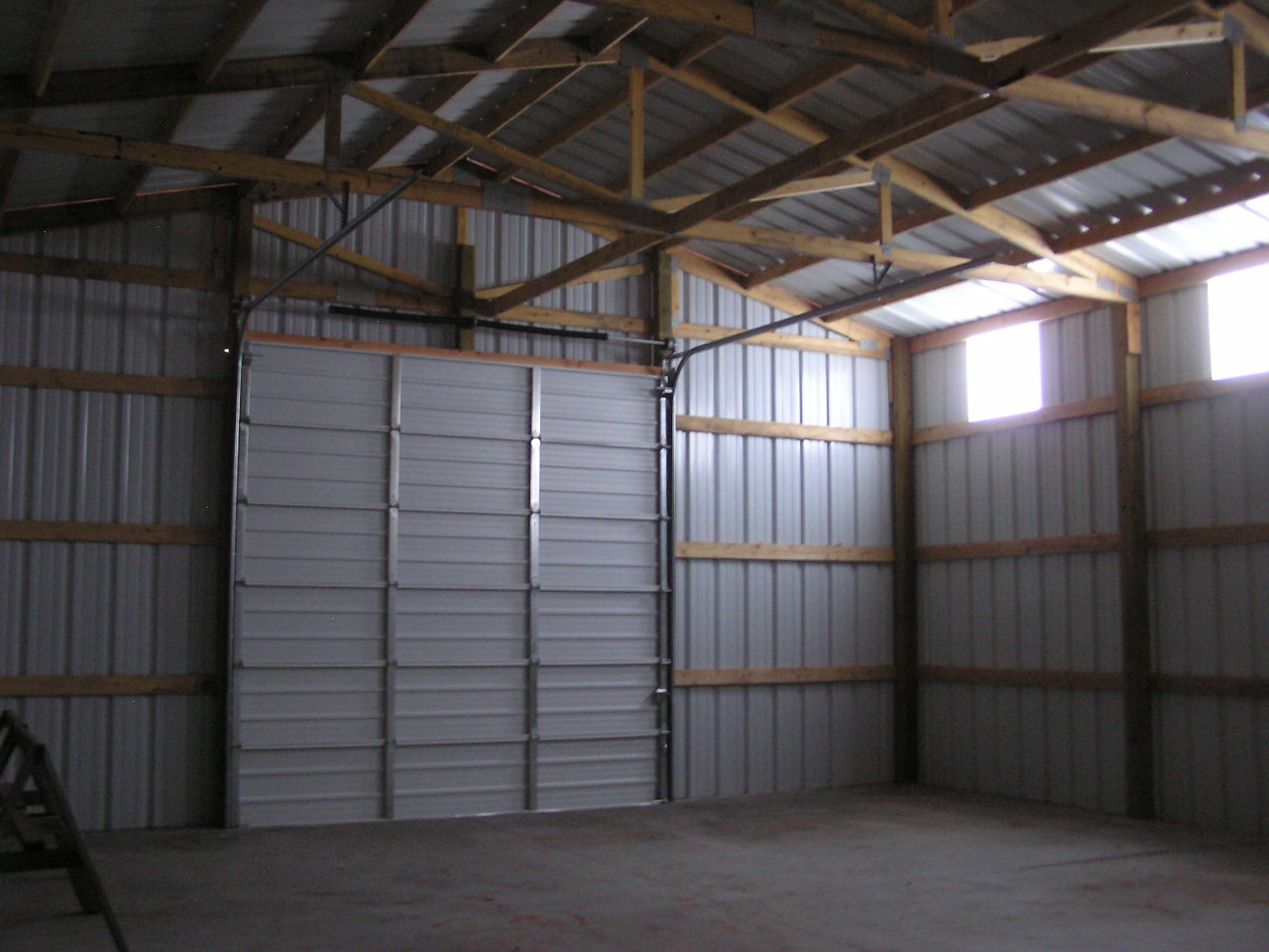

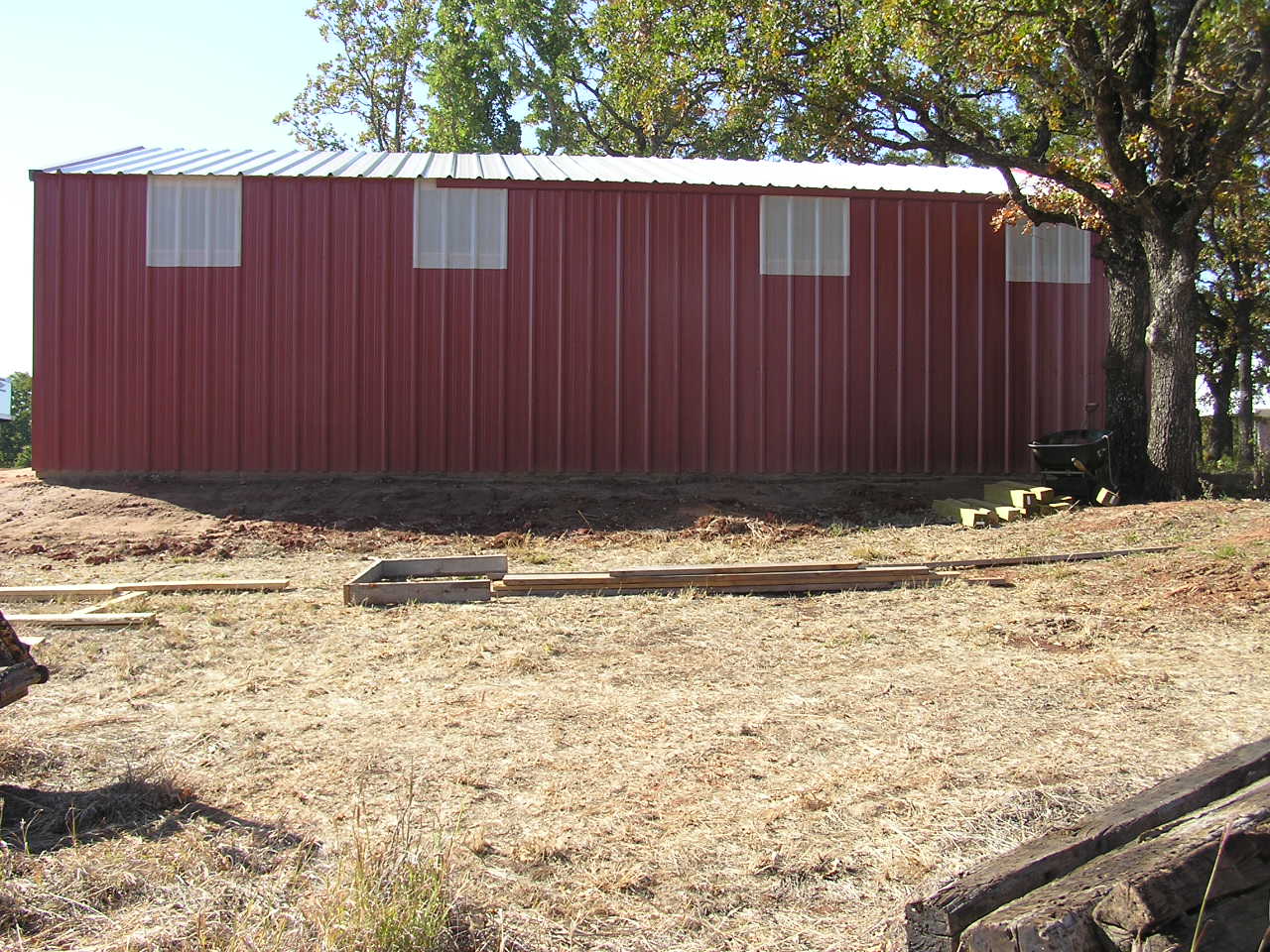

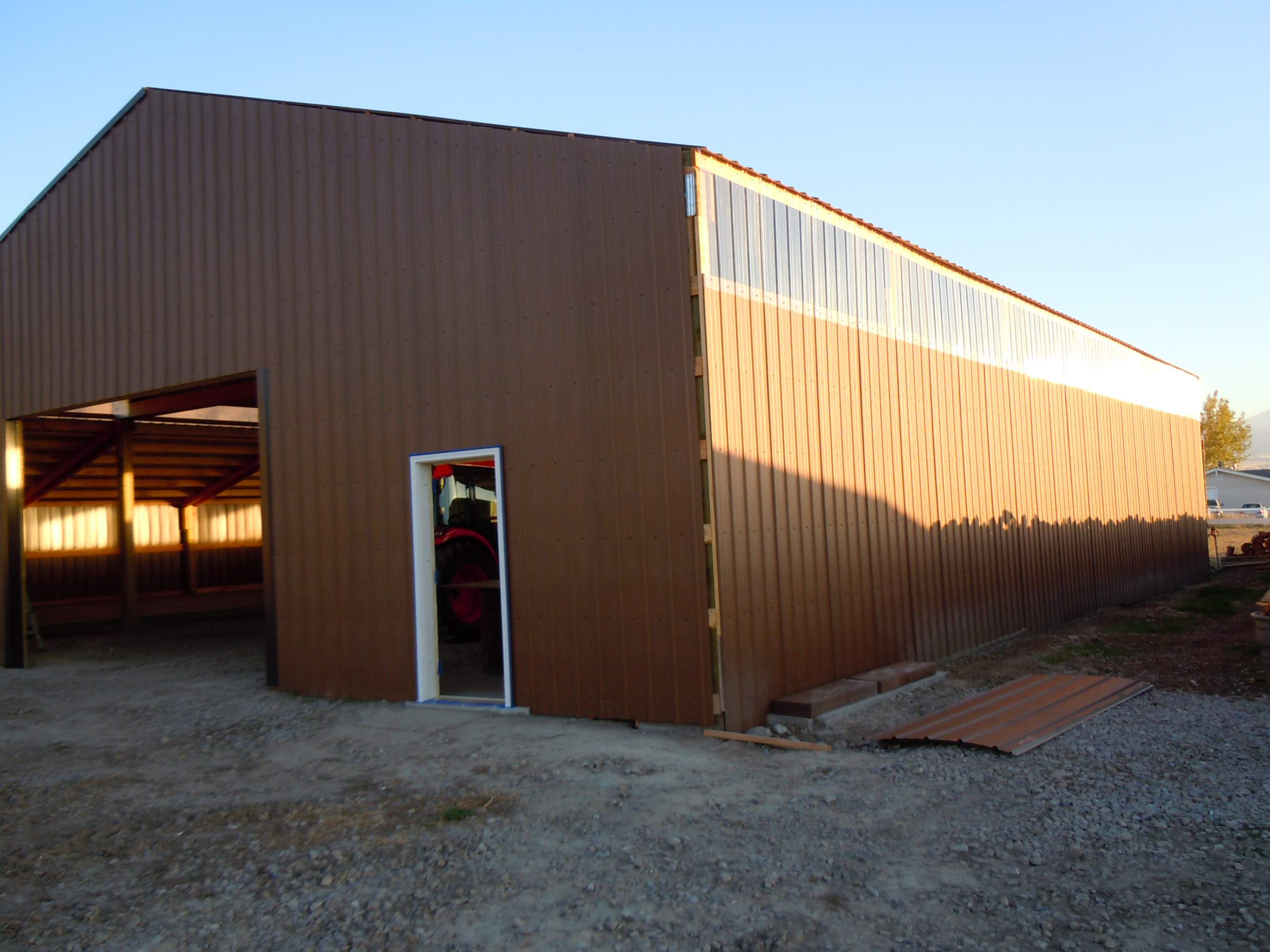

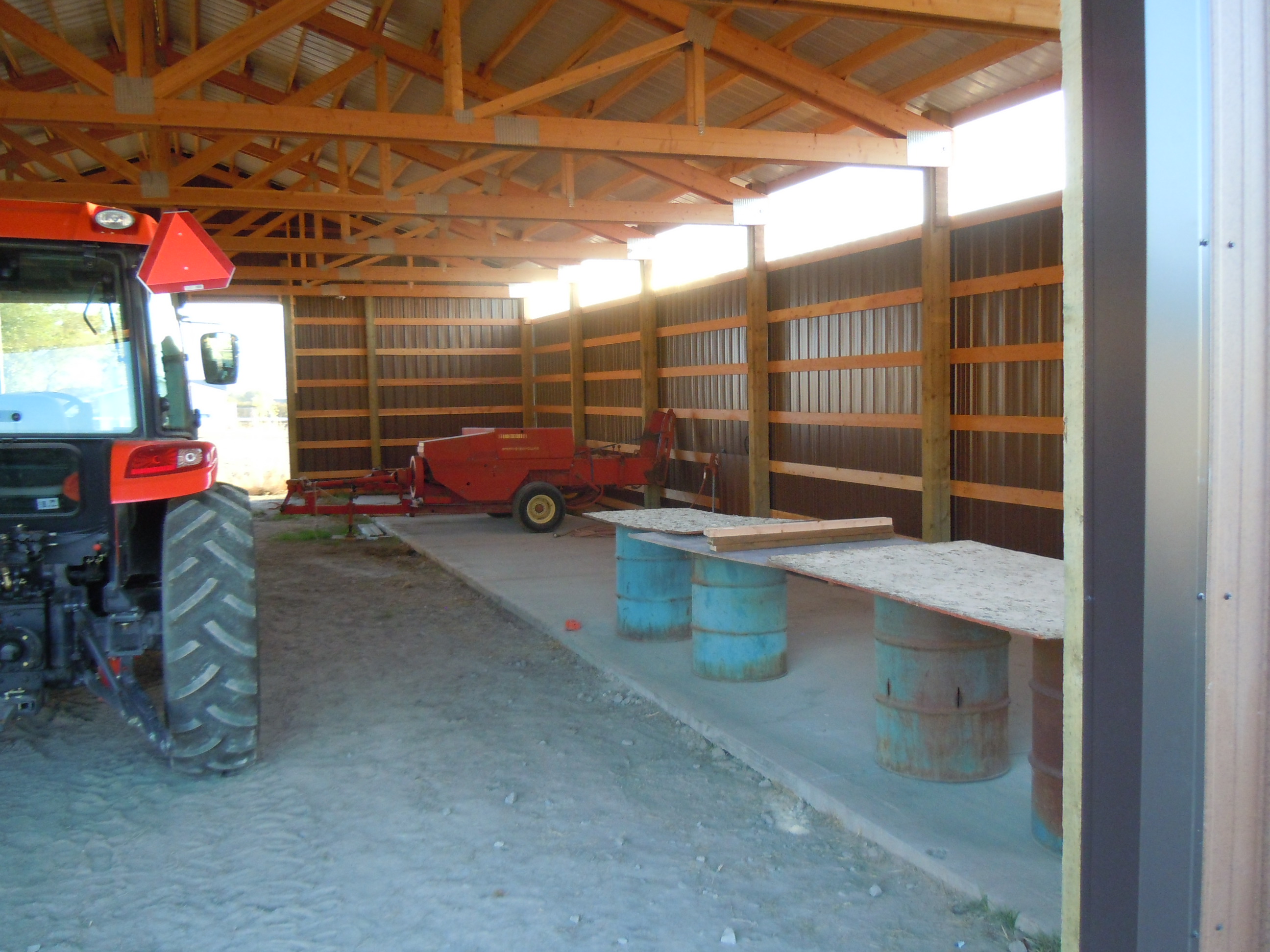

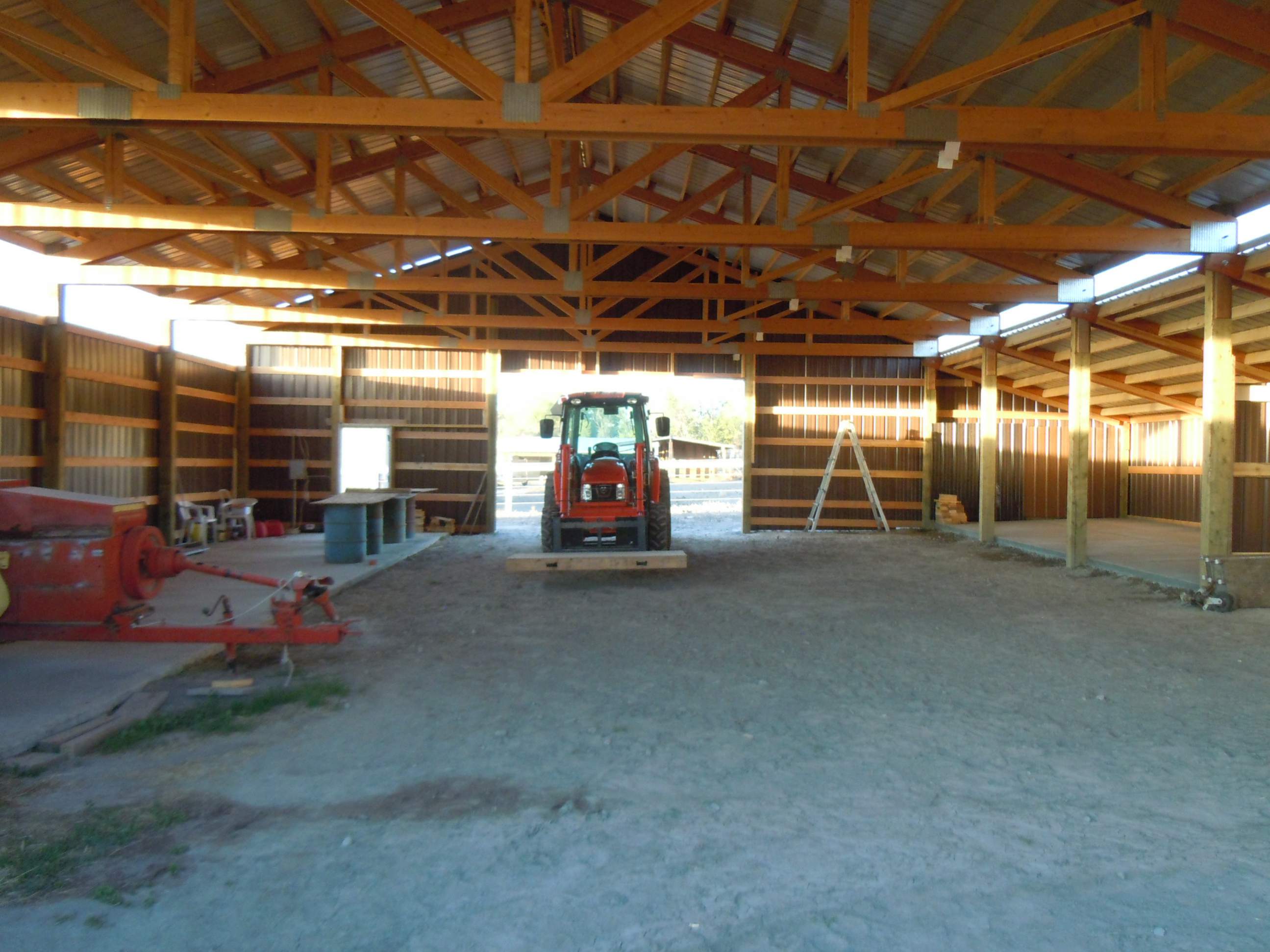

I put the clear panels on the sides of my barn. While I don't have the big doors on yet, I can tell I will not need lights during the day.
I do not plan to insulate or heat. As you can see it's just like being outside with all the light that comes in.
Waiting for doors but everything else is done.
