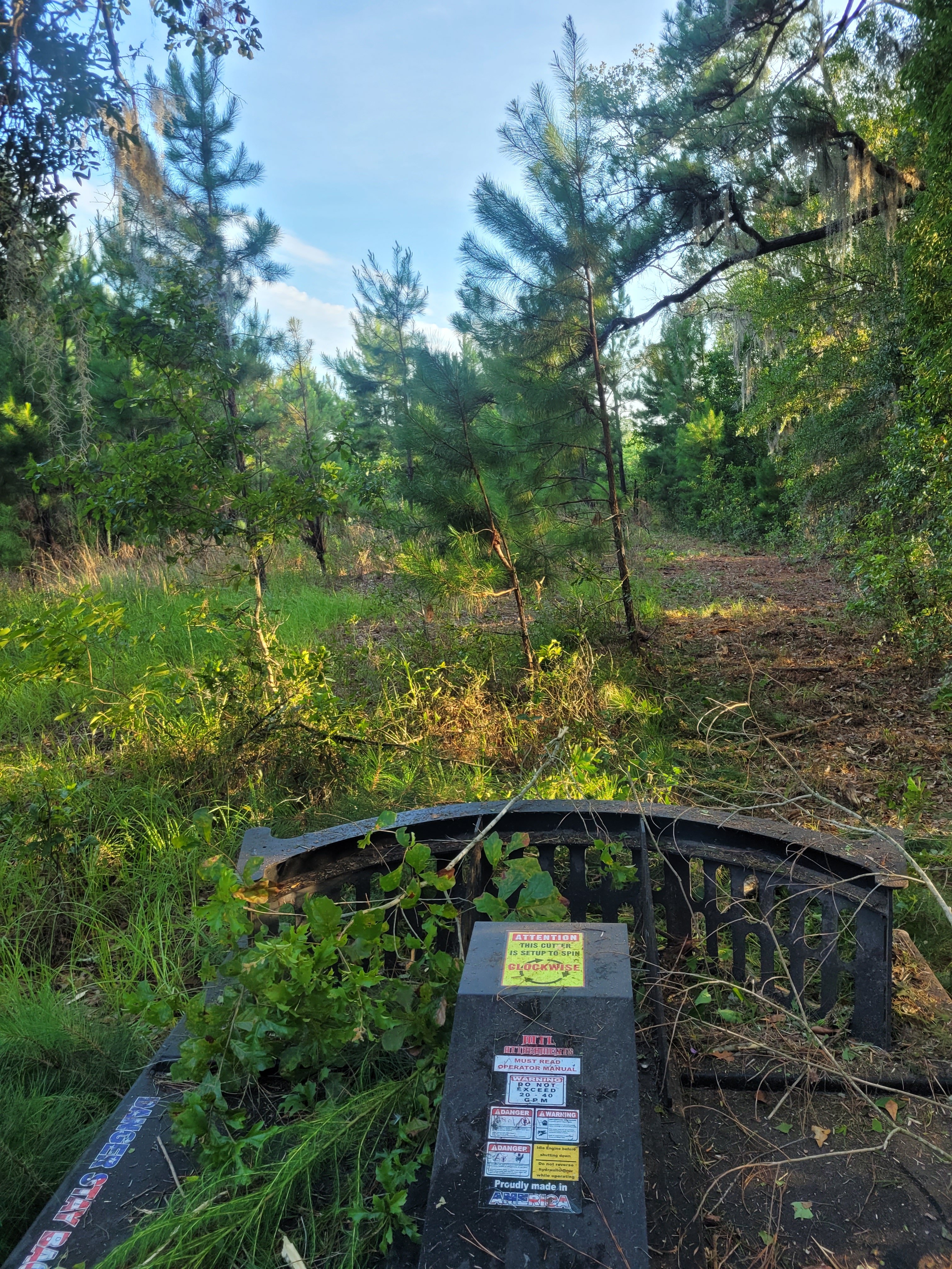

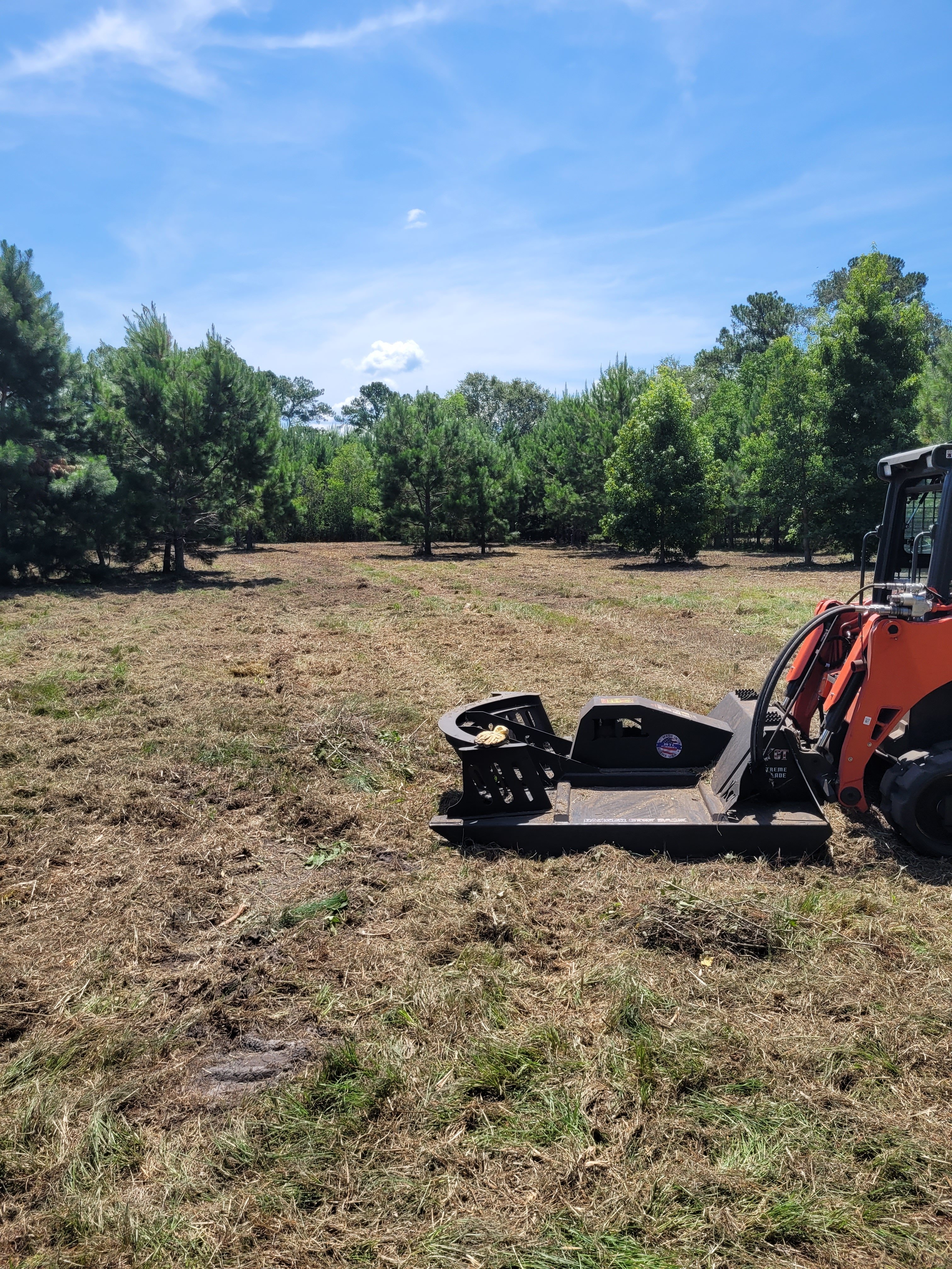

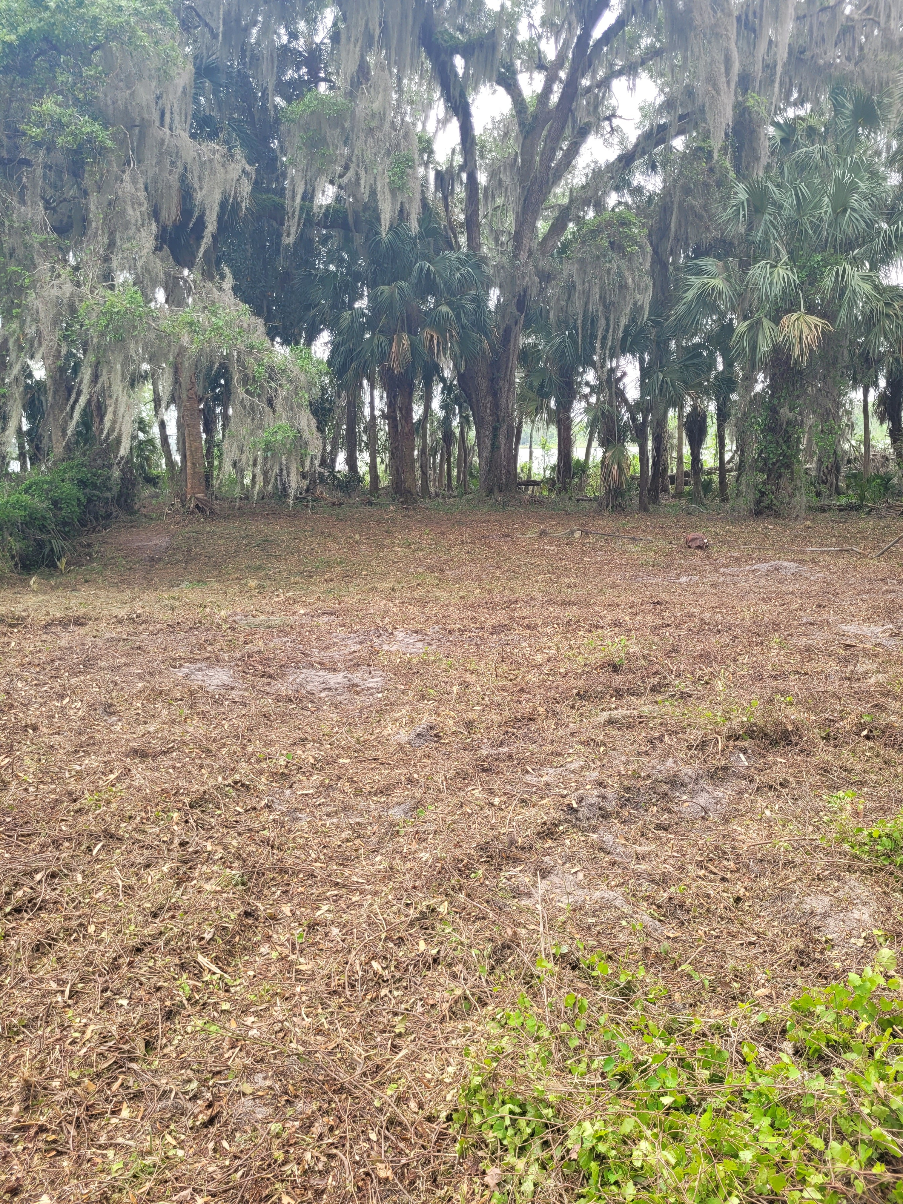

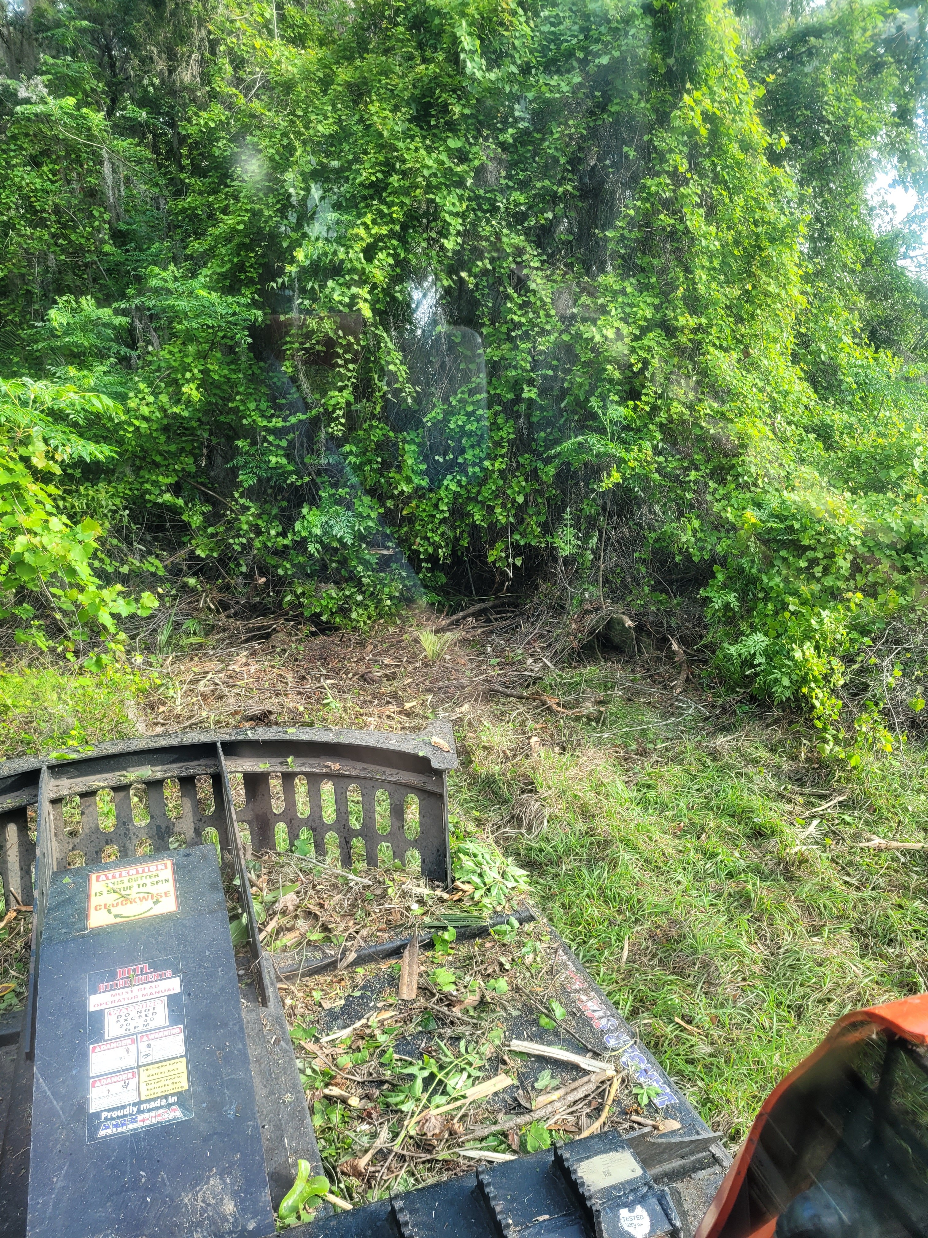

I clear all kinds of thick properties with my skidsteer and forestry mower, most people are amazed at the transformation of their property, I have a thread over in Owning/Operating called pictures from a skidsteer mowing contractor if you would like to see some pictures over the last couple of years.

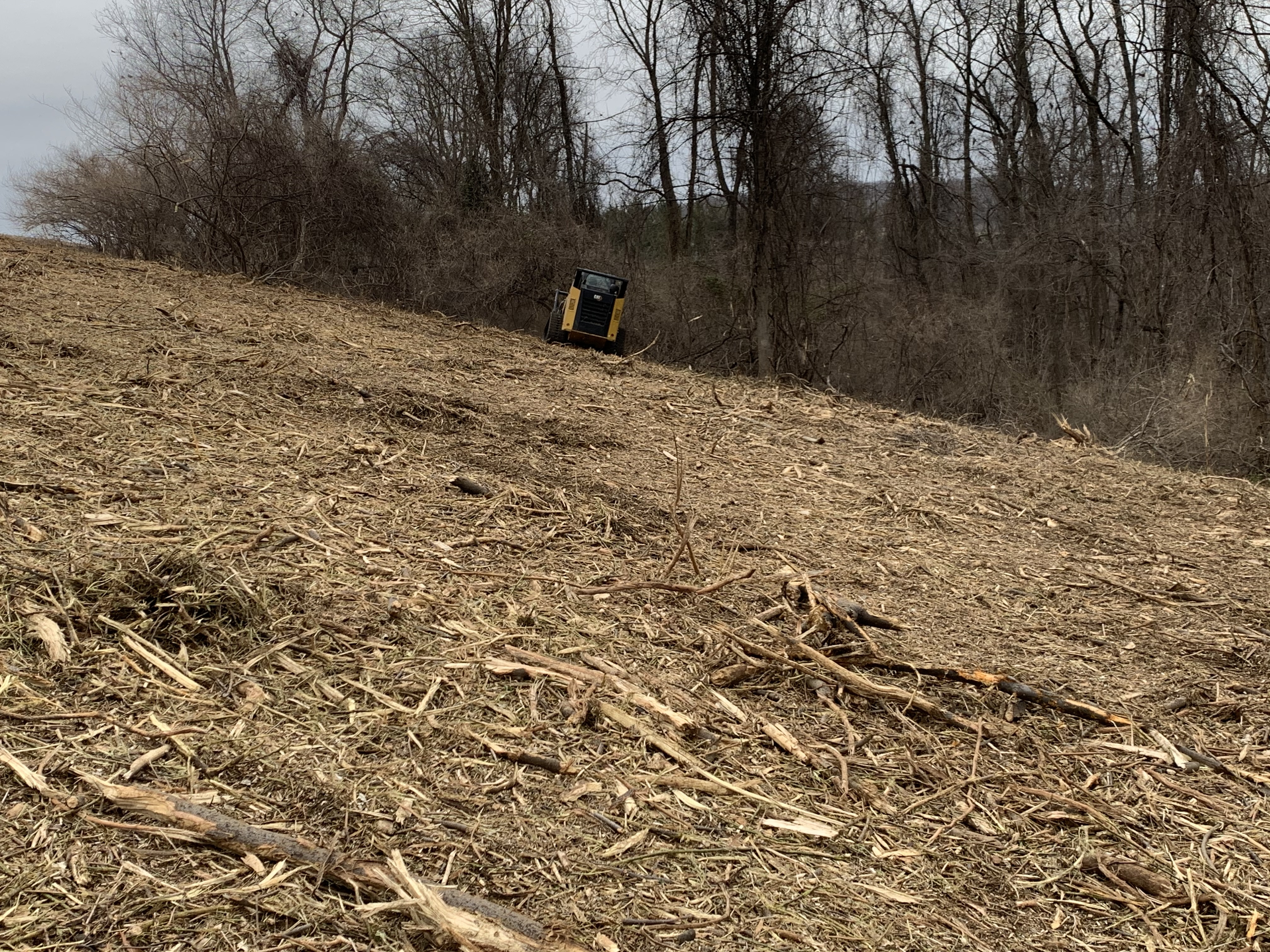

Toughest job I ever did was a tract on a sloped hillside. It was left overgrown for 30+ years. We have dead ash trees everywhere, so they were dropping large branches while we were clearing. Also the hillside was sloped adding to the discomfort/danger of working it. Lastly there was rock outcroppings and a sudden 15’ drop off onto active RR tracks.
We lost a track twice and learned you can’t run a CAT skid loader along a steep incline with less than a 1/2 tank of fuel.
Always keep your cell phone with you in the cab. Have someone check on you every so often if you are working alone.

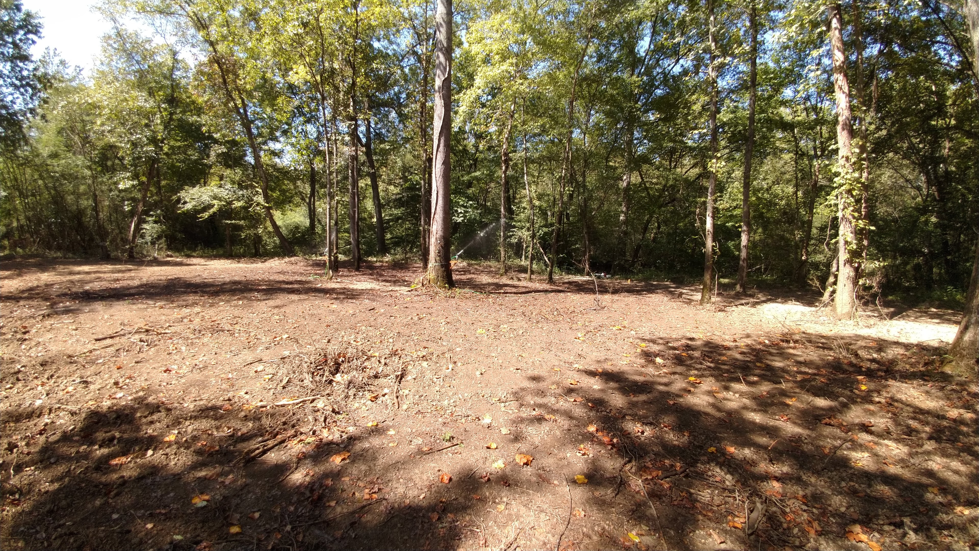

It is amazing how good a piece of land looks as you clear it out. Every 100 sqft. reclaimed from the jungle just makes it look better and better. Such a great feeling! I have only done this for myself, but I imagine as a contractor it is REALLY easy to please a client clearing land. Because ANYTHING is heads and shoulders better than what was there before.
I cleared 5 or 6 acres of HEAVY brush like you are explaining. Next to impossible to even walk through it. First year I rented a bobcat with a heavy duty bush hog and went to town. Taking out most of the small stuff up to 4 inches in diameter. Man it looked good and I felt very accomplished. The next year I rented a good sized mini ex, like a 10,000 lb machine and took out a bunch of bigger trash trees, 4-10 inches dia. Made it look even better. I had my tractor by this time and the combo of a tractor with a grapple and a good sized mini can do some serious damage. I found it was easier to top the trees about 5 or 6 feet up and then cut them into a couple of pieces. I found that a bit more physical labor, but easier overall to get the stuff moved around and into piles for burning.
Before:
After:
This is right before I planted my food plot.
I am now at the point that most of what I need to clear out can be handled with my tractor and tree puller/grapple.
