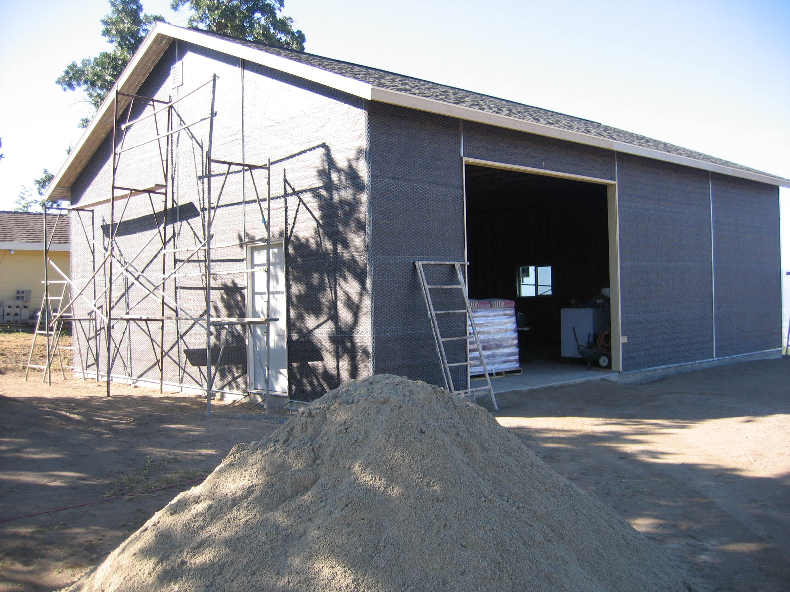

Well, Here it is 11 june and today the stucco guys showed up. They have started on the first coat. The electrical has been going slow since that is my job. Had to help my good friends wife with her move and that took up much of my time. Now that that's over I can work on the shop. Getting the wire through the attic will be hard and hot! Guess that is why I have avoided it,has to get done.The 12'x10'door should show up soon.See Photo of shop with wrap, ready for stucco. Have to go now much work to do.

...Getting the wire through the attic will be hard and hot! Guess that is why I have avoided it,has to get done...
Just think. If you can put it off for another few weeks it will be the middle of July. Then you'll really have some bragging rights for running wiring in the hot attic in the middle of July.

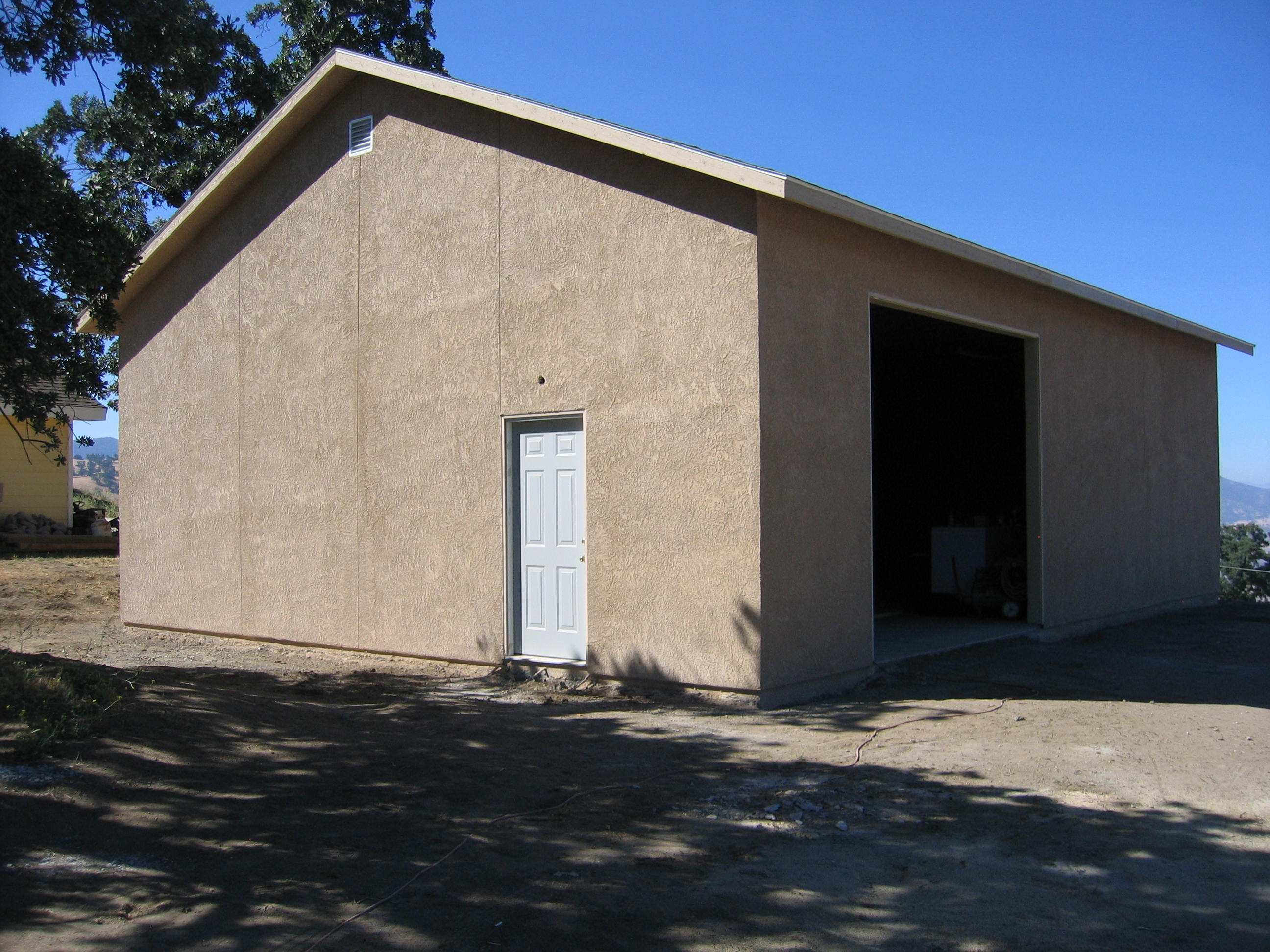

Update,The color coat went on sat the 23rd.The garage door should be installed this wed. WoW, Getting close to having the final inspection.Got the electrical through the attic. Waited for a cool day and it wasn't as bad as I thought. Only installed enough electrical to pass inspection, two outlets on each wall and 4 overhead lights and one exterior light over the walk in door. After the inspection I will install more before the insulation and wall coverings.AS for the floors, I believe I will not epoxy it. Like others have pointed out chipping is not easy to repair. The one last project to the final is to put in a concrete apron to the rear entrance to the back lot. Not quite sure if I'm up to it , so I may call my concrete man back.

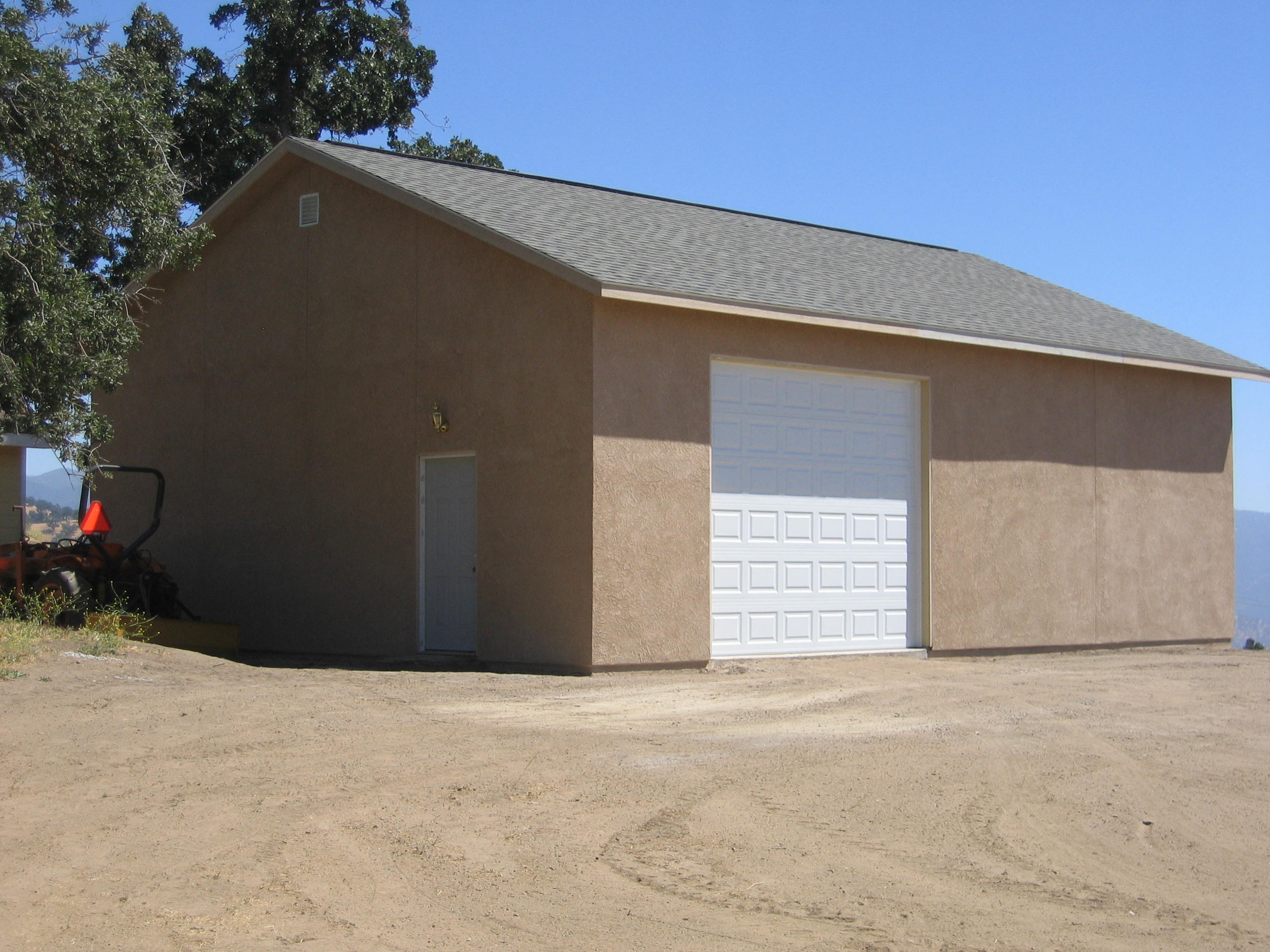

Hello All TBN people, How can I change the title of this post? Now I'm close to the finish.Today the garage door went in, yesterday It passed the final inspection. Still need to put in a apron in on the back entrance to my property.That may be a new post on cement work. I still have building projects on the inside of the shop. A 12 x 10 office and a storage loft ect.Thanks to all those that responded you all had great Ideas.
