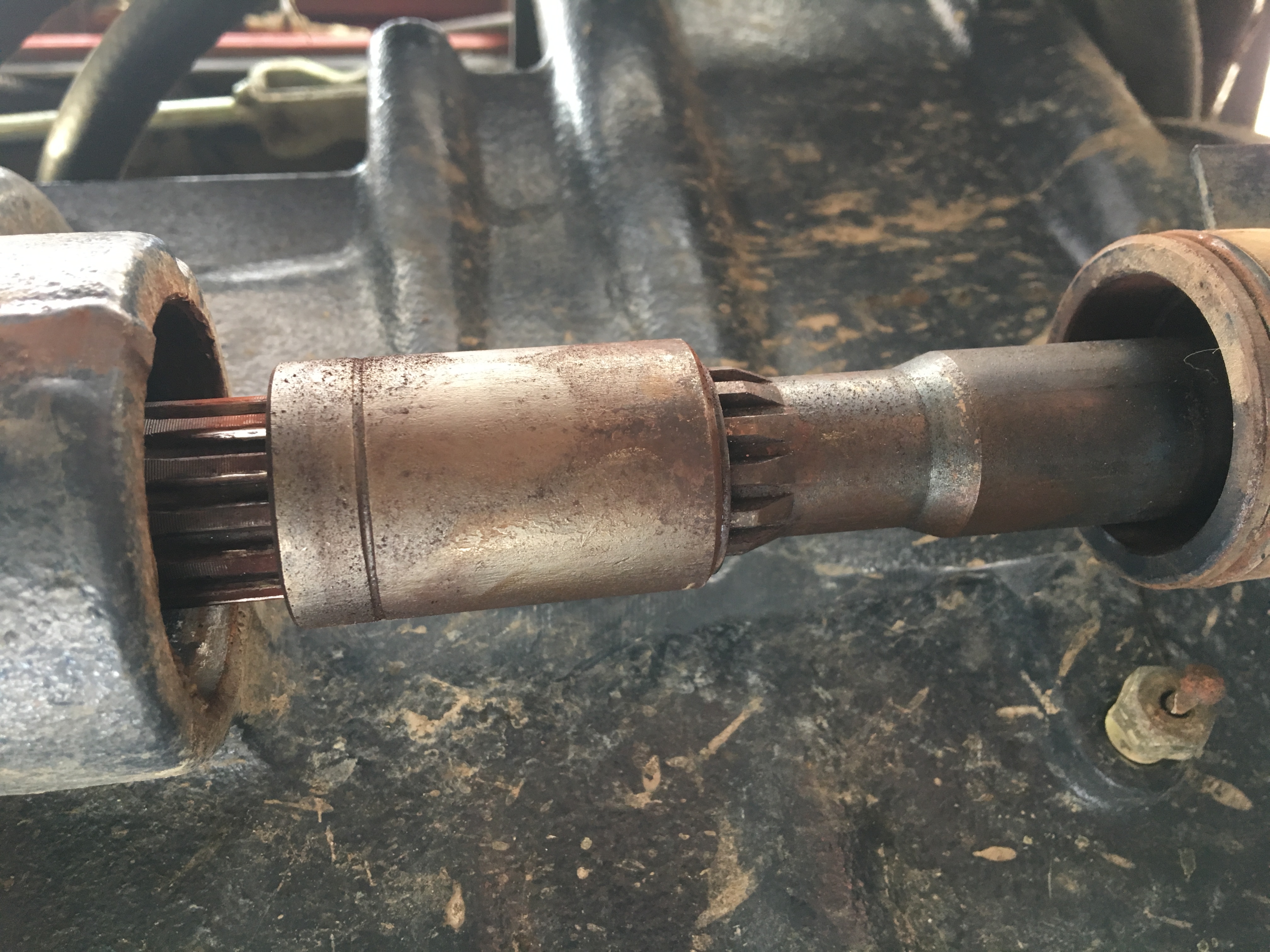

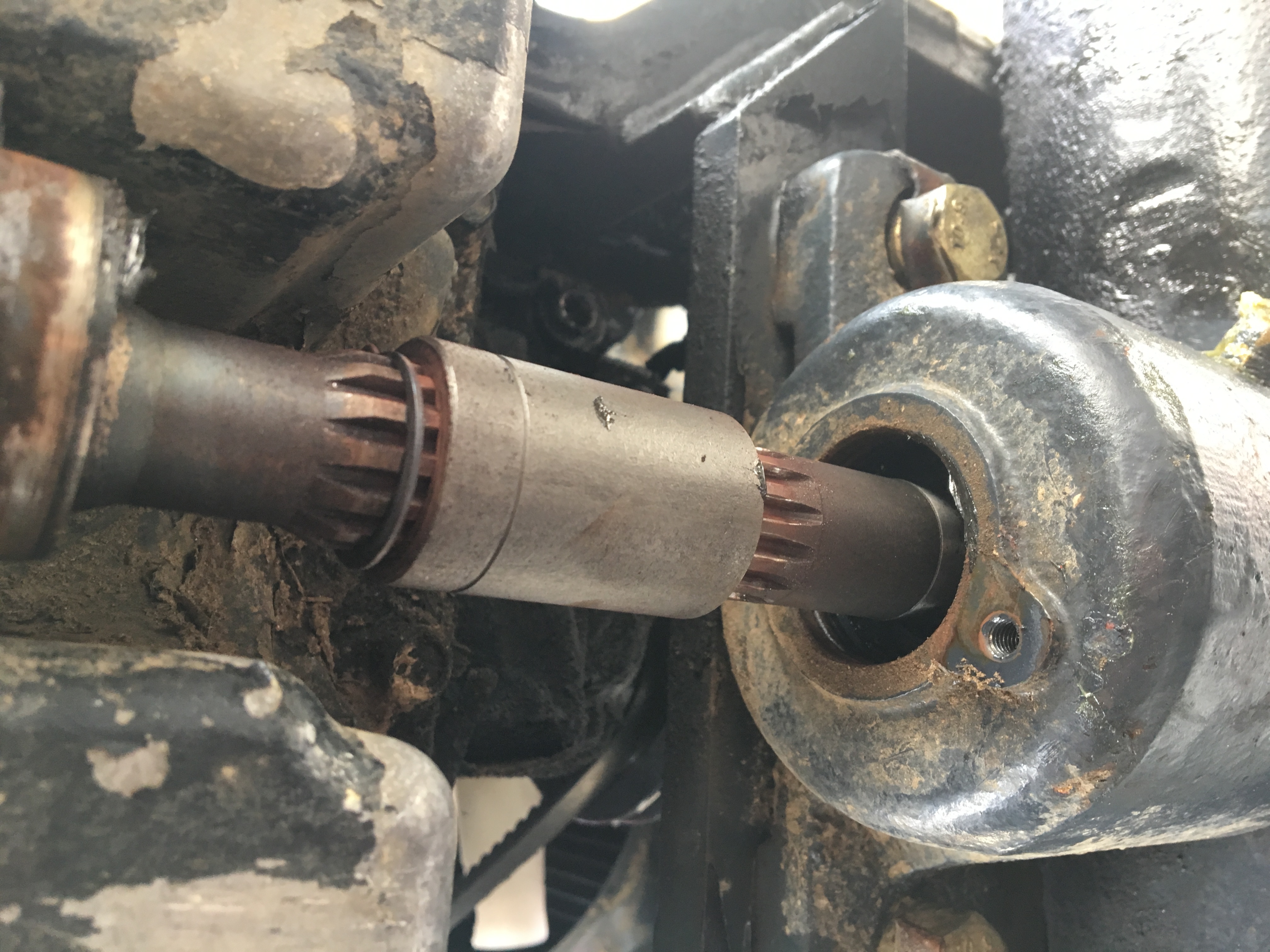

Just for future knowledge, if you'll use a pair of snap ring pliers and open that ring right next to that sleeve and slide it down the splines a little to let the collar slide further it will let that end of the driveshaft fall free - have your hand on it when you slide the collar. Do the other end and the whole driveshaft and collapsed tube will all come out together. You have to slide the collar probably inch or better to get to the break between the two splined shafts.
I use a little spline grease when re-assembling. You can just about slide the snap ring back into it's groove with your fingers. I use a piece of wood and a hammer to hit that little tab on the tube to seat it back into place before tightening the clamp.

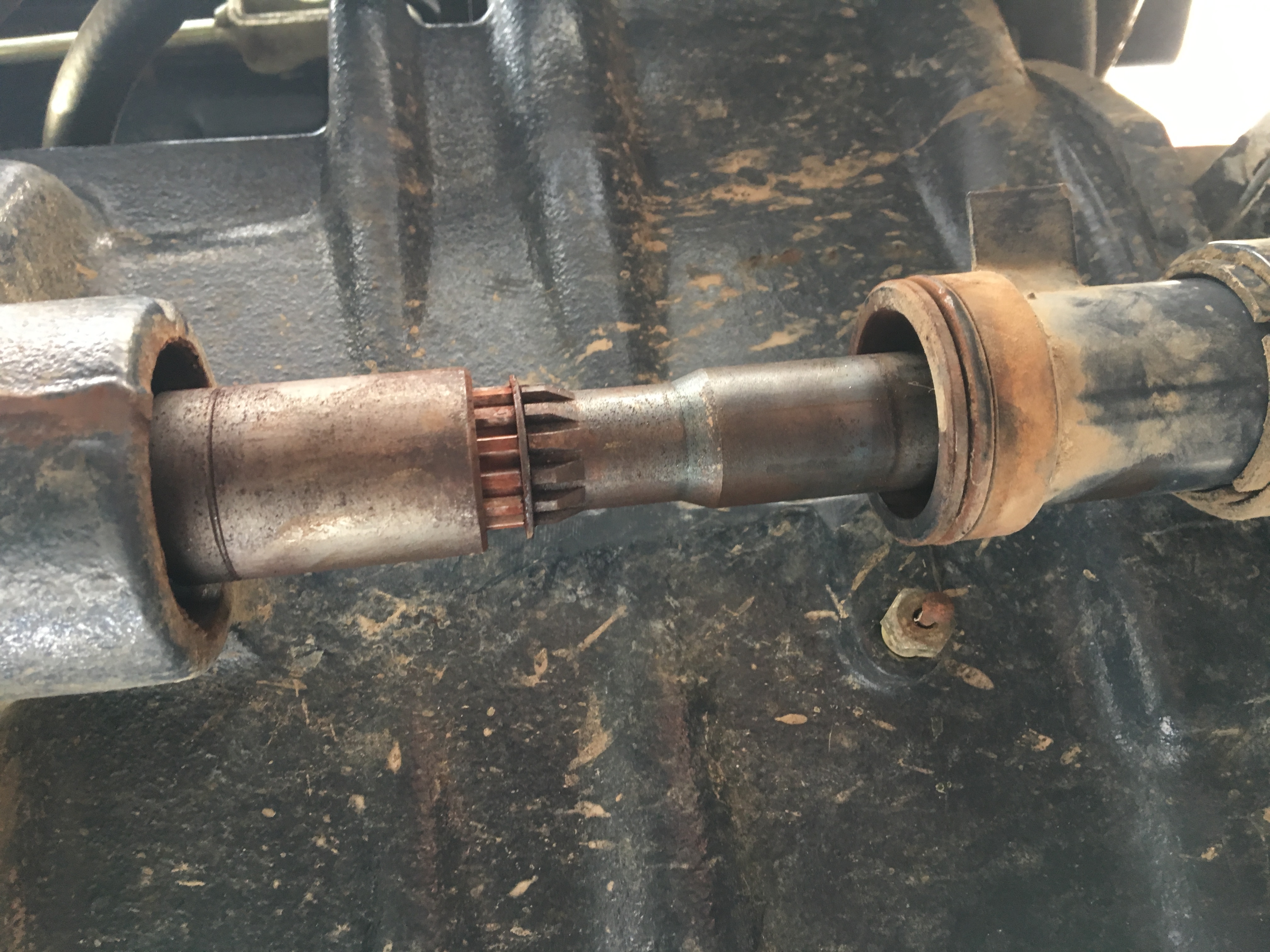

Yep, it's the bearing that supports the end of the wheel shaft. When this failed it allowed the bevel gear to "walk" and grind into the final gear case (see metal grindings 3rd photo). The grindings got into all bearings on that side. This "walking" of the bevel gear was the cause of my "lurching" when in 4WD.
If this is the problem with yours, you'll know which side it is because when you pull the lower drain plugs, the side with the issue will have the metal shavings. In the end after replacing the gear case, bearings and seals I was a little over $1,350 for parts and did the repair my self.
