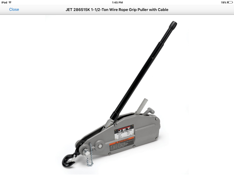

If you want to do it by hand these are the best type of hand winches I have used. You can put as long a piece of cable you want so you don't have to unwind and start again like a regular come along. Longer handle for more leverage and different sizes for different applications. Spendy but at least their Amazon prime;)
