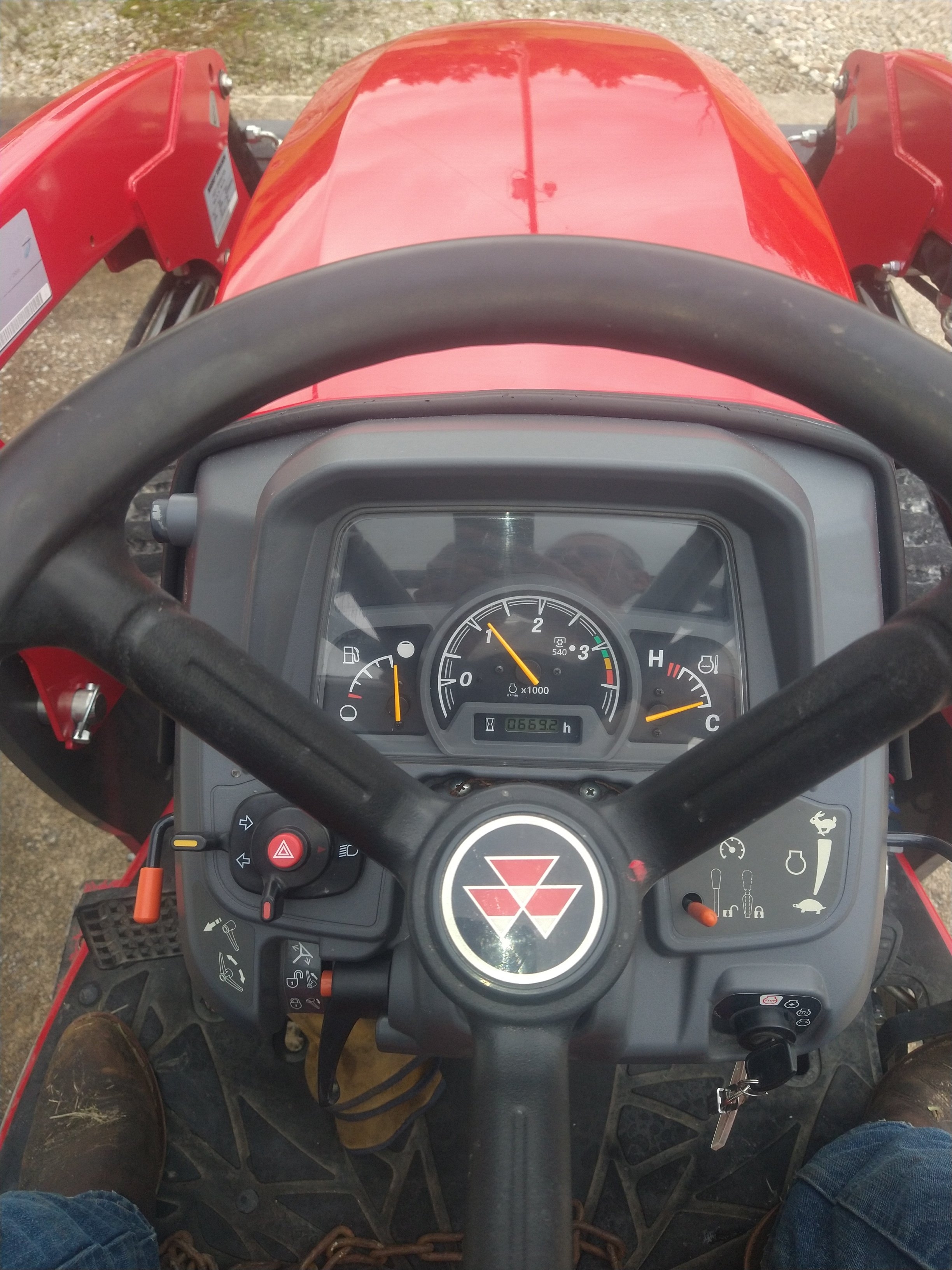

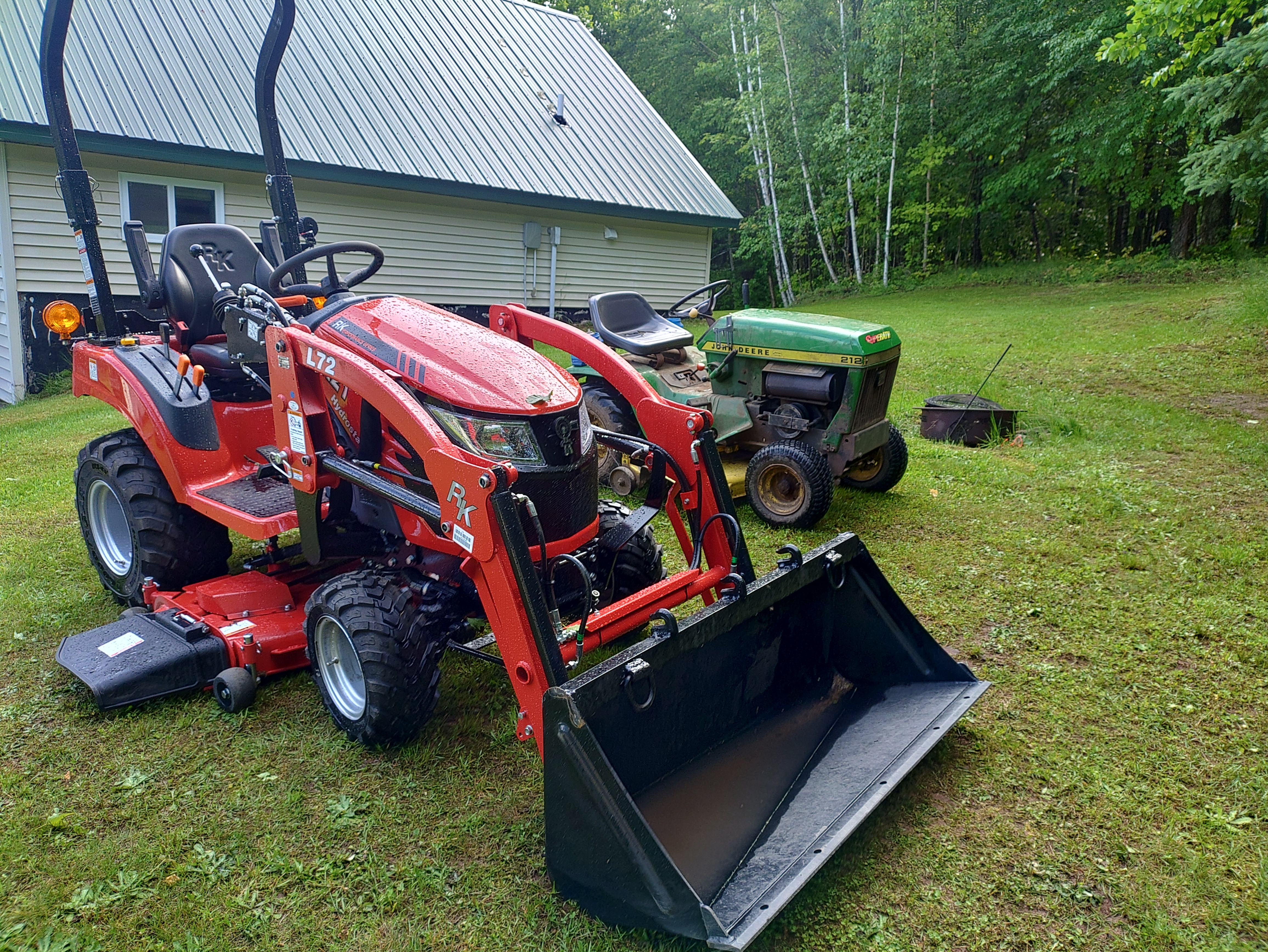

So far so good my tiny tractor is one of those things you wonder why the heck you didn't buy sooner, handles mowing the hills amazing sure beats the pants off my old JD 212 I used for years here. Not much bigger profile minus the loader and frame. According to my self proclaimed mowing expert wife says it cuts really good granted it's new but she thinks it cuts better than her zero turn down state. Mostly sold on hydrostatic drives and pedals, Funny thing I'm constantly trying to grab for a shuttle shift on the column to change direction. lol. More to follow in the winter how I use it move snow up north. Or problems that arise, any questions feel free to ask.

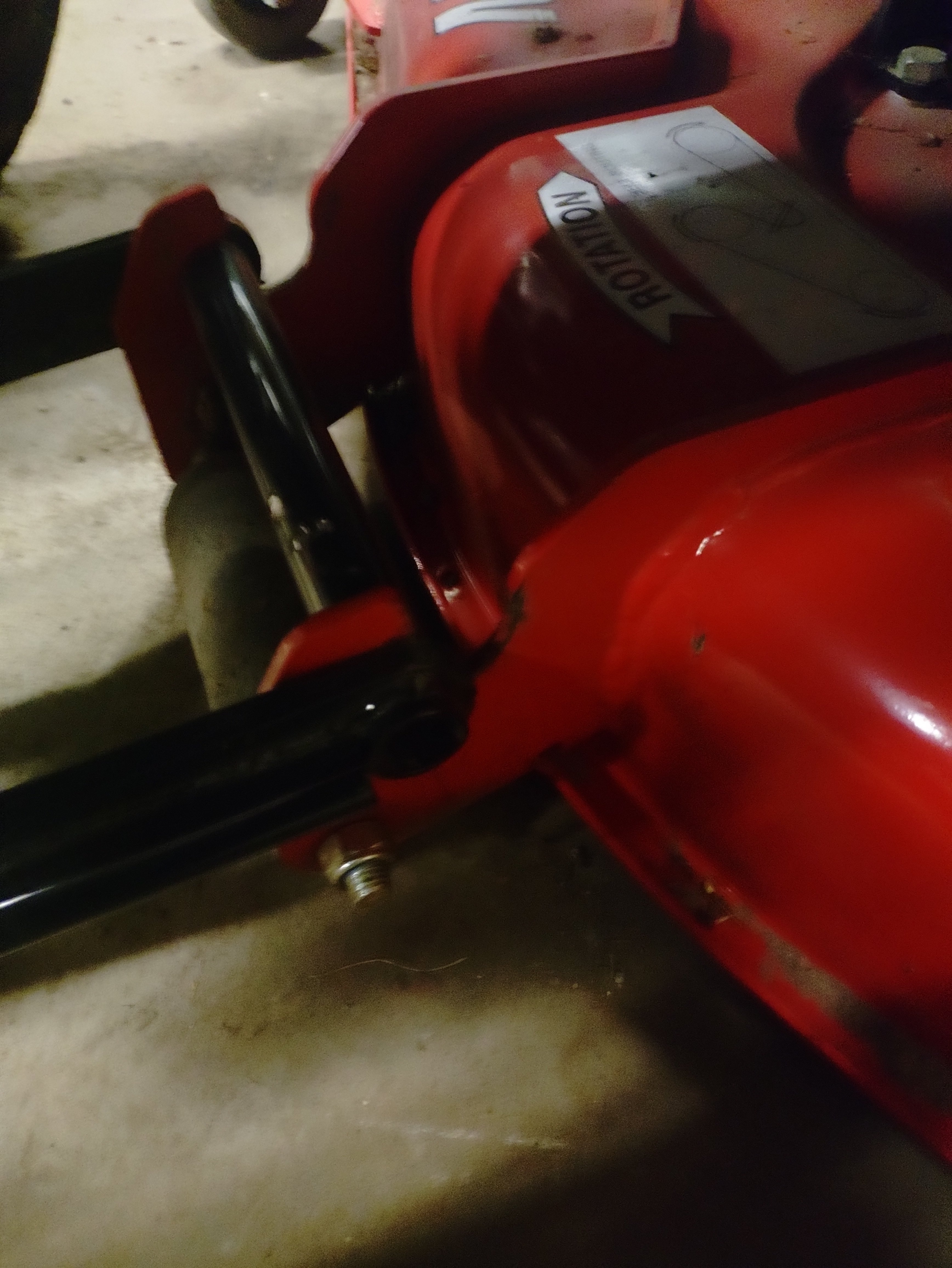

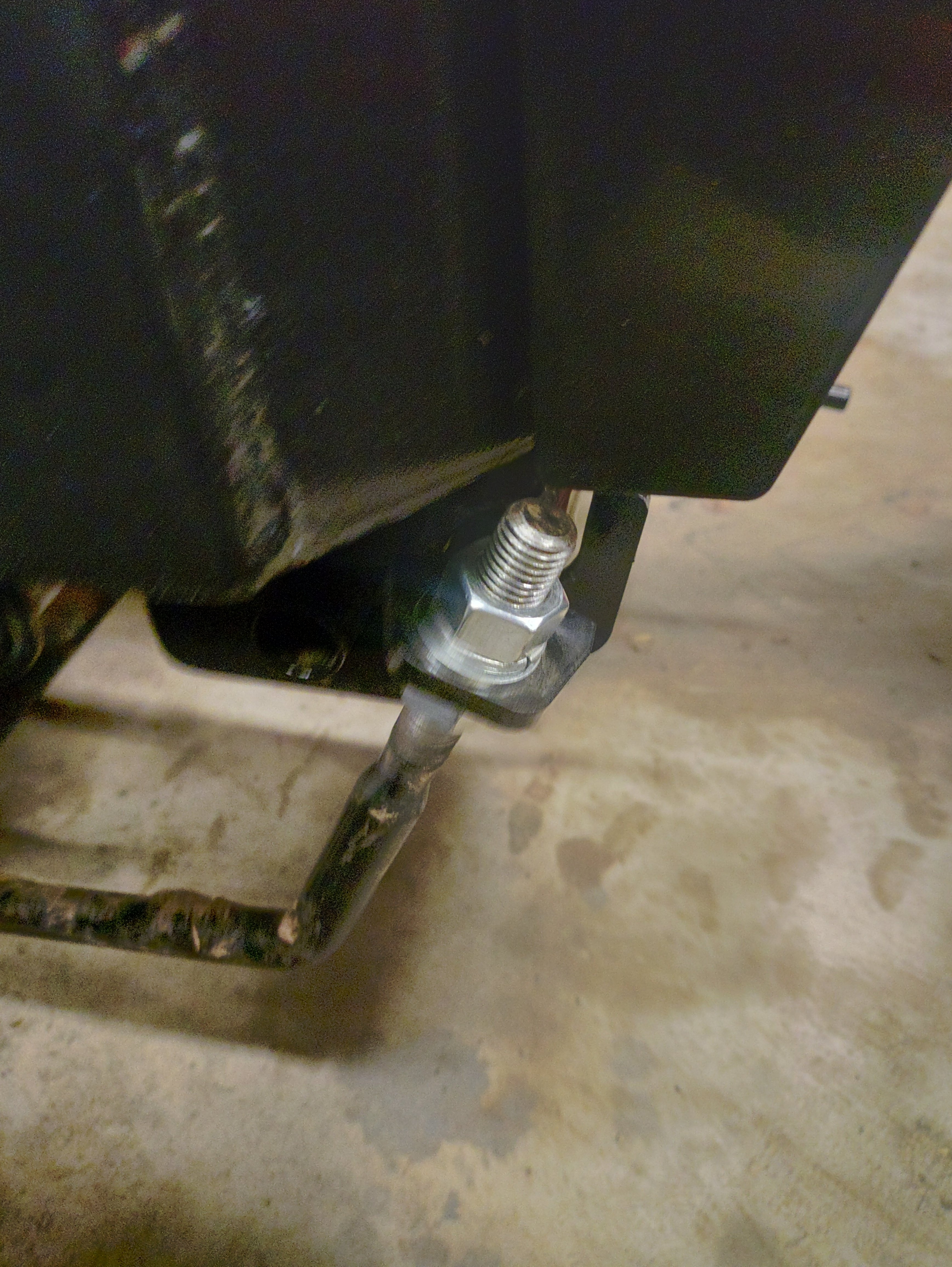

So lost two of the belly mower front mounting nuts during my brief road grader incident before I realized what was happening bent the front mount on mower deck. To my surprise I pretty easily bent it back. Ran to local store to get 16mm nuts, washers, and lock washers if it happens again I'll either double nut it, or use loctite. At least I'm aware of this and will check it over frequently. Other wise this tiny tractor has been great so far for what I need it for.
