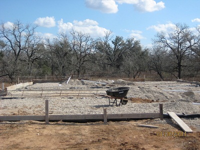

Anyone ever built your own concrete forms for a slab with foundation. Will be a monolithic pour.
The land has a slope to it with a 23" grade corner to corner diagonally.
My main question is. Does the top of the forms have to be level with the 4" slab that will be poured? Or can the forms be higher? and if they are higher how does the finishing crew ensure that the slab is level and true when they screed and finish?

In '92 me & my dad built the forms the monolithic slab for the 1,600 SF house I still live in. We used 2x12's & secured them to 2x4 stakes about every 4 or 5 feet.
You do need the top of the forms to be at the exact height you want the finished slab surface to be at - The top of the form is exactly what the concrete finishers will use to determine the height of your slab's surface. They use screed boards, either a long straight 2x4, or a straight aluminim piece, to drag along the top of your form boards. They continue dragging the screed board until the concrete has worked its way down to being the same height as your forms.
Put another way, if you make your form boards higher than you want your slab, your slab will be higher than you want it :)
Should look like this, with the top of the gravel in the pic exactly 4 inches lower than the tops of your forms, so that the concrete all across the slab is 4 inches thick everywhere except for where its thicker in the footings:
