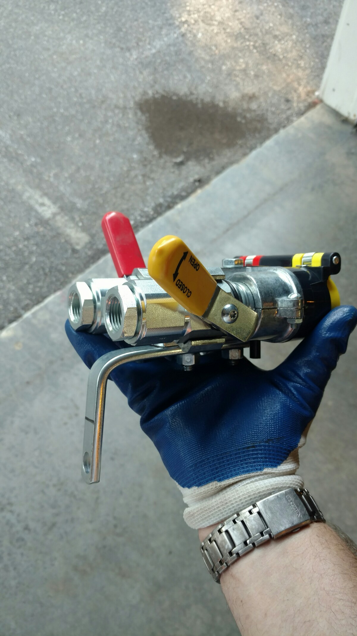

One of my 3rd function quick couplers failed and needed to be replaced. So I decided to look a break-away option because I have come close to accidentally dropping front implements with the hydraulics attached.
I change implements frequently and currently had to turn off the tractor to relieve pressure and cycle the elctro diverter. I also have to constantly fight to keep the QDs clean as I do a lot of dirt work with the loader.
I came across this Parker product which normally sells for $280 but Blain's Farm and Fleet has it for $130 somehow.
Pioneer Lever Coupler Kit at Blain's Farm & Fleet
-Push or pull one handed to connect or disconnect (ISO 5675 2way mounted couplers).
-Built in shut-off ball valves.
-Built-in sealed automatic dust covers with gaskets to keep out dirt even when connected.
-A drain hole to weep the small amount of hydraulic fluid that escapes with disconnects.
-A clamp bar
It's really slick.

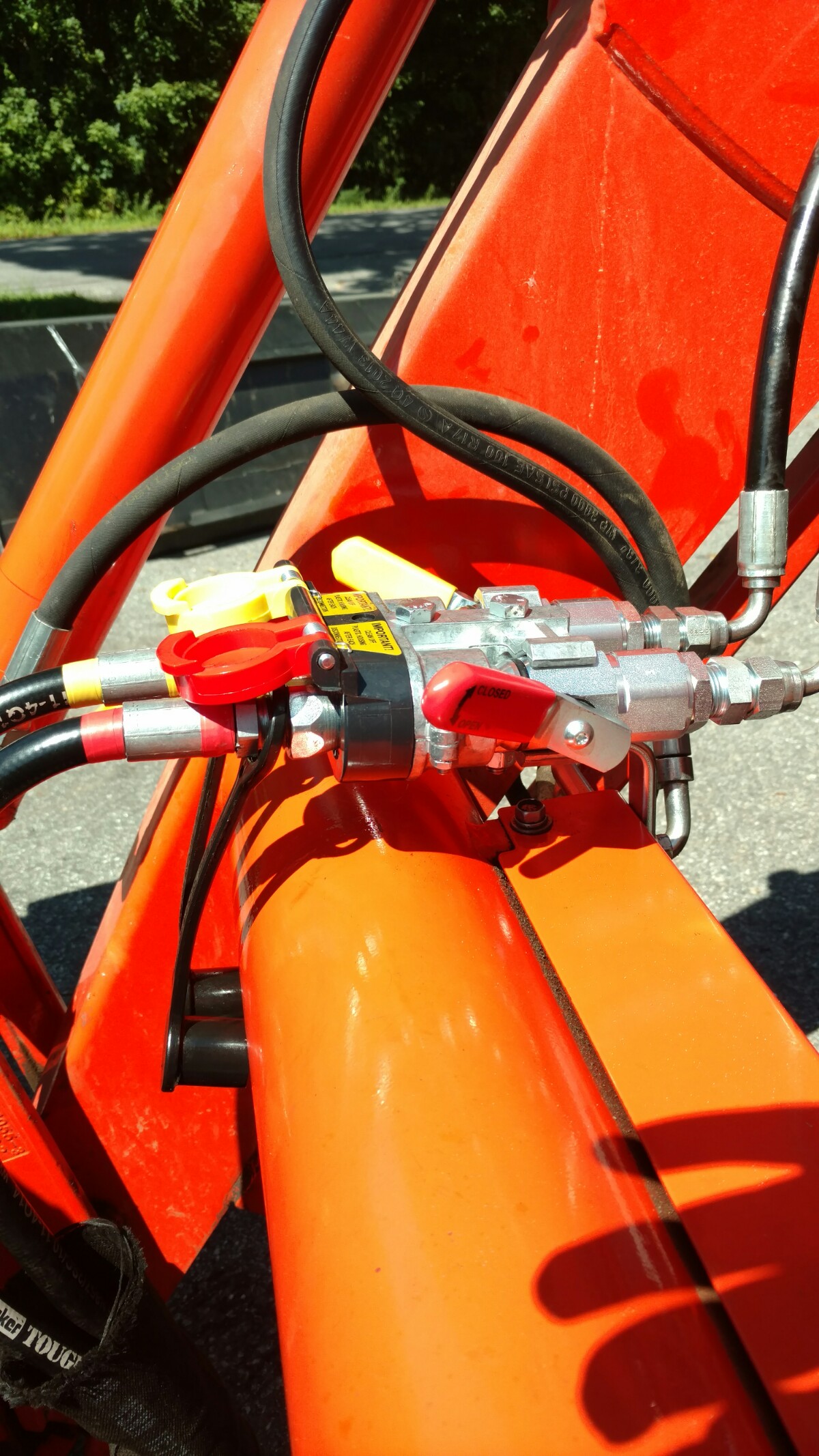

I had to bed the clamp bar to about 80deg for my application.
It was super easy to install (1/2" NPFT).

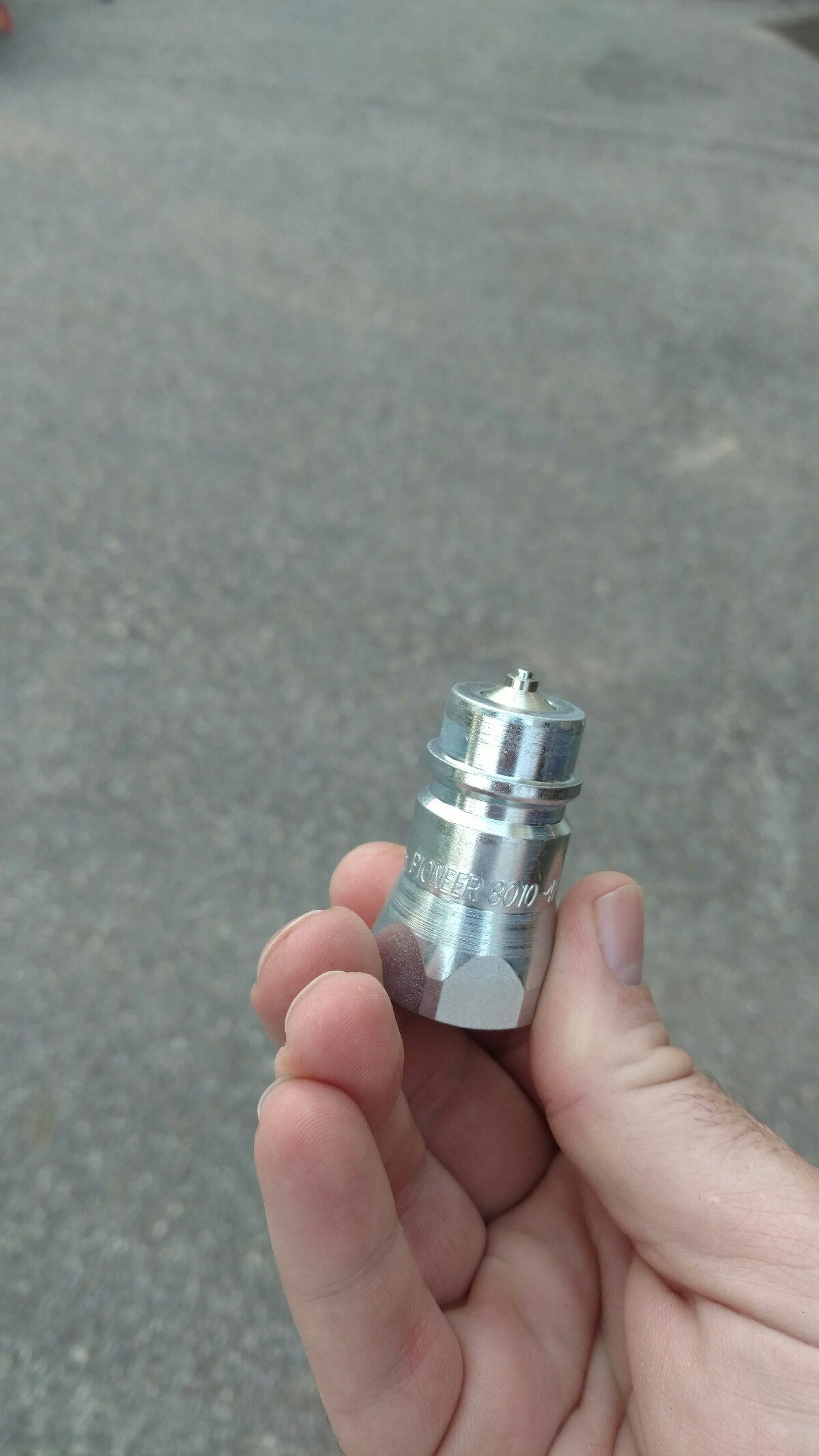

While I was at it I switched my plugs to a pressure-relief design to relieve pressure build up in my implements line due to temperature swings. You can see the little pre-valve ob the very tip of the poppet (we'll see it these fail easier). But no more fighting the residual pressure ever!
This is definitely a luxury set-up but man is it nice!

Thanks- all very interesting, and looks like a great idea, especially for someone like yourself, often changing attachments. I hadn't seen those plugs with the pre-relief feature. Cool. Hopefully, they shouldn't give you any problems. These are not "break-away" or am I missing something??
/ Connect-Under-Pressure, Breakaway Quick Connect
Yes, yank on a hose and it disconnects and seals.

I have those relief valves on the aux circuit of my deere but never understood them. There is a small hole, that I have never seen a drop of oil come out (not that the tree huggers at deere would allow that). So how do they work?
#9
Deere's may function differently but these have a secondary, smaller valve within the popet itself with a smaller surface area (so more PSI when you push on it with the female QD). It relieves enough pressure to depress the larger poppet valve.

I thought the handle I see in the picture was the pressure relief method. That's what the dealer told me, as I have two of these valves on the 3rd function. My rear couplers are those hellishly complicated (no collar to retract) type. Just press in.
/ Connect-Under-Pressure, Breakaway Quick Connect #11
The easiest way that I know of to uncouple the no collar type coupler is to push in and then pull out all in one quick motion. They come out quite easy using this method.
#12
The levers are just ball valve shutoffs.
